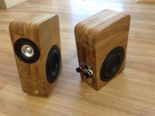

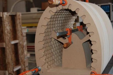

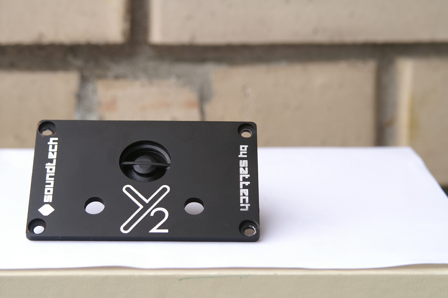

Since we have design studio and 2 CNC machine (for other purpose) I tried to do it something similar, but way is more than complicate since need to make holes on 3 different side s
No meter, if not counting our time, material, drivers, crossover and rest is almost 20 percent of price of W5SE
After I test it, sound is more than awesome
Here is couple pict from production process

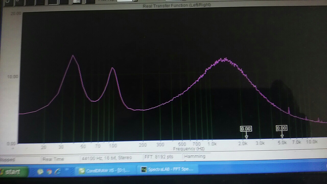

It would be nice to see some measurements, and xover scheme..After I test it, sound is more than awesome

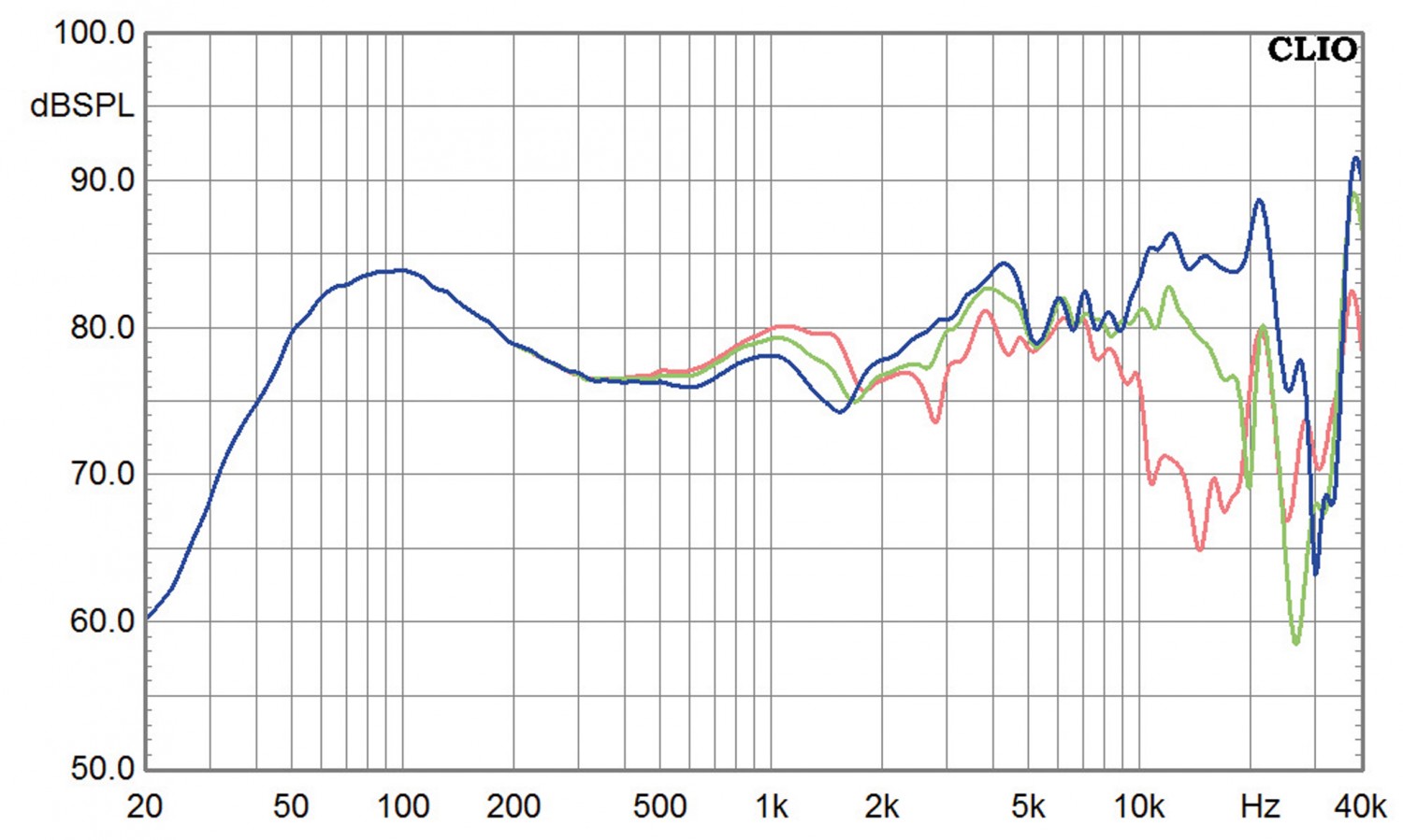

I saw measurements for original speaker which are disgusting..
I have a doubt about the hype of this nice looking little desktop-speaker. Overpriced at least it is...

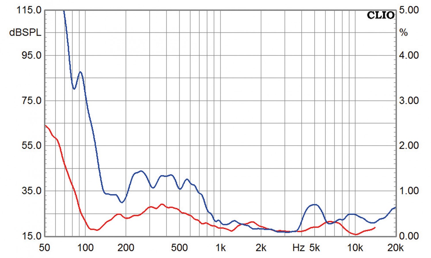

A test report of SE version https://i.nextmedia.com.au/Assets/boenicke_w5_se_loudspeakers_review_test.pdf

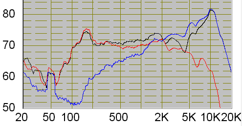

Ill attach scheme , pict and impedance dia ...

Frequency response would tell us more..Ill attach scheme , pict and impedance dia ...

entonis, did you make the blanks (the glued-together slabs of wood) yourself? Was the wood well aged? How have you sealed the wood from moisture?

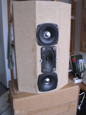

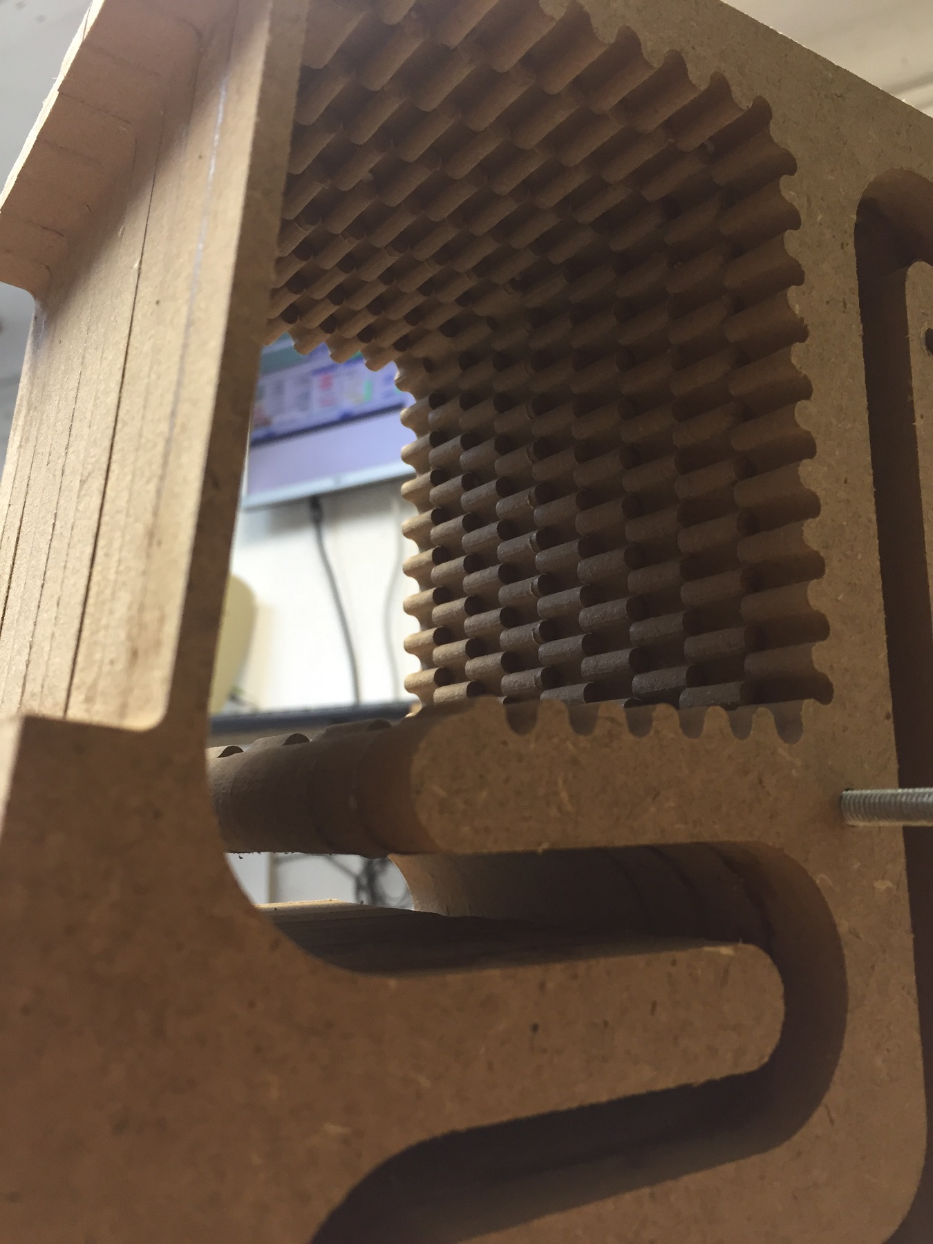

If you are making another pair, perhaps consider making it with non-smooth inner walls, like the attached picture.
I dont have this

vulejov please dont read this, this is just carpenters things !!!

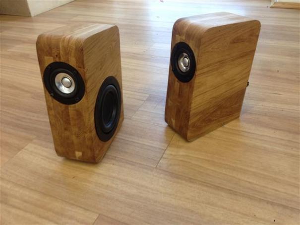

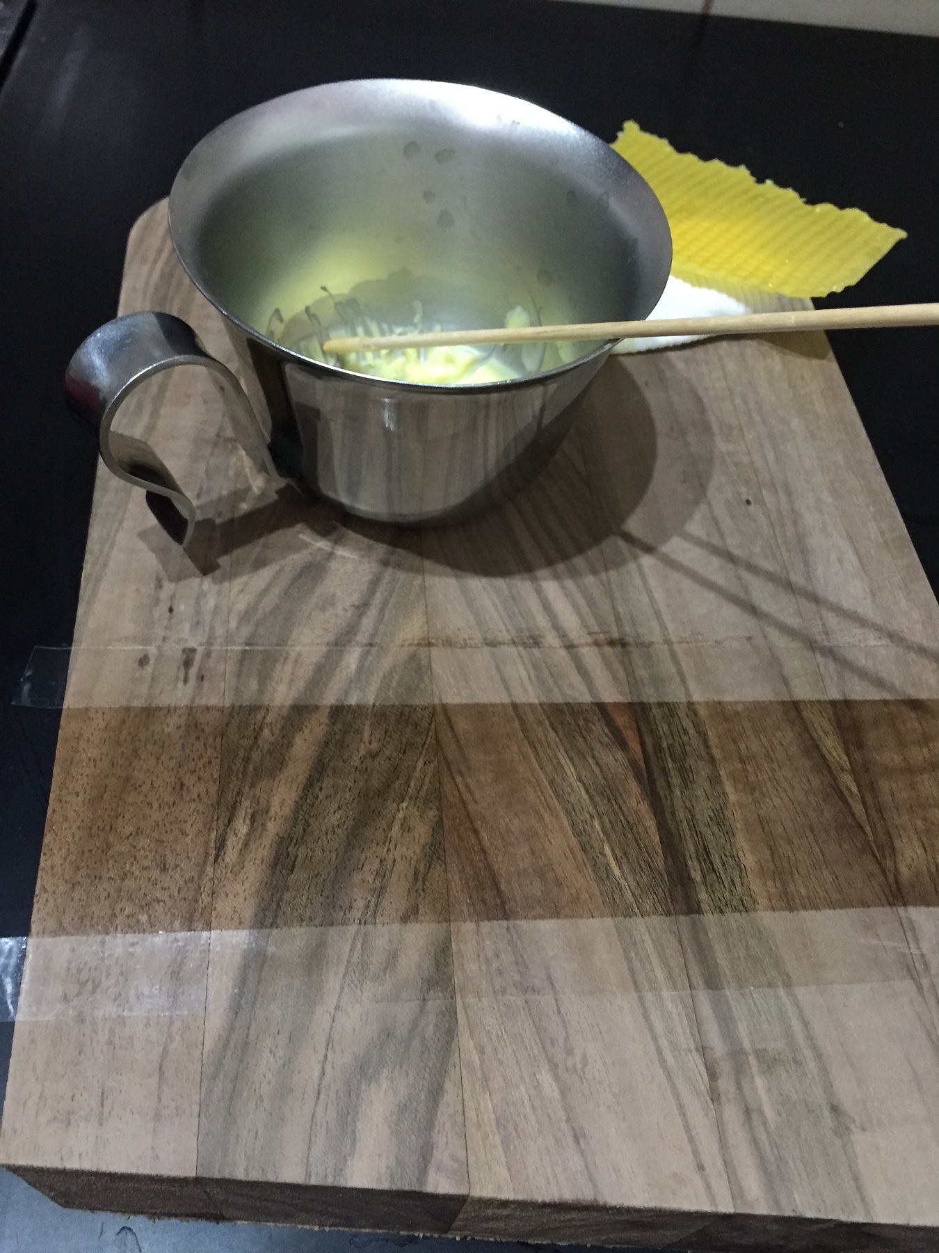

1) We order wooden blocks, I have a lot problem to find person to make me this, since lot woods board is cut on 1 or 2 inch thickness, and speaker need to be 52 mm after processing, so need min 60 mm thickness
Wood that we using is stay 3 yrs in mud, and after that thermal processing. U can see how looking sawdust, like for metal
After processing wood is coated with 3 layers wax/oil home made mixture (Bee wax, linen, teak and olive oil - industry oil, not standard for cooking) I have lucky since my wife is chemical
2) I dont like to make it from layers wood (this is lot faster job, just contour cut instead pocket drill, but I looking some German DIY project, and dont like how looking with layers-therefore we pay more than 3x to make thickness from just one layer - 52 mm (see pict 2-3 with layers)
3) we make some project - Transmission line but im not impressed with this, probably some mistake with calculation
But I think that can make with damping pattern layer

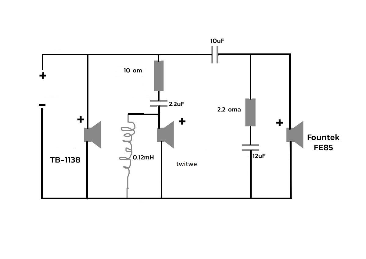

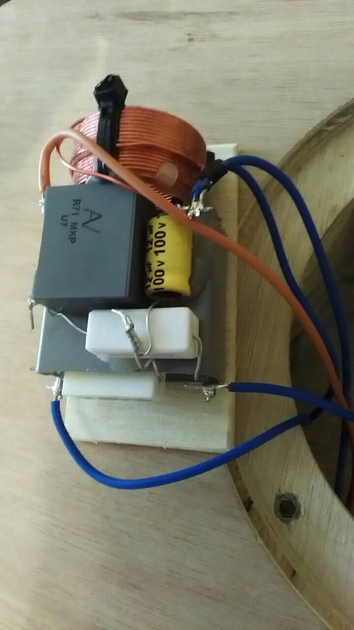

Hello entonis, I am very fond of the woodwork you have achieved. Can you explain the XO schematic? I guess the side firing unit is Tang Band W5-1138 and the front is Fountek FE 85. Where is the tweeter (twitve) unit coming from?
hello , see attached pict. hope all is clear now
Entonis, went through the trouble of analyzing a bit of the XO electrical design and if you ever feel like having a go at improving the sound quality, give it some thought of lowering the XO point between woofer and full ranger by introducing a 2nd order LP filter for the woofer and a 2nd order HP for the full ranger. 12 uF is causing impedance to take a dive at HF which is maybe unnecessary as a measure to pad its SPL down.
