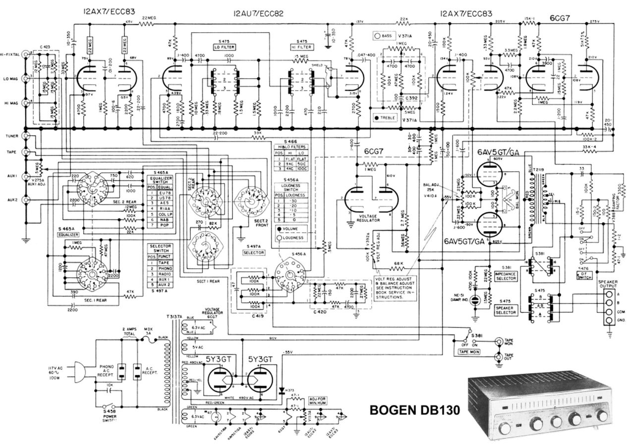

One big surprise was an untouched Bogen DB-130 Mono amp, the original Unnecessarily Complex tube amp. Apparently dates from circa 1955.
Uses 6AV5GA power tubes with a 6CG7 voltage regulator and final driver.
Plus the usual chorus line of 12AX7s and a 12AU7 for the phone stage.
WHAT TO DO? I am totally flummoxed by this one.

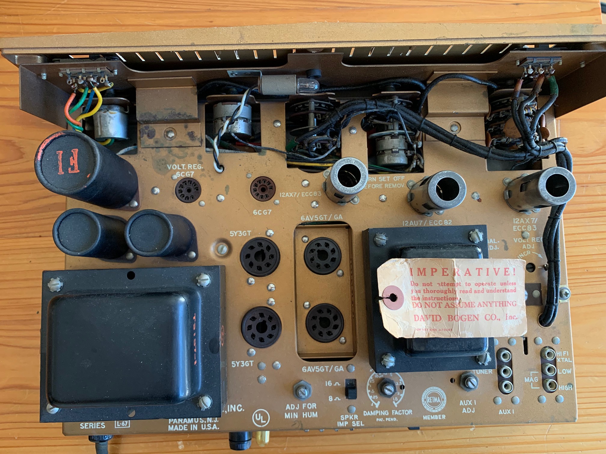

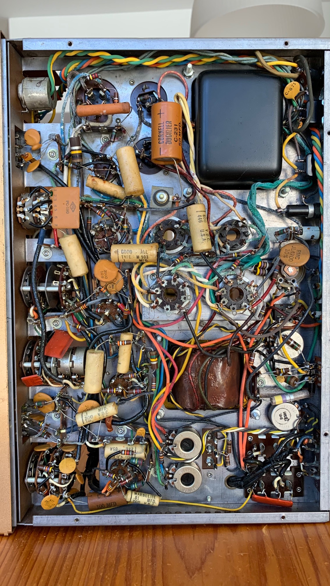

The build quality is spectacular, so it pains me to think about dissecting it, but I'm afraid it's merely an example of 1950's peak tube amp complexity, and doesn't promise to do any one thing very well (which is why they continue to be quite cheap; super clean working DB-230s (6V6s) are going for say $200 now.
PLUS, it is VERY crowded under there. I reckon that a full-on restoration would take a man-month.

Some options:
(a) Sell on eBay untouched.
(b) scrounge tubes (think I have them all), bring-up slowly on Variac & hope the power caps reform (ie don't spew), then reappraise. Then, for example:
(c) recap the power supply; just finished doing this on an old battered QUAD 303 closet find, worked great without any other alterations.
(d) rewire an input bypassing the phono stage and tone controls, use as power amp.
(e) re-use the iron and sockets for a screen drive 6AV5GA P-P amp. Haven't studied this option, but I'm guessing it could be done within the confines of the chassis.
(f) Sell on eBay as working amp...
PS have a pile of 6AV5GAs. Running them in the shop in a heavily modified TubeLab Simple SE at 23W dissipation.
PPS did just upgrade to a nice LCR, so I could take a sweep of the components to see if there are any clunkers...
All opinions appreciated.

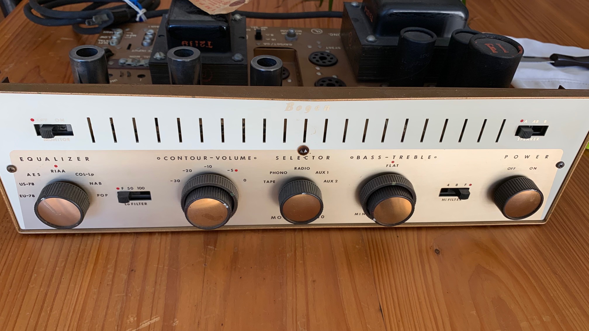

One more thing; looking at the front panel, I seem to remember that I bought this (cheap) with the idea that it could be restored and used to "transcribe" old vinyl (and shellac, for that matter) to digital.
Note the equalization options available. Don't see that stuff anymore.

On the Bogen I would definitely replace the power supply caps, and MEASURE all the smaller caps and resistors to replace only the ones out of spec...

All the 'lytics have long since dried out. Waxed paper signal caps. may or may not have started to leak. Soviet surplus K40 paper in oil (PIO) parts could be a reasonable replacement there.

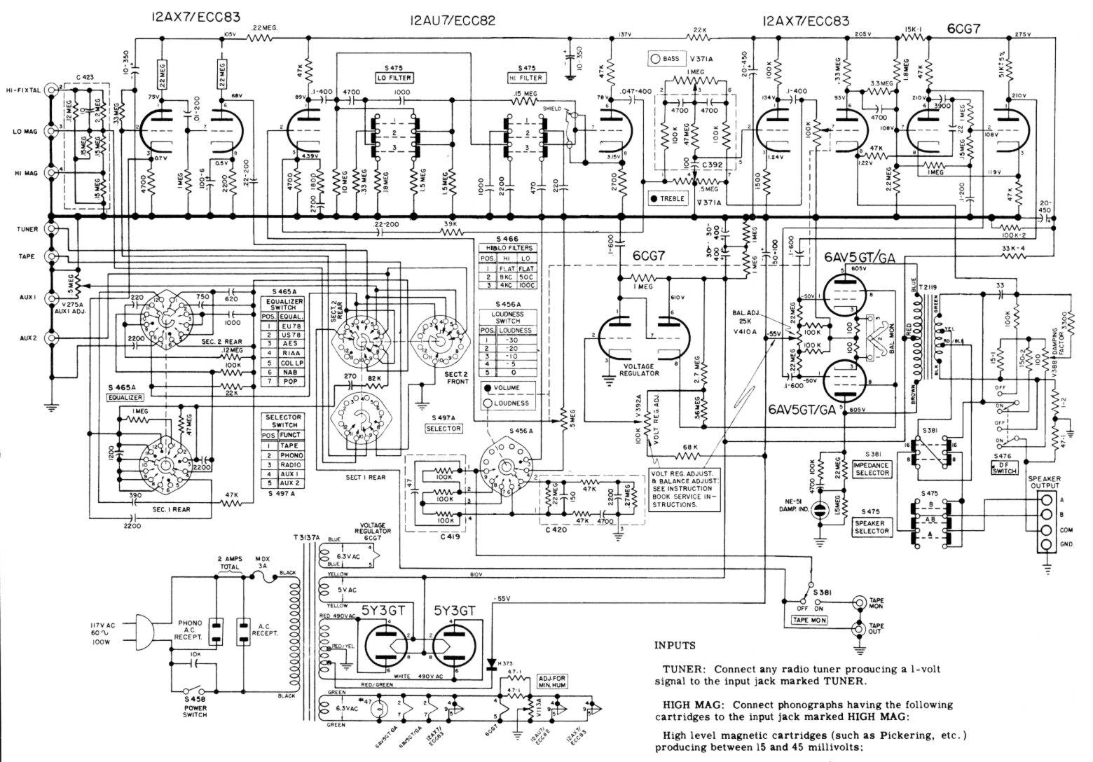

Quick question in schematic interpretation, since I don’t have a manual for this puppy:
Is diode H373 (adjacent to the 5Y3 rectifier tubes) a 55 volt Zener?
It’s in the right place for a Voltage reference, and has -55V marked above it. If it walks like a duck, and regulates like a duck...
It isn’t marked with the modern Z squiggle, but this schematic may predate that convention.
Can’t find an H373 zener anywhere, but that might just be a Bogen part number, or so obsolete it has disappeared from view...
Oh, crap, never mind. It’s just a normal diode taken off a 55 volt TAP on the transformer.
Hard-wired, half-rectified voltage reference, with the advantage that it’s proportional to the secondaries...
I got excited to see a Zener from 1955 that I forgot that there wasn’t such a thing.
Tragically, that means I am older than Zener diodes.
1955 you say. IIRC, Sarkes Tarzian introduced the M500 silicon diode later than that. As a youngster, I learned the hard way about peak surge limiting by wrecking 1 of those.
Perhaps H373 is a selenium rectifier of some sort.
