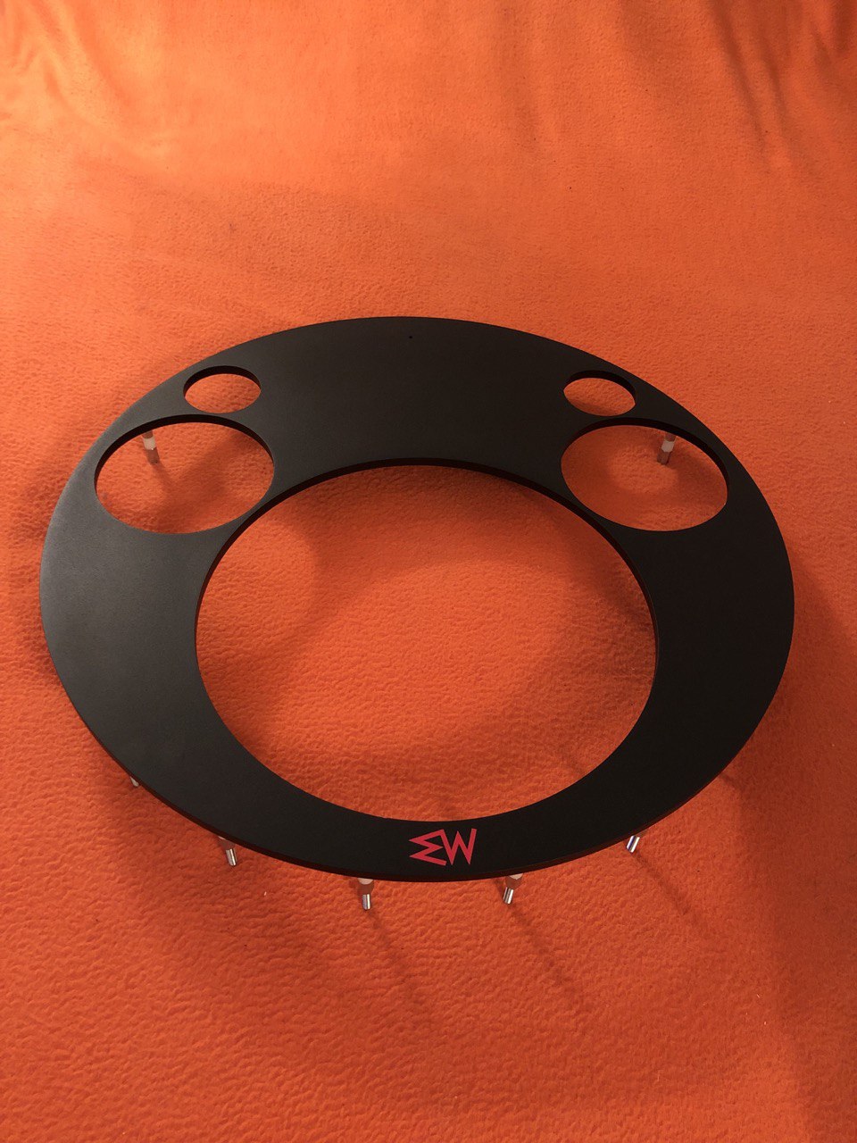

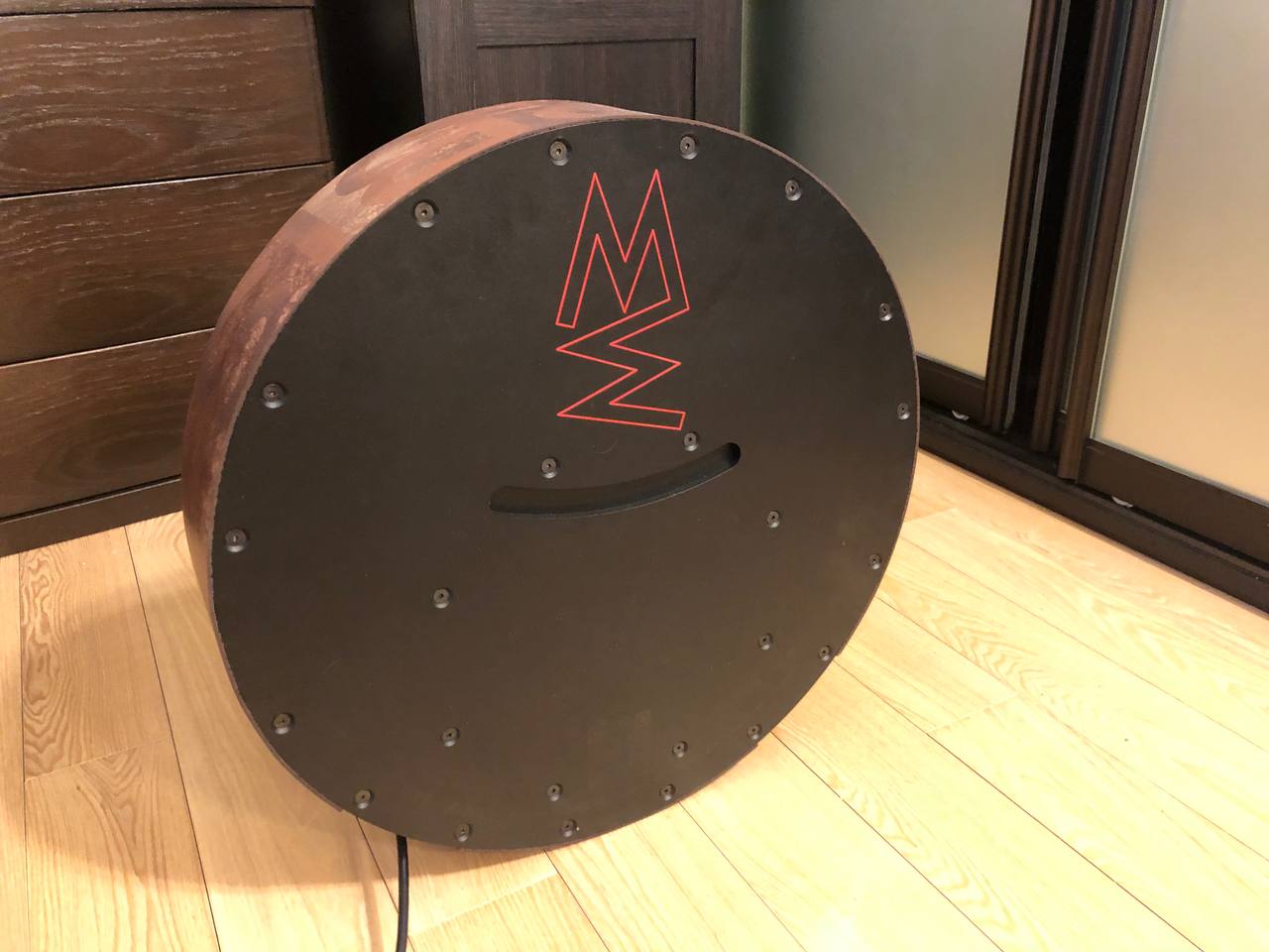

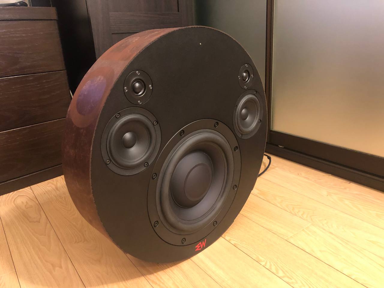

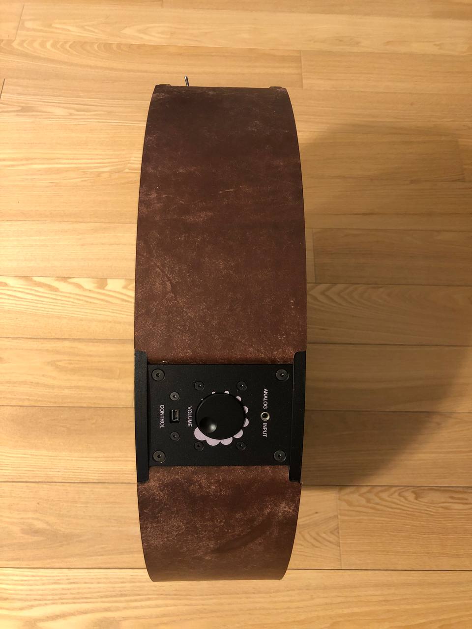

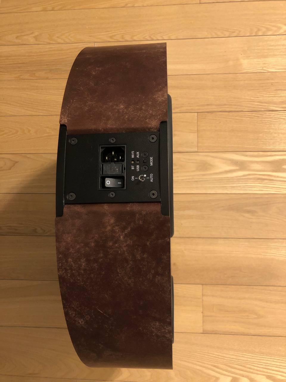

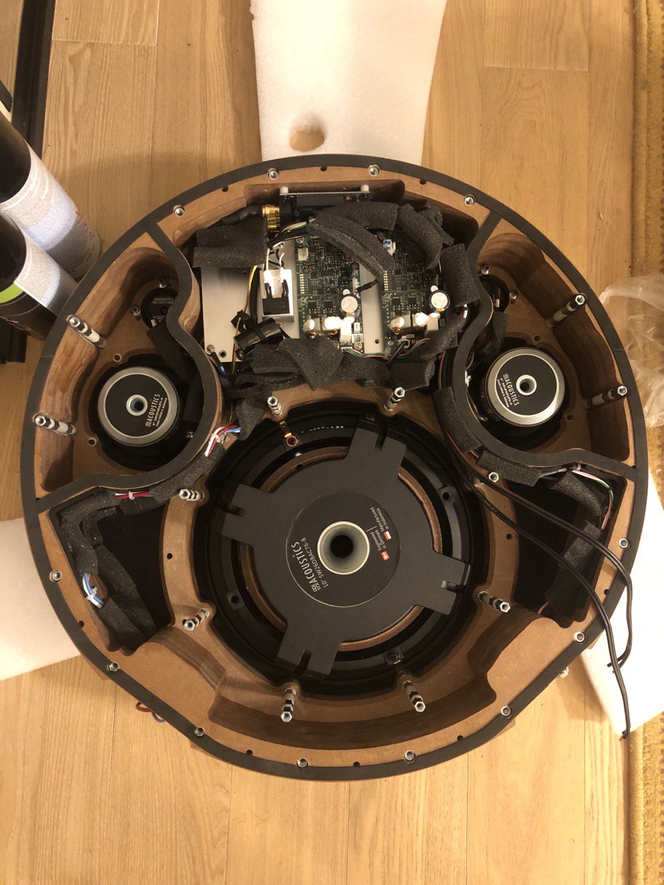

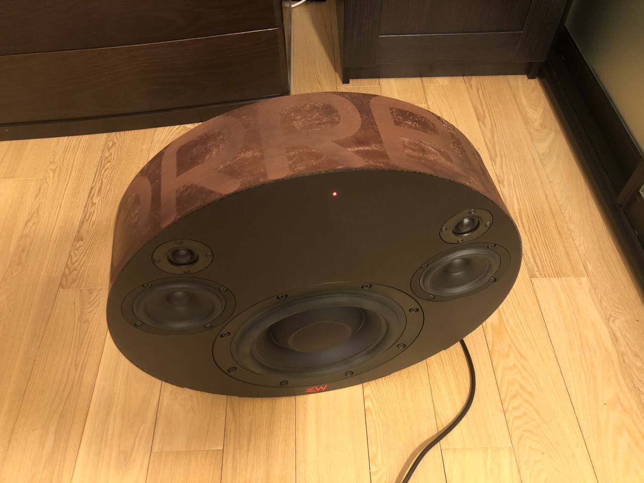

Hi guys,
How do you find my new build?
Inspired by B&O Beosound Edge.
Movitone Orrbis:
Arylic Up2stream pro v3
Arylic DAC board
miniDSP 2x4
Amplifier:
ICEpower 700AS1 + 200AC + 200AC (350W + 100W + 100W @ 8 Ohms)
Speaker drivers:
SW26DBAC76-8 (10” subwoofer)
SB12NRX25-4 (4” midwoofer)
SB21SDCN-C000-4 (20mm tweeter)
Case:
MDF with 8mm powder coated aluminum face and back plate.
Laser engraved leather surround.
Dimnension: d500 x 112mm
Going to upgrade to Arylic Up2Stream HD DAC and miniDSP 2x4 HD
Remodeled Case to fit Satory 5" midwoofer and Bliesma T25 tweeter.
