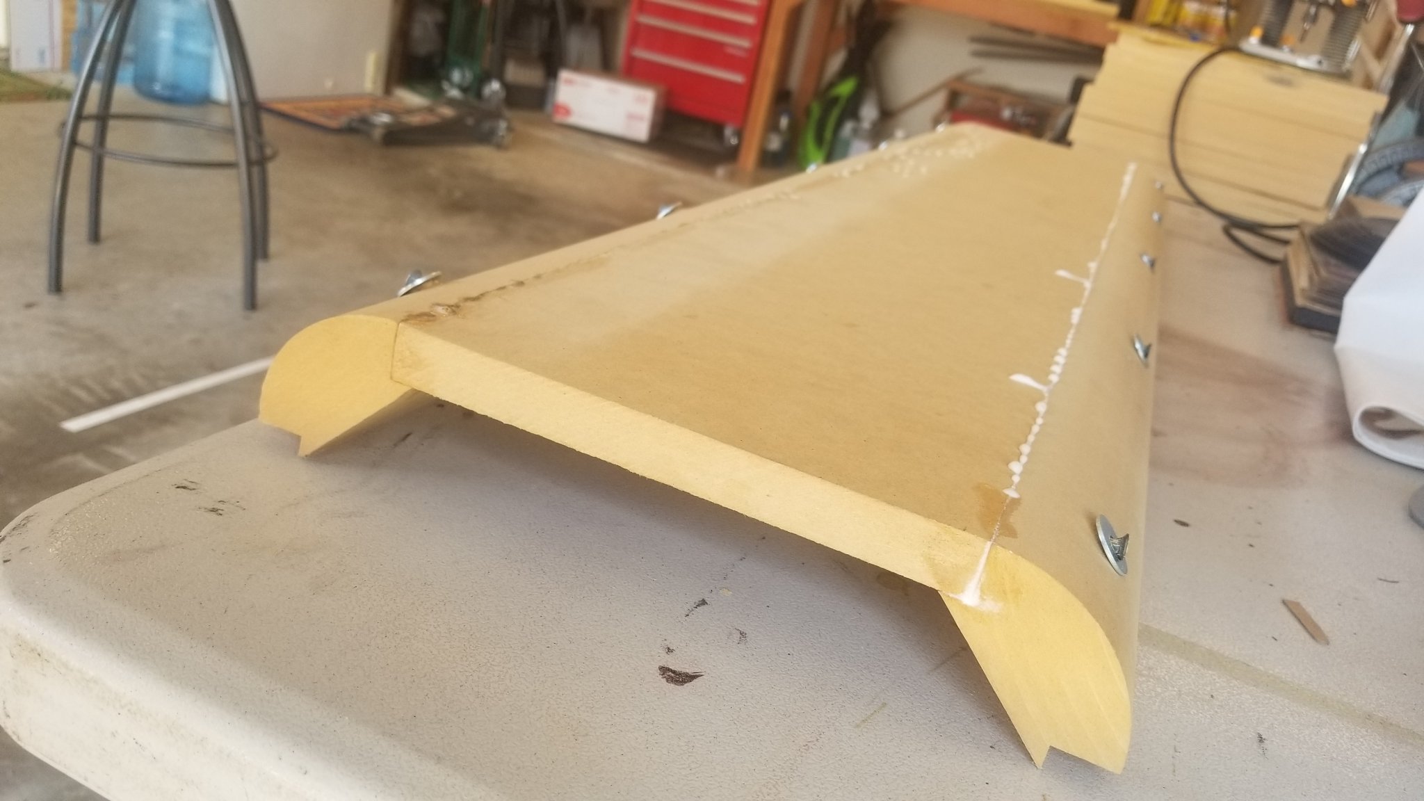

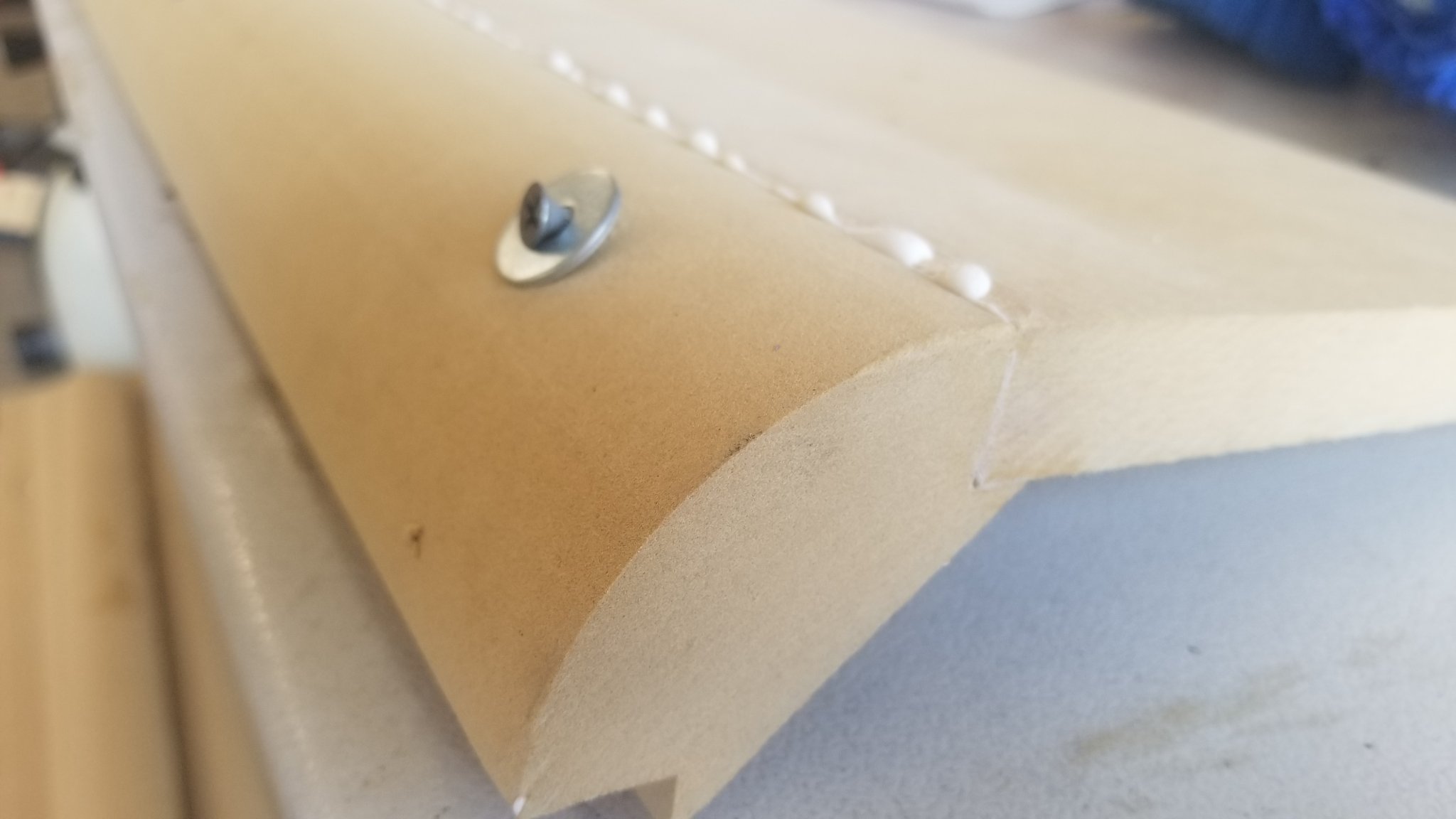

I started with cutting the front baffles and gluing the preformed radius edges on. My initial idea was to use a pneumatic stapler and tack the radiuses onto the baffle from the back side. This didn't work as there was not enough MDF present to hold them tightly. Instead I had to carefully predrill a number of holes in the radiuses and the baffle edges in order to use screws and washers to clamp them while the glue dried.
Complete front baffle with 2" radius edges attached. Screws will be removed and filled once glue sets.

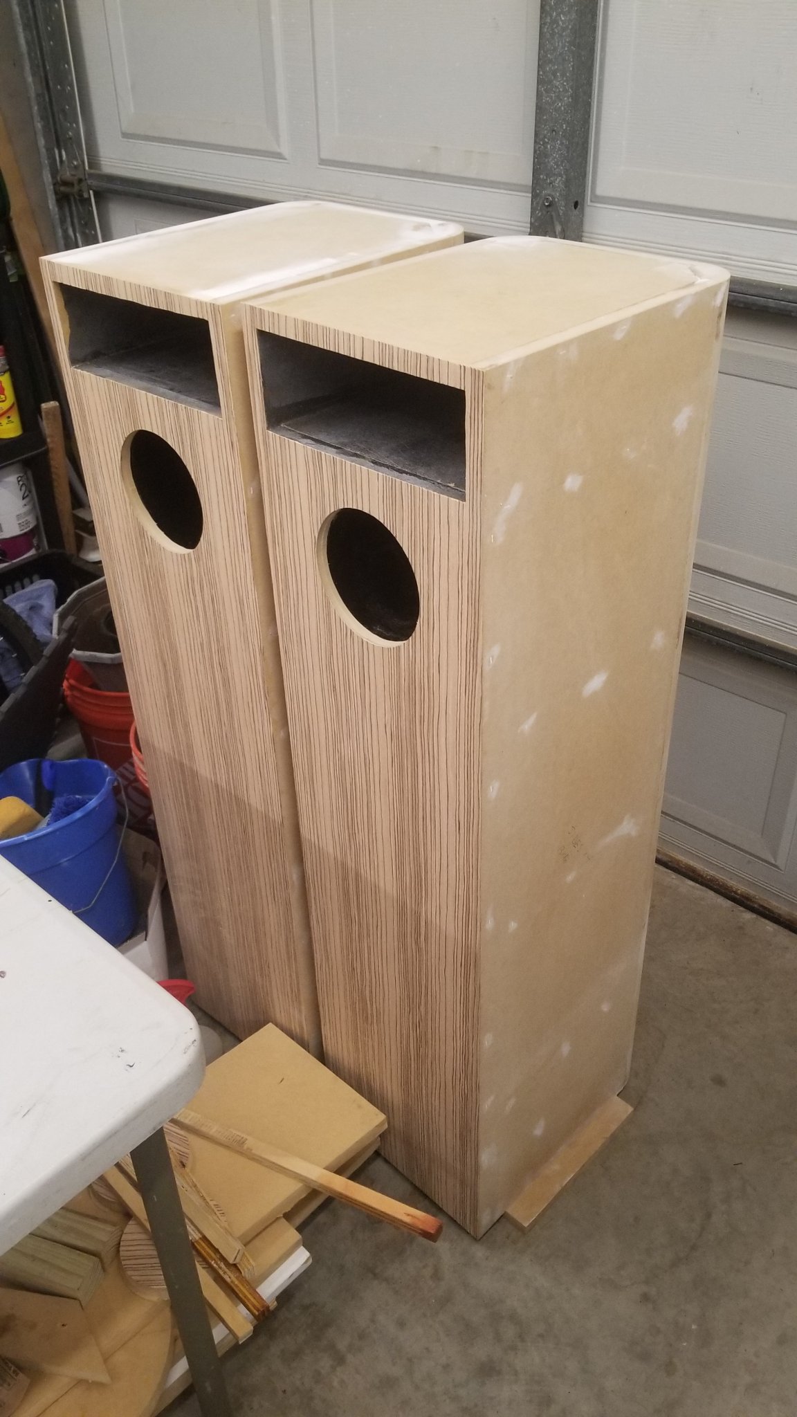

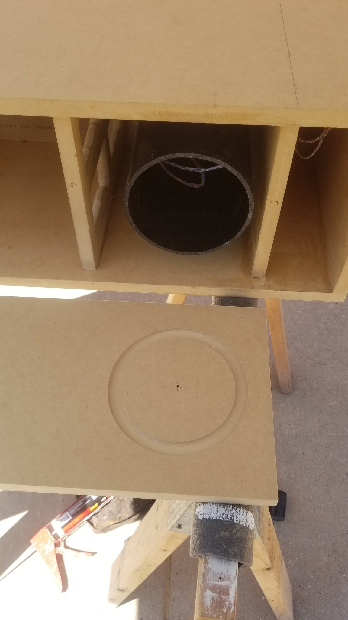

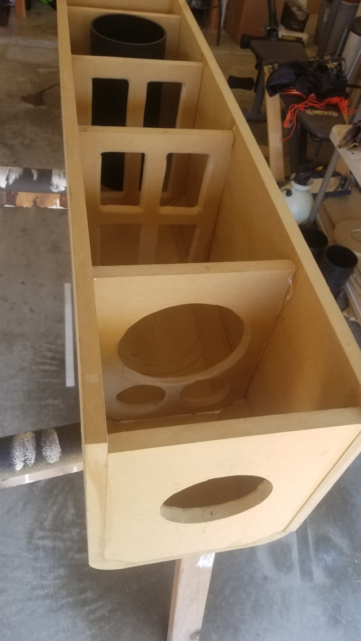

Now cabinet construction is pretty straightforward except that the backside of the baffle is no longer flat; all horizontal bracing will need to have truncated corners on the front side to fit the baffle. Here the sides are attached, all window braces are installed, the midrange tunnel is glued into a rabbet on the backside of the baffle and the bottom of the speaker shows the large opening required for the flared port.

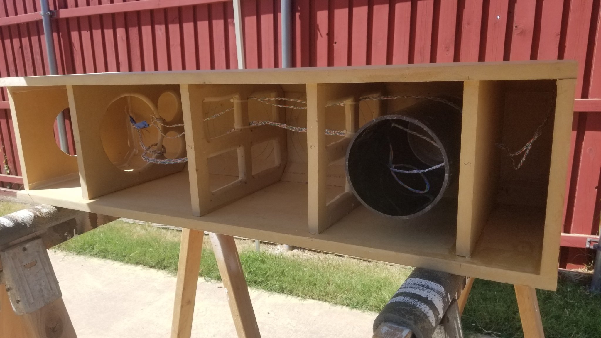

Another view showing completed cabinet except for back. It's important that the PVC pipe midrange tunnel by properly sealed to the front and back of the cabinet. I accomplished this by routing a groove behind the baffle into which I glued the tunnel with construction adhesive. To allow differences in precision the rear panel has a groove wider than need be to receive the tunnel. This groove was then filled with construction adhesive before attaching the back to accommodate any slight alignment errors. Braided Teflon cat5 wire for the midrange and tweeter is already installed here. Black PVC pipe is enclosure for open back midrange. Cavity at far right will remain open for open backed ribbon tweeter.
Back panel getting ready to go on. Groove for midrange tunnel would be filled with construction adhesive to allow for any misalignment of tunnel.

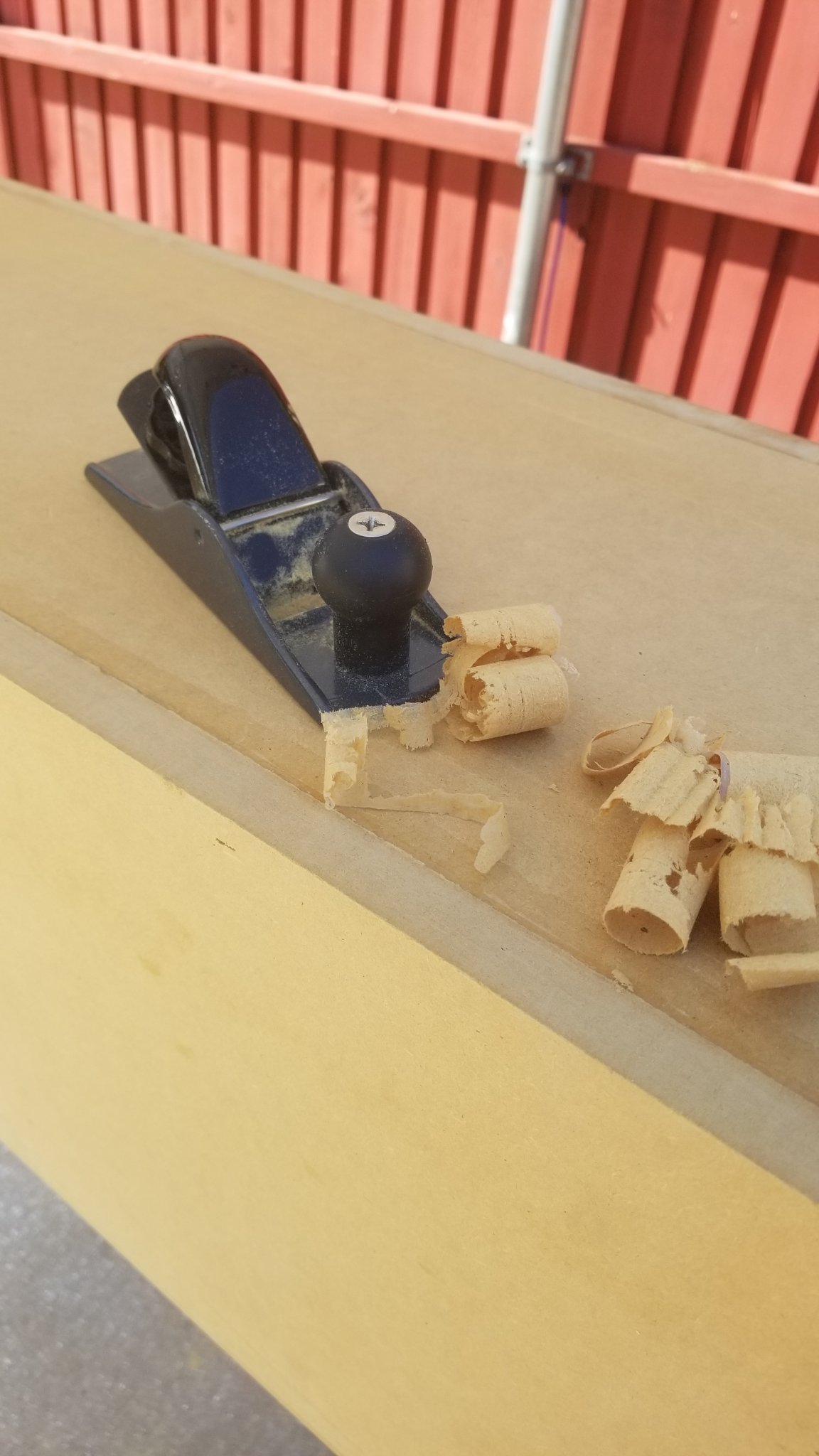

Back applied and planing edges to flush. Some will tell you that you can't plane MDF. I find it not to be true.

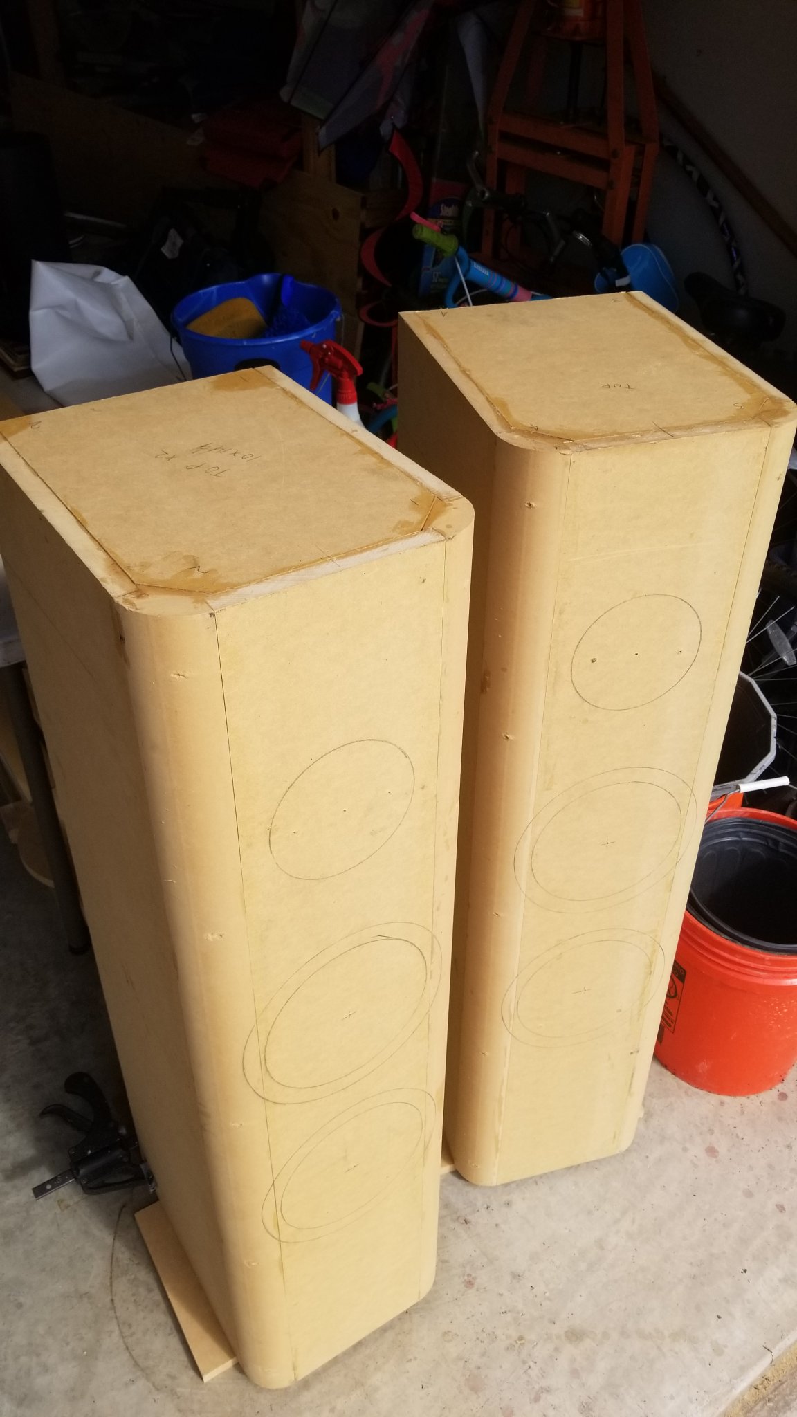

Raw MDF cabs with all sides complete. Driver rabbets and cutouts penciled onto baffle. Notice that rabbet for woofers extends slightly into the radius. I like this detail and was careful to measure and mock it up before building.

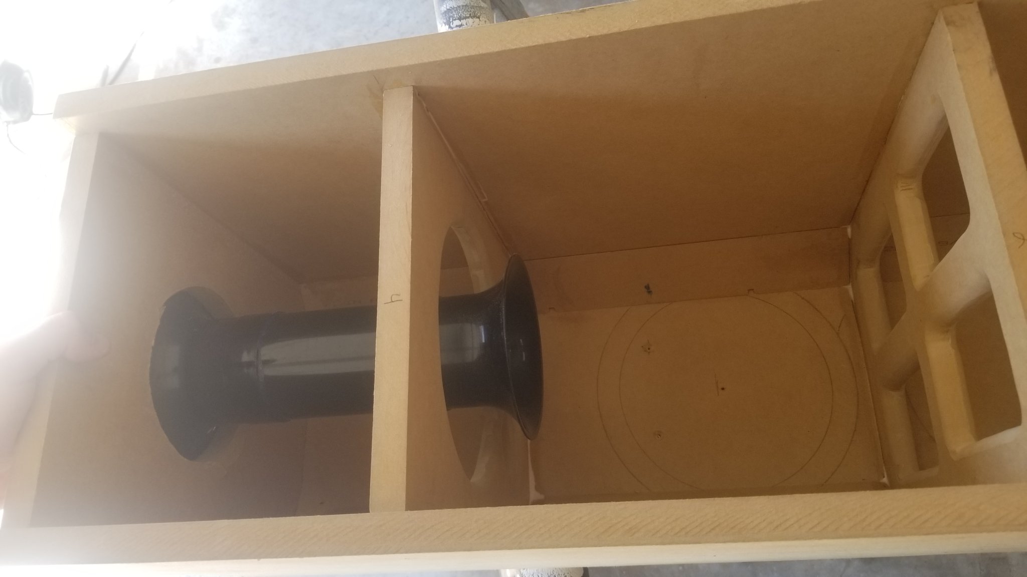

Bottom firing flared port installed. I was unsure of any interaction between the window brace and internal port opening so left what I figured was "plenty of room"

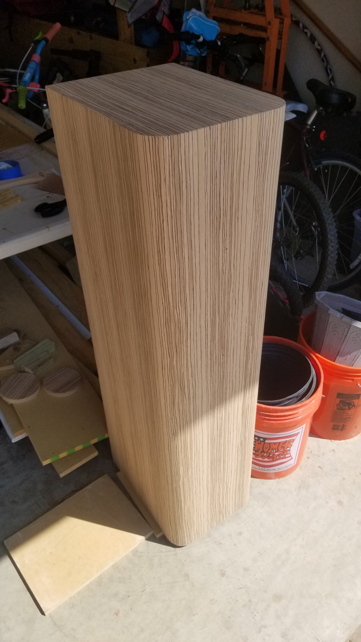

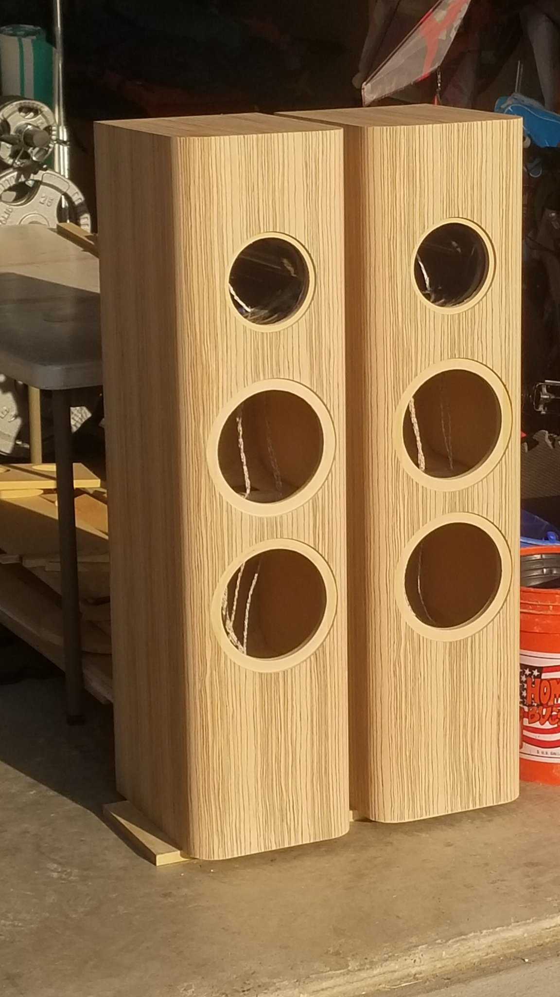

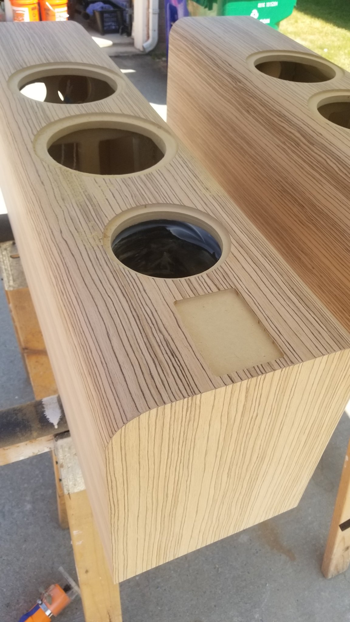

Paper backed reconstituted zebrawood veneer applied to back sides first. Open backed tweeter opening and open backed midrange tunnel opening shown.
Top and bottom of cabinet are then veneered before applying a single piece of veneer that wraps around both sides and baffle. Be careful to layout your veneer to match the grain.

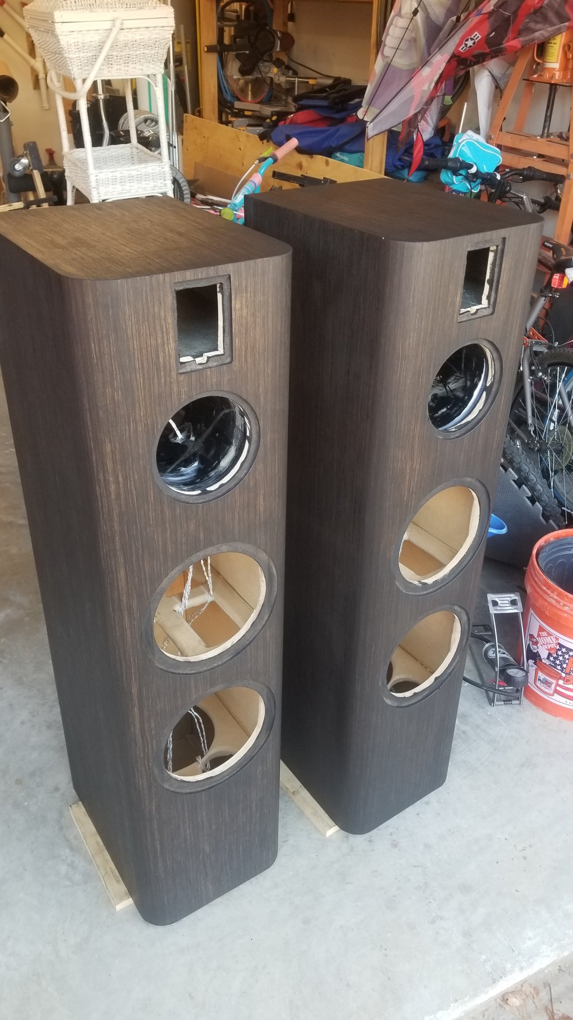

Woofer and midrange rabbets and through holes are routed.

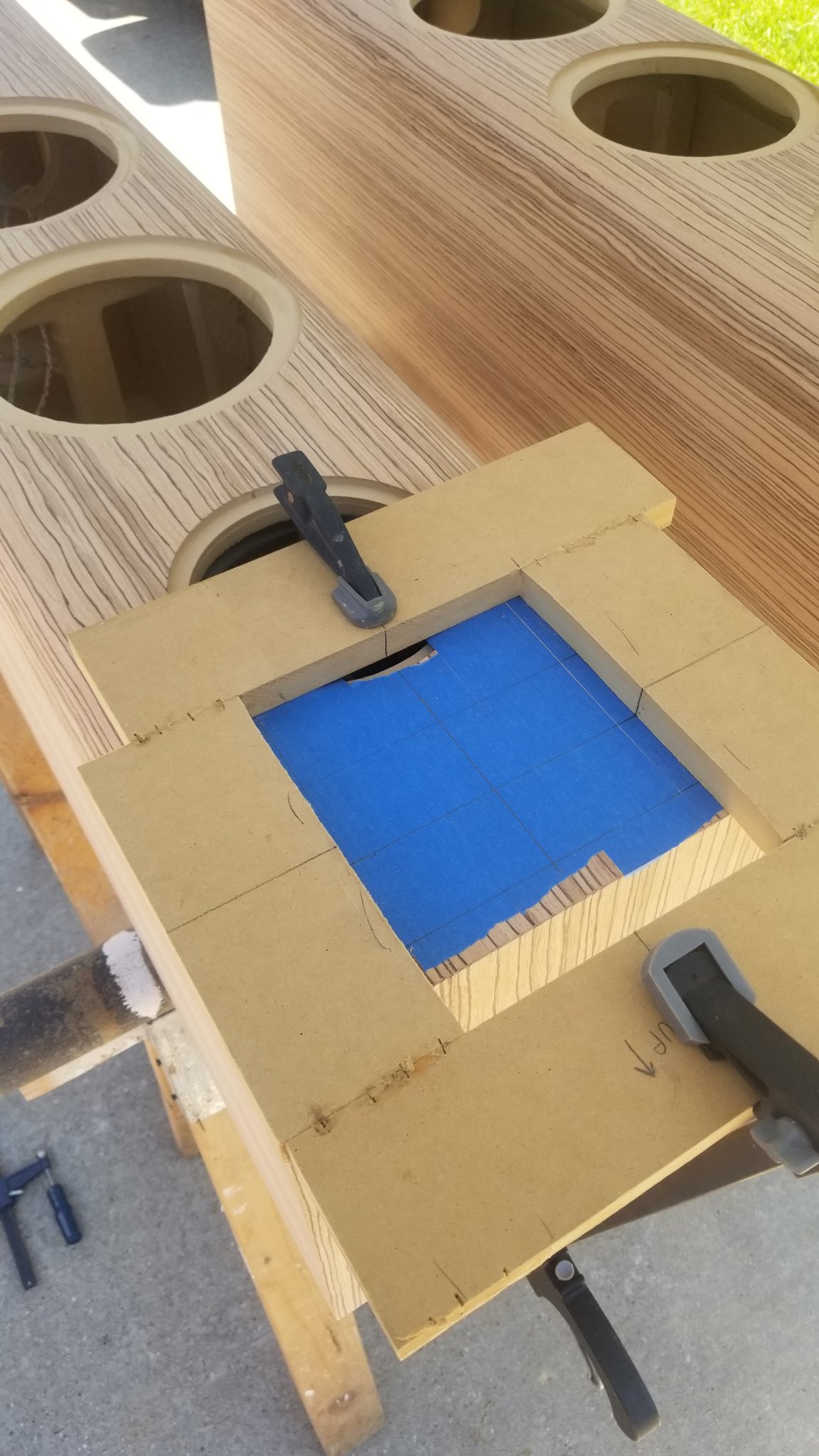

Router template is built and attached to cut rectangular rabbet for flush mount rectangular tweeter.
Tweeter rabbet complete. The through hole will be done with a jigsaw.

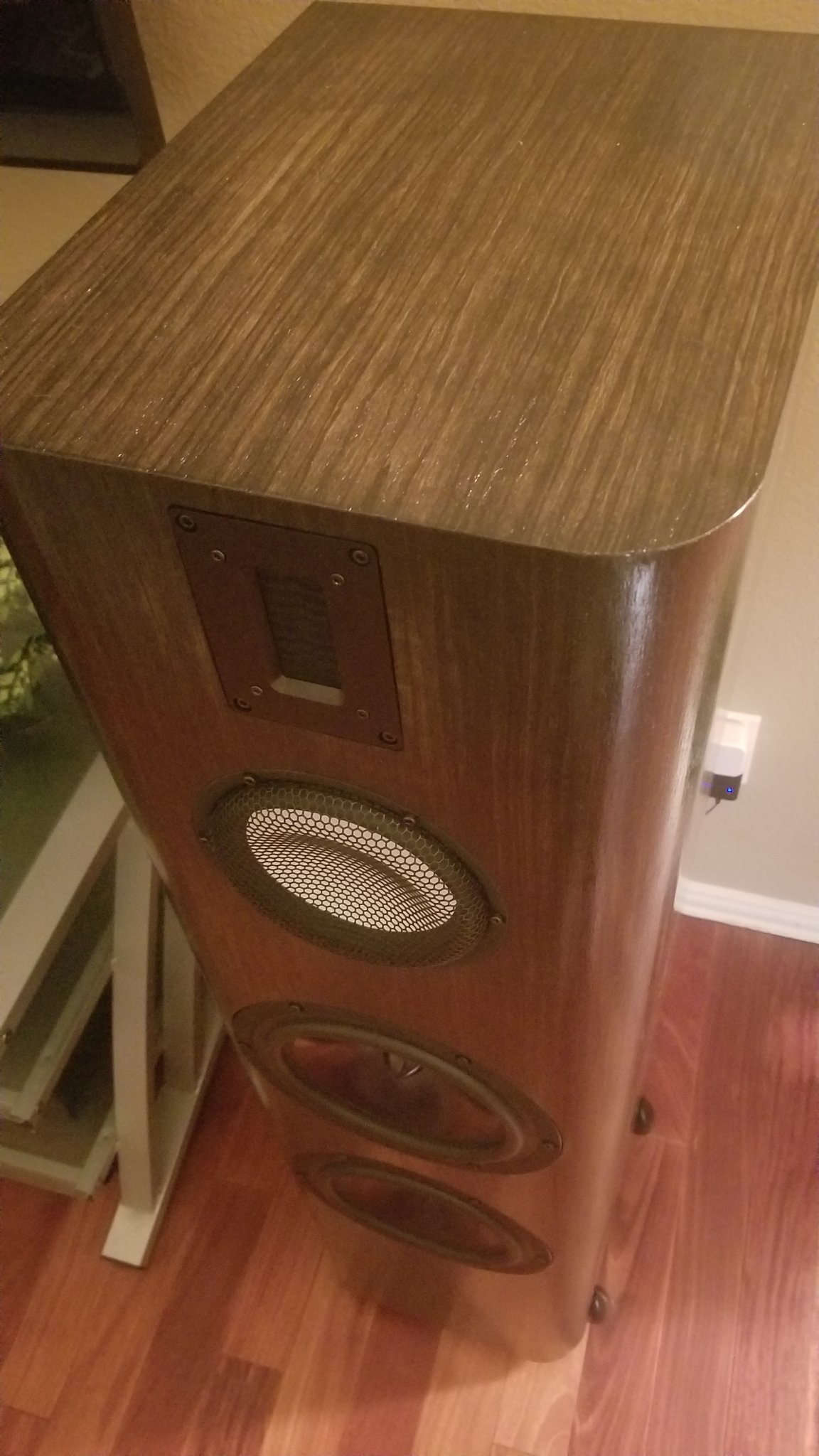

Stain on. This is "reconstituted" zebrawood paper backed veneer. That means it's fake and much cheaper than the real thing! I worked for weeks with different finishes as I really wanted something blonde or gold similar to the arch top speakers. In the end I settled on this color and find it suiting. It's more subdued but fitting IMO.
Poly applied. Though color and lighting is poor this pic shows curved edges to good effect.

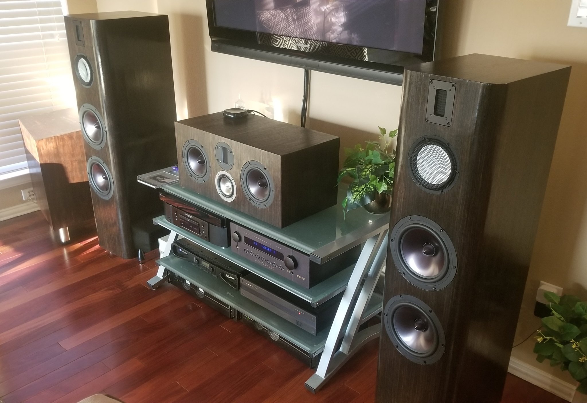

Bordeaux towers with Statements center channel and DIY sub in corner.
