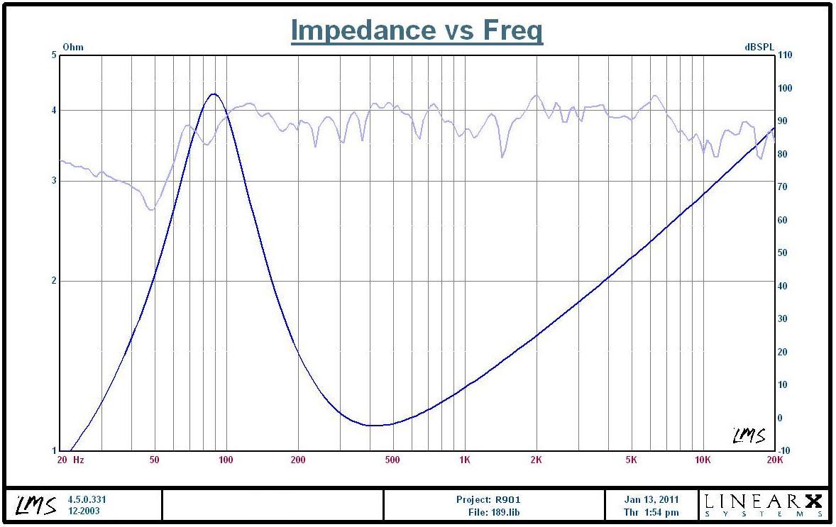

FWIW, a friend pointed me to the replacement bose drivers sold by PE here:
Replacement Speaker Driver for Bose 901 4-1/2" 1 Ohm
I pulled up the spec sheet to get the FR. And look at that...
