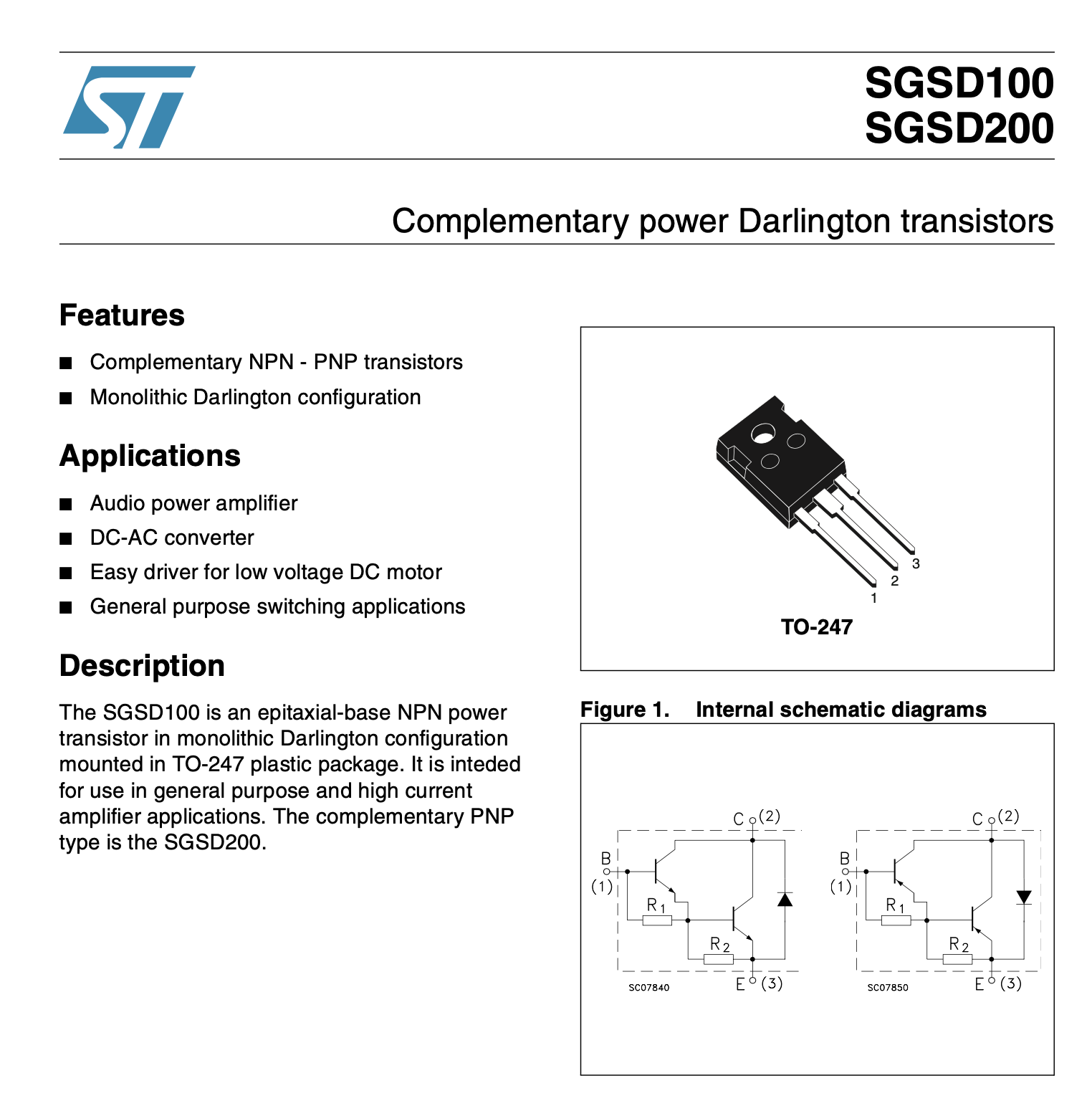

They are darlington pairs, NPN and PNP.
Unfortunately for you, obsolete. If they are for sale on fleabay or Aliexpress etc, probably fakes.

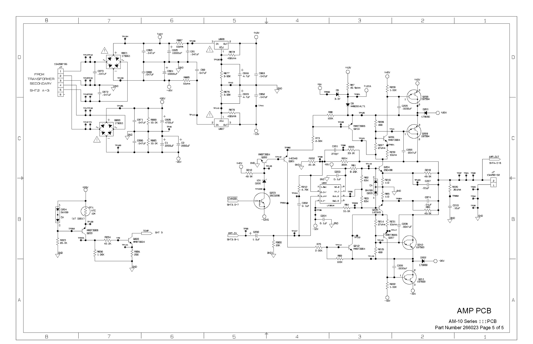

MJH6287 / 84 seem a proper match, stock at digikey. the board is a single channel classH amplifier with 20V and 40V rails. the diodes look like 100V 20A types, not sure whether schottky or normal diodes, measure the forward voltage of the good one. this schematic seems to fit the board in the picture.

Best bet today are OnSemi MJH6284/6287. Gain is somewhat lower, but they will probably work. These things don’t put out crazy wattage. The preferred types, Sanken 2SD2083 and it’s PNP are also unfortunately gone gone gone.

The diodes in question should be schottky. A fast diode is required, and on such low rail one cannot afford the high drop of a typical epitaxial ultrafast and schottky leakage isn’t an issue if 60 or 100V parts are used.

2 or 3 pin TO-220’s can be used, or even TO-247. 2 pin TO-220’s would be the best fit for the PCB. It has only got to block 20-ish volts, but if the speaker is 2 ohms it would have to deal with 10A peaks without it’s Vf going too high (and therefore running hot). Your basic 60V 15 amp part would be fine, and there should be a dozen to choose from.
the diode does not see more than 60V, but this looks after further inspection as a bit unusual classH with each half switching, so indeed only 20V.
a dual to220 diode can be used in paralell to lower the forward voltage like the MBR220CT

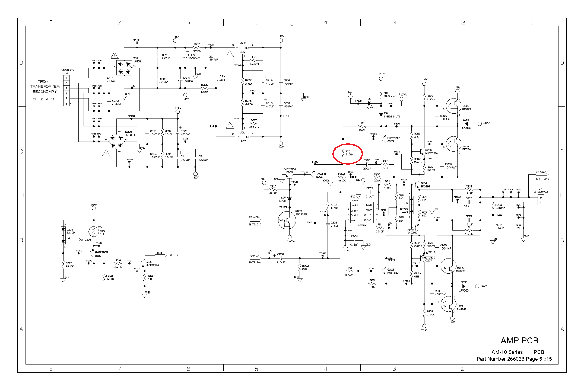

Thanks for everyone's help so far! So I just discovered that small SMD resistor below the "O" in "BOSE" may also be blown. It's testing ~50 ohms, but I'm guessing there's almost no way to verify what it should be without the schematic?
A poster put a similar Acoustimass 10 III schematic above (also attached), but upon further tracing it's not 100% the same. I believe it may be R73, based on my tracing starting from Q209...but I can't verify for sure? The components downstream of R73 don't seem to follow that schematic 100%, so I'm not sure if I should just throw in a 2.00K resistor and hope for the best.

Is the driver working? Check its continuity...blown transistors may have damaged the driver. That can complicate matters.
