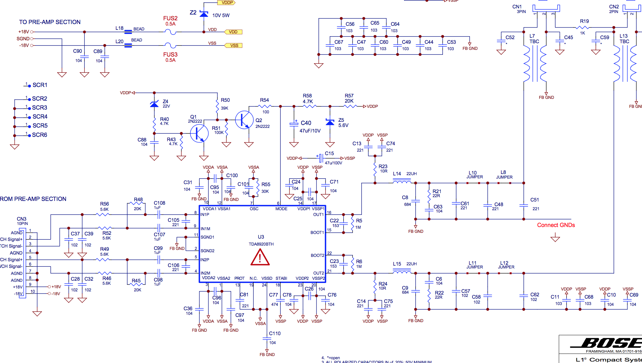

I've recently got a Bose L1 compact sound system in for repair. The unit failed to power up one fine day.
After opening the unit up the first thing I noticed was the TOP258 IC was cracked open. Before replacing the IC I had a look for any other components which might have failed. I checked for the obvious culprits and I couldn't find anything which has failed. I checked the diodes and resistors around the IC, checked the main filter caps and the electrolytics near the IC. Checked the secondary side for any shorts or failed caps and nothing. I checked the capacitors with the ESR meter, I removed some capacitors and checked them with my multimeter for the capacitance value as well.
So after much contemplation, I decided to change the IC only but the thing was I couldn't get hold of any TOP258 ICs. So I placed order for those. However I had TOP256 IC in my parts bin. It can handle low power than the 258 and to see if anything else failed I replaced it with it (until I got the 258). Powered it up and it was working. Obviously I didn't run it at full volume or had it on for long.
After week of intermittently testing again the unit stopped powering up. Opened it up the SMPS IC was cracked open. Same story as before nothing else seems to have failed. I now have got the TOP258 IC but am afraid the same thing would happen unless I could find the culprit.
I have checked the speakers thinking they might have partly shorted and might have been drawing too much current. They also test out ok. The amplifier IC is TDA8920B. On the datasheet the amp chip and the TOP258 seems to have all the protection in the world and seems to be bullet proof.
I was hoping someone could shed some light on how to proceed and what else to look for.
I have attached a pdf of the power supply schematic.
For a while I was pretty sure that the TVS diode (DZ1) might have failed as that would put high voltage on the drain pin, but it shows forward voltage of 0.6 and doesn't show anything in the reverse direction. I'm not sure how I can check it for proper 'TVS' operation.
The full schematic can be found BOSE L1 COMPACT SYSTEM SERVICE MANUAL Service Manual download, schematics, eeprom, repair info for electronics experts
Thanks in advance.
P.S: I have got another unit which came in for repairs and the capacitor and the resistor of the LPF was burned up and bulged on that one. The SMPS IC was cracked open on that one as well. I also checked those components on the unit I'm currently working on and they test out ok.

Which LPF RC was burned up and bulged? If the IC is cracked that suggests some pretty serious overload condition. So the mosfet could be staying on too long which might suggest a feedback loop problem. Another possibility is HV spikes are damaging the IC so then you'd check all the snubber components. But to check all these parts is not easy because to test them properly, they'd need to be tested at HV. Even then, I've seen HV parts work fine until they get to a certain temperature and then they fail.
The LPF I mentioned was the high output of the TDA8920B chip.Which LPF RC was burned up and bulged? If the IC is cracked that suggests some pretty serious overload condition. So the mosfet could be staying on too long which might suggest a feedback loop problem. Another possibility is HV spikes are damaging the IC so then you'd check all the snubber components. But to check all these parts is not easy because to test them properly, they'd need to be tested at HV. Even then, I've seen HV parts work fine until they get to a certain temperature and then they fail.
I also do have a feeling that it could be the snubber elements on the HV side. I have checked all the resistors and the capacitors on that side and seems to be good. Only questionable part is the TVS diode as I can't check it on a component test either.
Could you also please advice on what kind of problem in the feedback loop could cause the issue.
Correct way to repair of such power supply is to check (change) feedback parts, Optocoupler U2 and reference voltage U4 (TL432).
Also I recommend checking of all zener diodes.

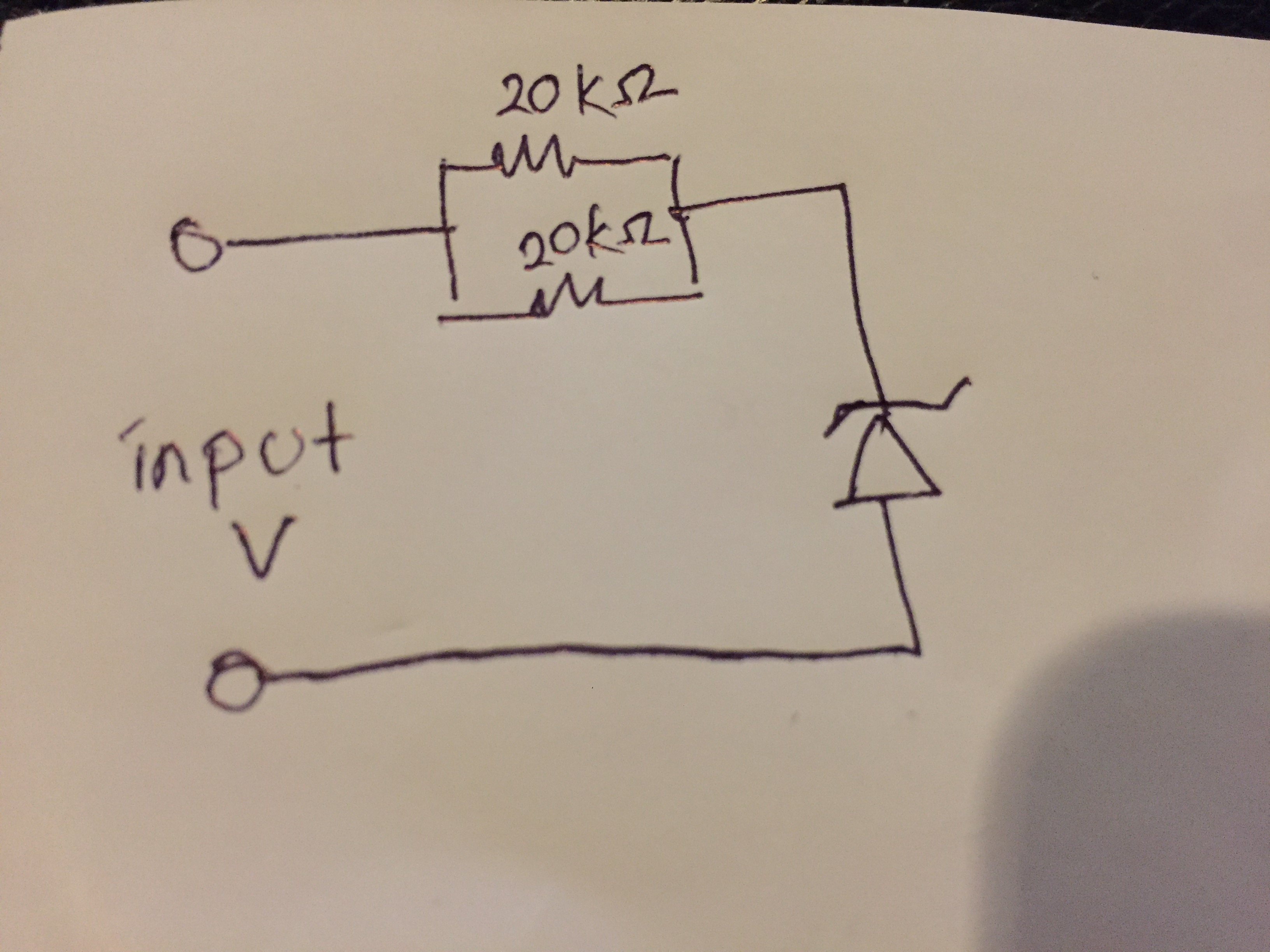

Update on the test for the TVS diode:
My test setup was isolation transformer -- variac -- rectifier --test circuit.
Important note - there were no smoothing capacitors connected across the rectifier output so the DC was not smoothed.
I had two 20k resistors in parallel connected to the TVS diode.
TVS diode specs according to the datasheet
Reverse Stand off Voltage (VR): 128.00V
Breakdown Voltage VBR @1mA: Min 143.00V , Max 158.00V.
Here are the results:
When I set the input voltage to 154V = I measure around 120V across the diode.
When I set the input voltage to 250V = I measure around 130V across the diode.
What would your thoughts be on the results?

Hmmm ... are you shure that the problem is the SMPS ? and not the load ... ?
It reminds me on a TV set which took the PS down occasionally and in the end it was the TDA.... amplifier chip which developed an internal dead short depending on temperature, mechanical stress a.s.o. Bond wire shorting to lead frame, something like that.
To fully protect a off-the-line SMPS against a dead short on the output is not trivial and you simply don't know whether the Bose design is fool prove.
Instead of replacing parts with no obvious signs of defect at random I would fit a pair of rather low rated fuses somewhere between SMPS and amp, near the connector maybe.
There are fuses towards the small signal stages but not towards the power amp, if I see that correctly. Not that a fuse will protect the PS but ...:
If the fuse blows, you know it was the amp.
If the SMPS blows and fuses stay intact you know it was the PS.

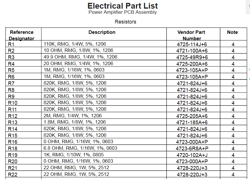

Got stuck on a problem. The service manual says "*ALLRESISTORSINOHMS,5%1/10W(0603)."
I searched for those on mouser and the one which I found which matches the specs had a voltage rating of 75V. For instance the R1 (110k) which is the clamping circuit for the mosfet - wouldn't it exceed the rated voltage?
Its my understanding the typical voltage rating for 0603 size resistors are in the 75V range.

You are correct wit your thoughts, at connections of this resistor it is possible to have about 150V which are clamped by DZ1, P6KE.
So correct answer is for the resistor 0603 is safe up to 75V, 0805 up to 150V, and 1206 up to 200V. Beware that for AC, you must check it against the peak voltage, not RMS value.
Maybe you should try some lover value connected in series (62kohms), on that way you will have about 150V rating.

Hmmm ...
In my service manual all resistors are specified individually and no mentioning of them being all the same...
e.g. R1, 110K, RMG, 1/4W, 5%, 1206
or even
R21, 22 OHM, RMG, 1W, 5%, 2512
Power Amplifier Pcb Assembly - Bose L1 Compact Service Manual [Page 31] | ManualsLib
BOSE L1 COMPACT SERVICE MANUAL Pdf Download | ManualsLib
"*ALLRESISTORSINOHMS,5%1/10W(0603)." - is written on the bottom of the schematic diagram.
You're right the service manual with the parts list is different. Will double check the size again.

Turns out the resistors I needed were actually 1206 as mentioned in the parts list. I'm still waiting for the parts including the TOP258.
