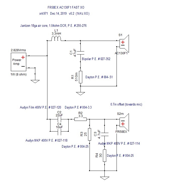

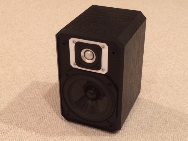

I repurposed an HD5 cabinet for a small bookshelf with a 2.5in aluminum cone full range as mid tweet and nice AC130F1 5.25in woofer. I’m sure the HD7 can be used with a 6.5in woofer in similar fashion.
They are the main speakers in my daughter’s room - she loves them.
https://www.diyaudio.com/community/threads/fr58ex-and-ac130f1-micro-fast-waw.280331/
