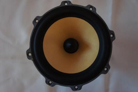

Hi everyone,
I've done a small four part review of the Bowers & Wilkins 685 stand-mount loudspeaker. It contains a lot of loudspeaker and driver measurements and some Mod suggestions on how to improve the sound quality of this loudspeaker.

Hi Göran!
A very nice review and also very useful as a proposal of a modification. I'm impressed by the product quality which is solid and of pretty good performance considering such a simple XO filter.
Well done.
I miss the days of the old reviews that showed the internals.
Me too! That's why I once in a while do a review for fun and where I can see that improvements can be done to the design.
