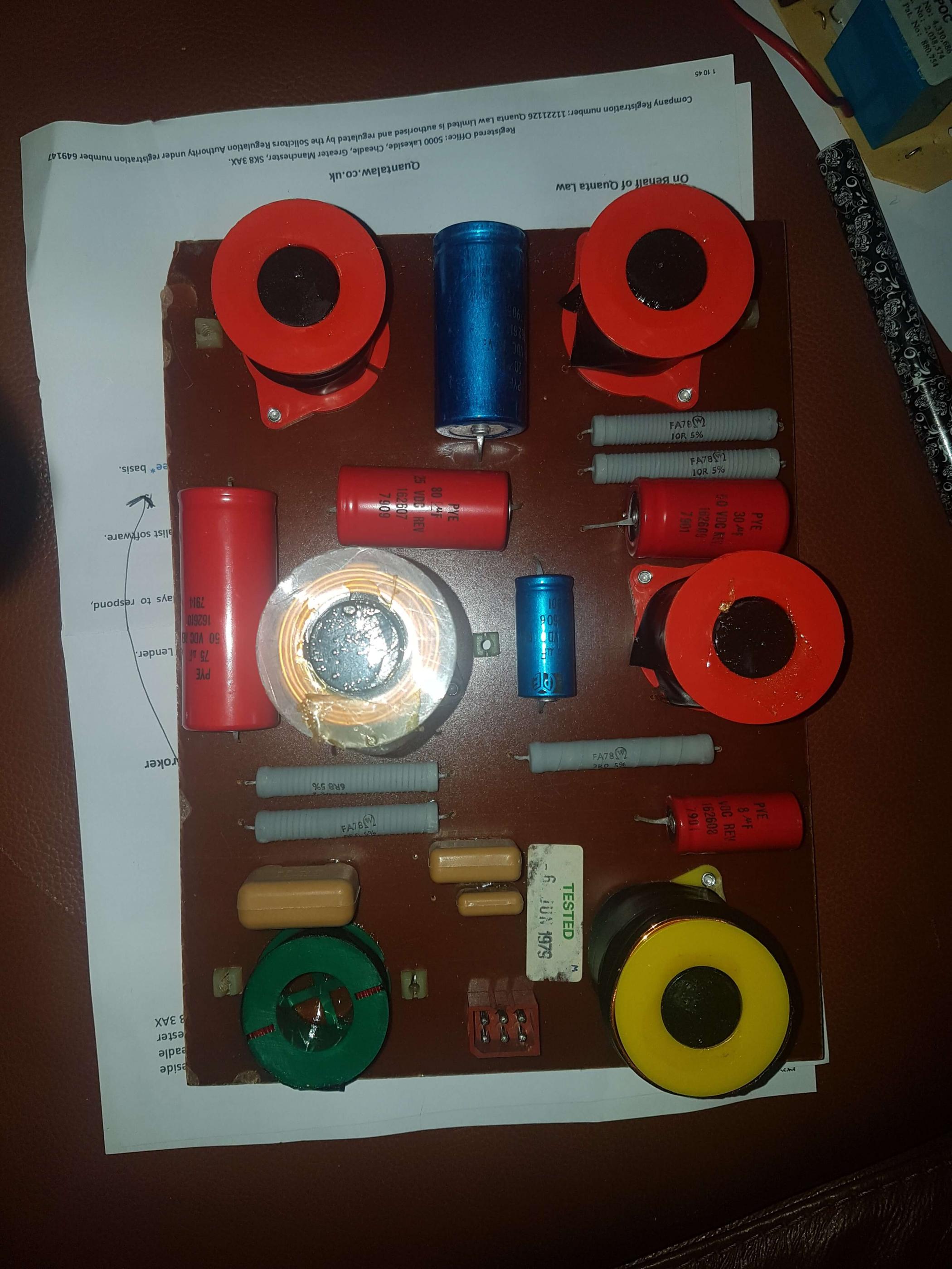

I'm in the process of renovating some newly aquired B&W DM2, Series 2's and I'm finding getting matching electrical components a real pain in the backside.
Now please consider I'm almost a total newby in the world of audio electronics and have only a basic knowledge at best (we all have to start somewhere eh) so i'll probably end up asking some dumb/obvious questions...bare with me. 😉
Firstly I'm lead to believe that installing a higher voltage capacitor onto a crossover isn't a problem...but how high is it realistic to go? Could iI replace a 25vdc Cap with say a 250vdc cap? This is just a rhetorical question .
The same question regards Capacitance....could i replace say 75uf cap with an 80 or 90uf cap? I understand there will be tonal differences replacing caps with differing Capacitance ratings, so with that in mind i am wanting to keep the sound as close to original spec as possible and to achieve this how much would i be able to adjust the Capacitance rating by? Please stay with me on this.

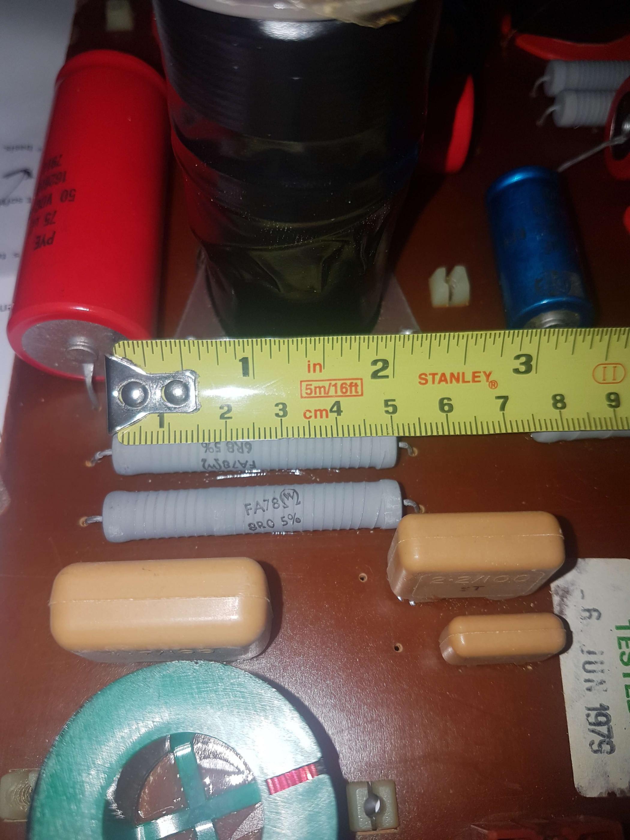

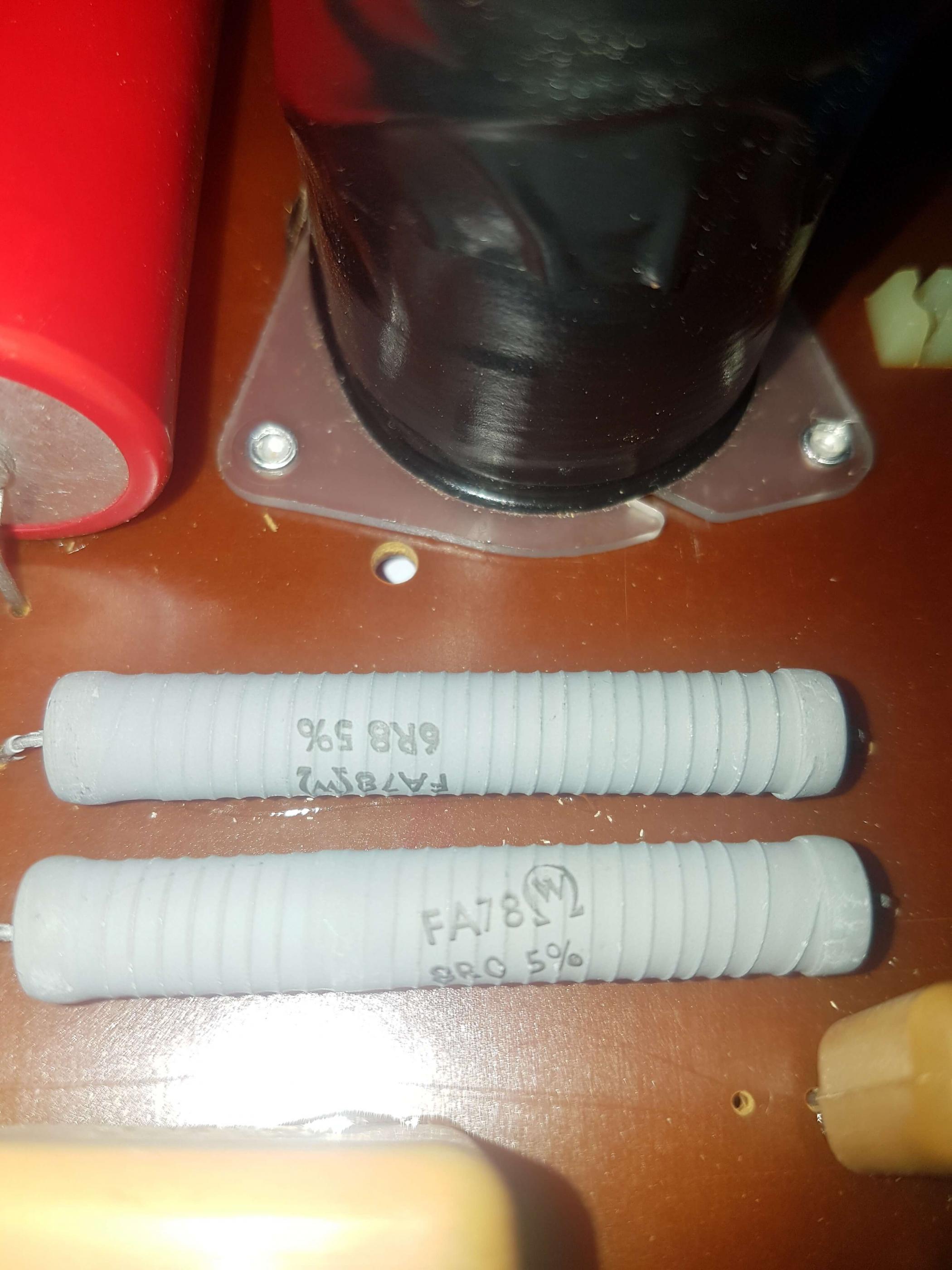

I've put up a couple of pictures and was wondering whether someone could guide me on suitable replacements for the 5 Grey Resistors? The measurements on the side say:
No1(X2) = FA78 Ω (has a "W" in the omega symbol) 10R 5%
No2 = FA78 Ω ( ) 2R0 5%
No3 = FA78 Ω ( ) 6R8 5%
No4 = FA78 Ω ( ) 8R0 5%
Thank you in advance for any guidance.

Welcome Sean!
Firstly, if these speakers are young (2014?), there should be no need to replace any crossover components. In fact, doing so could alter the sound for the worse!
Specifically,
1. If you are considering changing the NP electrolytic capacitors, then a 100V rating is quite sufficient. There's no good reason to change film capacitors in terms of secure operation of the crossover.
2. I would try to keep replacement capacitor values within +/- 5% of the original values. If you can't find the exact replacement value, you can wire two lower value capacitors in parallel with each other to provide the required capacitance. e.g. 56uF in parallel with 22uF gives 78uF.
3. I see no need to replace the resistors, but those with golden ears will say otherwise!

Hi Galu and thank you for your useful input, I'll certainly bare what you have said in mind.
The only reason I mentioned changing the resistors was because one of them looks to have heated up to such an extent that it has discoloured/burnt the PCB.

Being around 40 years old, it is certainly worth replacing the NP electrolytics on the board.
If you are resident in the UK, then check out this source of replacement NP electrolytics and resistors:

Firstly I'm lead to believe that installing a higher voltage capacitor onto a crossover isn't a problem...but how high is it realistic to go? Could I replace a 25vdc Cap with say a 250vdc cap?
Yep. This is the "breakdown voltage." That is, any voltage higher than this will cause the cap to fail, possibly with a short.
No, now you are just willy nilly replacing parts. Stick to within 5% or less of the originals. Closer is better.

Use Mills 12 watts. Inexpensive, small, sound very good. Leave them an air gap including to the board to ensure they stay frosty.
The R is the decimal point in the resistance. 10R = 10 Ohms. 6R8 = 6.8 Ohms and so on.
If you want to stick with the B&W sound, they've gone from generics to 100% Mundorf caps. In the mid-price speakers they use a lot of Mundorf MKP capacitors.
The last thing I want to point out is be careful replacing big electrolytic caps. The ESR (Equivalent Series Resistance) is typically quite high, and changes to them without additional series resistance can have unexpected consequences.
If you can afford Dayton DATS I encourage you to measure the whole speaker's impedance before you do any work (drivers in cabinet), as well as the ESR of any caps you replace. If it is too expensive, you can use Room EQ Wizard to measure ESR with a jig.
Measuring the impedance before hand will give yo an easy diagnostic tool. While there, measure the impedance of the drivers in cabinet. This will let you do impedance and transfer function (i.e. voltage) simulations (but not acoustical) using XSim.
Always worth seeing the schematic, this for a DM2 ver2 IIRC:
I just measured a 10W Ceramic resistor. which is 48mm long. Cost about a pound.
You only replace if the measurement is wrong, IMO.
Might be worth reflowing the solder if it has run hot.

Sorry, I should have been more clear. This is based on pictures of modern B&W crossover. I should not have claimed complete knowledge of all models in all cases. 🙂
Thanks for the schematic Steve!!
Agree that you don't "need" to replace anything. I also think that with any speaker if you can do a full speaker analysis, especially stuff from the 1990's or earlier, you are better off. Never know when you are rebuilding a bad design to start with.
My recommendations were from the perspective of some one wanting to upgrade for fun. 🙂
In the schematic, C1/C3/C4 are all caps that should be measured for ESR before replacing, but I've heard good things about replacing the 2nd order cap on a woofer (C1) so I wouldn't say don't do it... but do so carefully and see what happens. 🙂

Be interested to know which resistor got hot. Sometimes manufacturers use them as a fuse.
I noticed that most, if not all of the Caps I require are reversible.
I've just checked my PCB and the resistor that heated up is on another board.... I'm also refurbing a pair of 1987 B&W Concept 90 speakers. I'll get a picture of that at some point today.
I've made some notes and will have a scout round on the link you sent me to try and match these components up.
Thanks for the links and advice Steve. 👍
