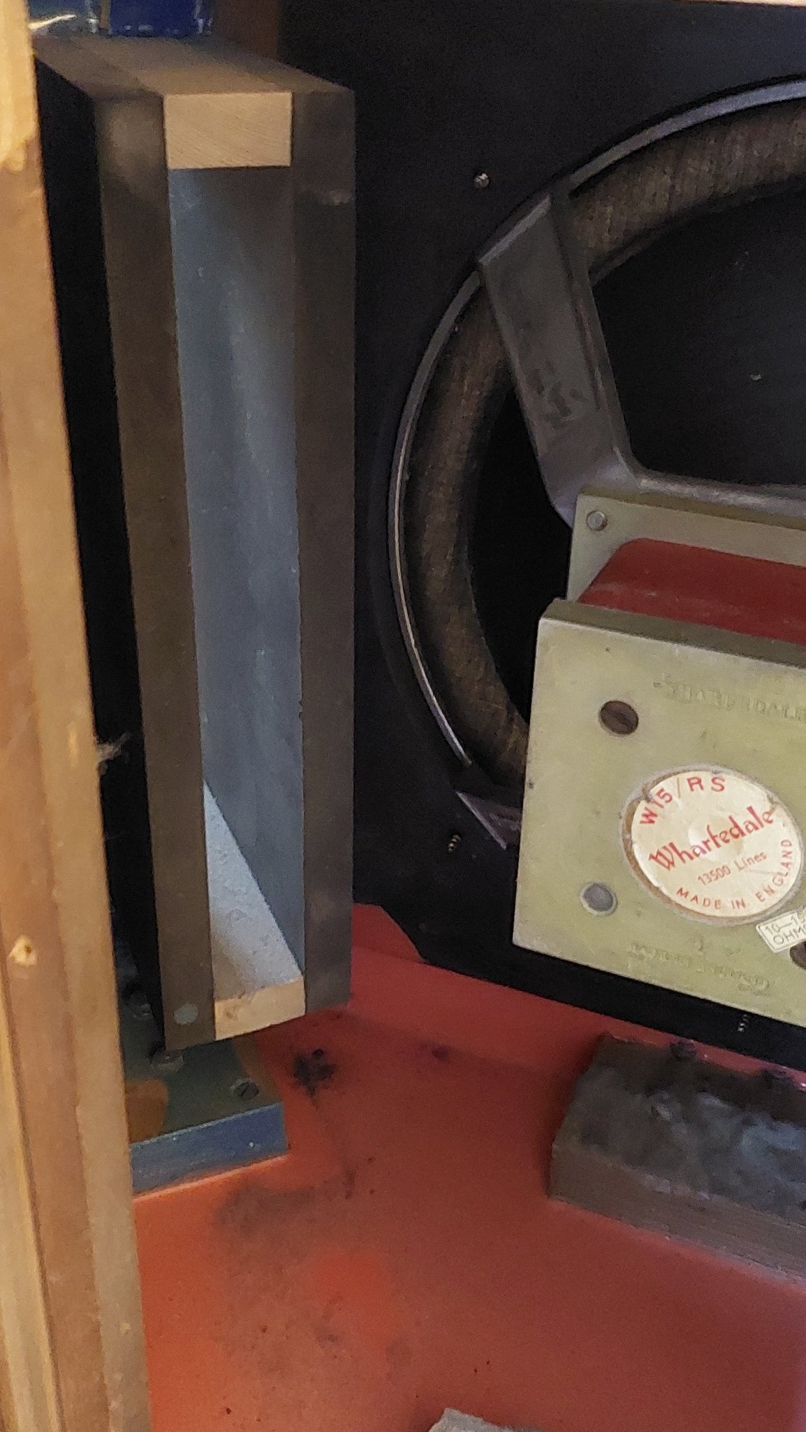

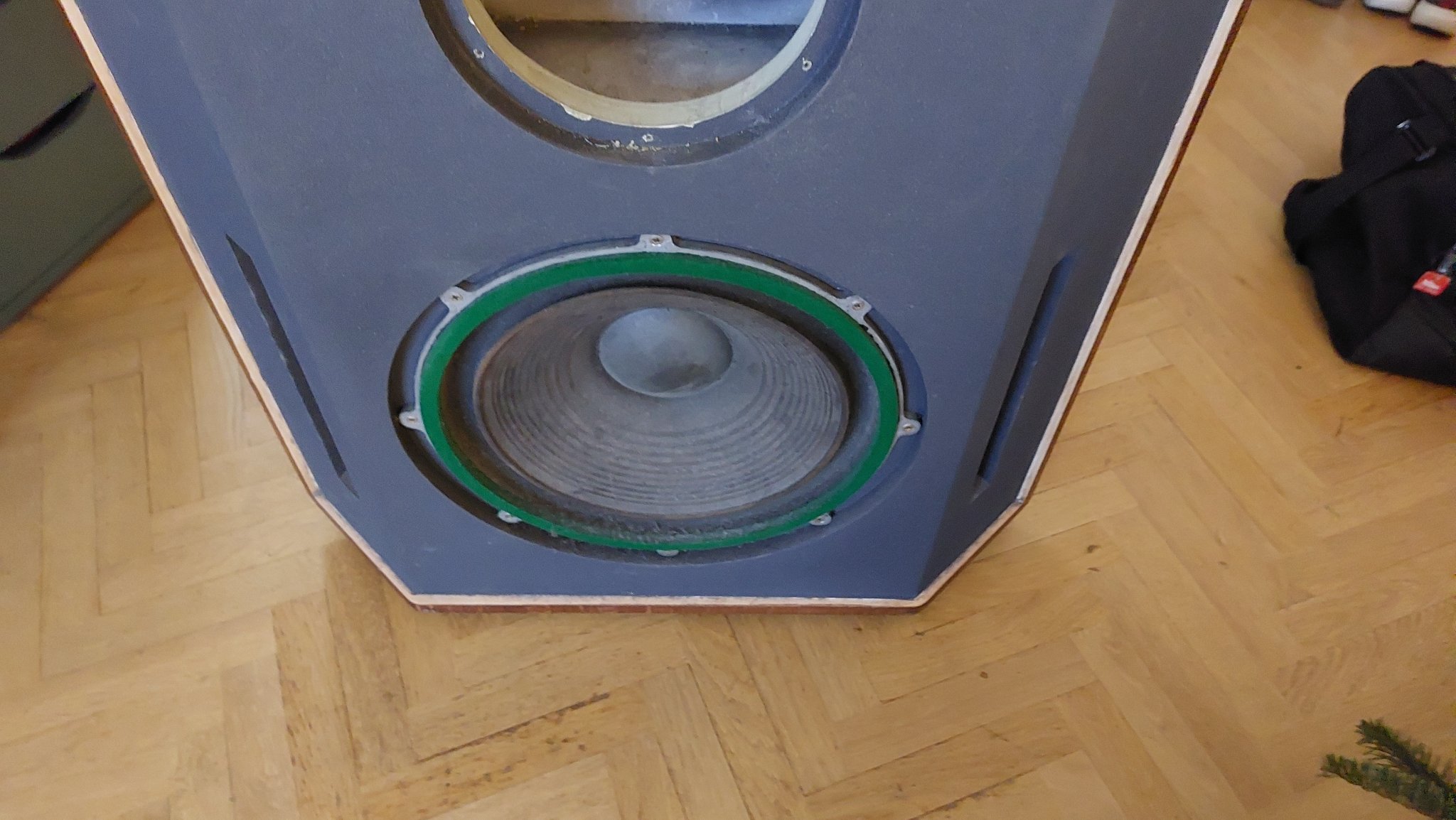

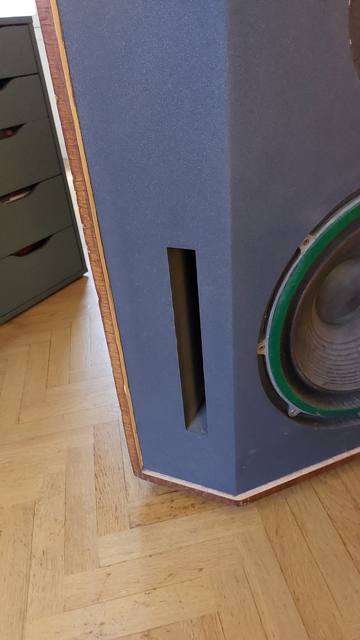

hello ,
I am trying to calculate the good dimension of my rectangular port (for after buy a good woofer) . I already have a big cabinet with 2 rectangular vents of:
26cm x 3.4cm x 28.5cm (each)
as I have 2, one on each side
is it correct to say that this corresponds to 1 single event of:
26×3.4×57 (28.5×2)?
26×3.4×57 (28.5×2)?
The tuning won't be 100 percent dead on anyways if you factor in other (somewhat subtle) variables which affect it ie. altitude, barometric pressure, air temperature and humidity. Driver TSP parameter drift caused by varying VC temps can also further offset it, but thats not common for home audio drivers. These first mentioned things can have a noticeable impact on tuning if the stack up of variables shift against your favor. Most poeple just aim for a specific port length correction factor and let things fall where they may. Usually in the practical world I end up with a shorter port length than originally calculated.
thank you for your advice, I confess that I don't know too much about port settings!

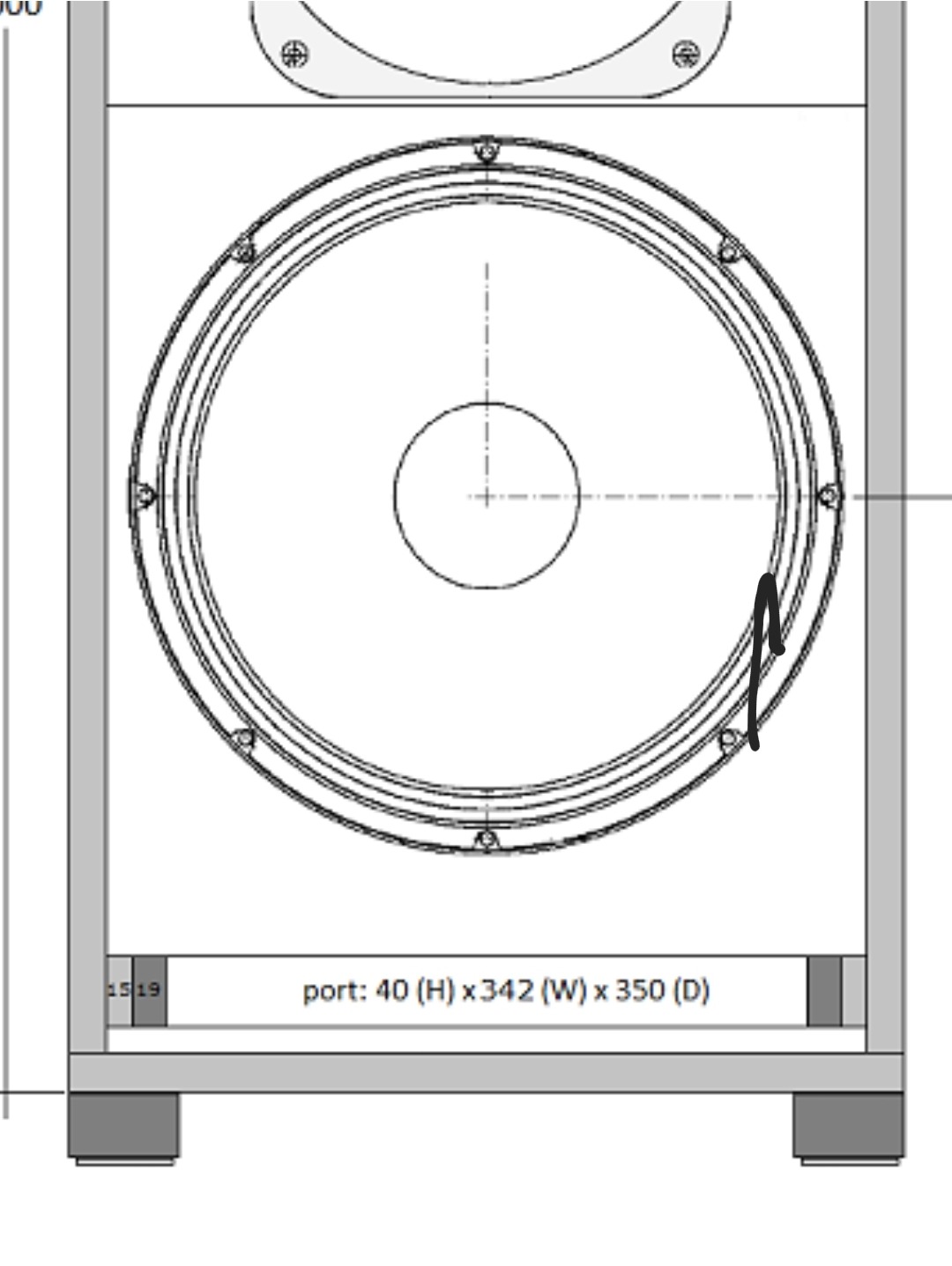

in troel gravessen's "loudspeakers III" project, the rectangular port is this one;
40x342x350
I have a cabinet of the same volume, around 110-120 liters
if i change my 2 ports with the following size
26×3.4×54 (27×2)
is it fair to say that it comes to the same thing?

Volume loudspeaker port
40 x 342 x 350 = 4 788
Volume of my speakers port
26 x 3.4 x 54 (2x 27) = 4774

The Loudspeaker III is is 45 (W) x 50 (D) x 100 (H) cm, 225 liter gross volume, double the volume you say yours are.in troel gravessen's "loudspeakers III" project, the rectangular port is this one;
40x342x350
I have a cabinet of the same volume, around 110-120 liters.
The volume of the port does not determine the Fb (Box tuning Frequency), the relationship between port length and depth and the cabinet's net volume do.
You can determine the Fb by running a sine wave through the speaker, at Fb, the speakers excursion (and impedance) will be at minimum, increasing above and below Fb.
If you want a higher Fb, reduce the port length, lower Fb, increase the port length.
The volume of bass cabinet is 125 liters for the Loudspeakers III (there is a closed box for Mid too )
The port is 40 x 342 x 350
I have 115 liters (i think) i have 2 port
260 x 34 x 270
Thank you for your explanation
