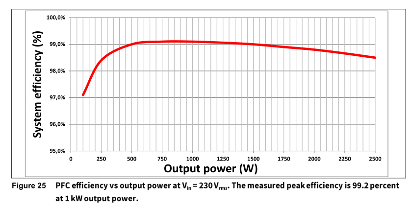

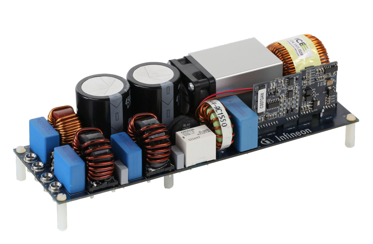

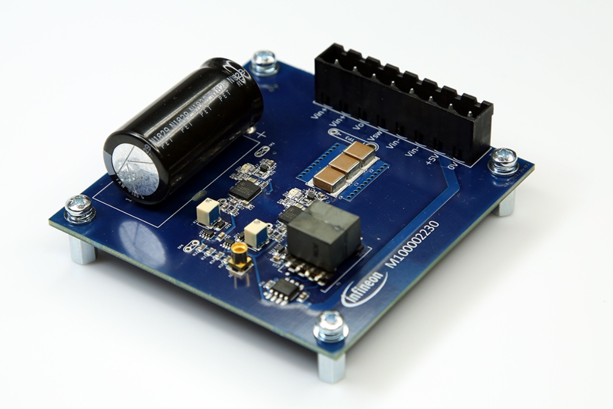

GaN SMPS +99% Efficiency
Taken from post over at Hypex NCore NC500 build post #1980
I did some further investigations and found that Infineon has an interesting GaN SPMS.
EVAL_2500W_PFC_GAN_A
2500W full-bridge totem-pole power factor correction evaluation board using CoolGaN™ 600V e-mode HEMT
This 2.5kW CCM full-bridge PFC evaluation board utilizes the advantages of Infineon’s CoolGaN™ technology to boost system efficiency above 99 percent for efficiency-critical applications such as server power supplies or telecom rectifiers. The board features CoolGaN™ 600V e-mode HEMTs, CoolMOS™ C7 Gold superjunction MOSFET and EiceDRIVER™ gate driver ICs.
Flat efficiency >99 percent over wide load range
EVAL_1EDF_G1_HB_GAN - Halfbridge (DC-DC)
CoolGaN™ 600V e-mode HEMT half-bridge evaluation platform featuring GaN EiceDRIVER™
This 600V gallium nitride (GaN) half-bridge evaluation board enables easy, rapid setup and test of CoolGaN™ transistors. The generic topology can be configured for boost or buck operation, pulse testing or continuous full-power operation. Test points provide easy access to connect signals to an oscilloscope, to measure the switching performance of CoolGaN™ transistors and gate driver. This board saves the user from having to design their own gate driver and power circuit to evaluate gallium nitride transistors.
Hypex SMPS1200A400 is 92% efficient in comparison.
