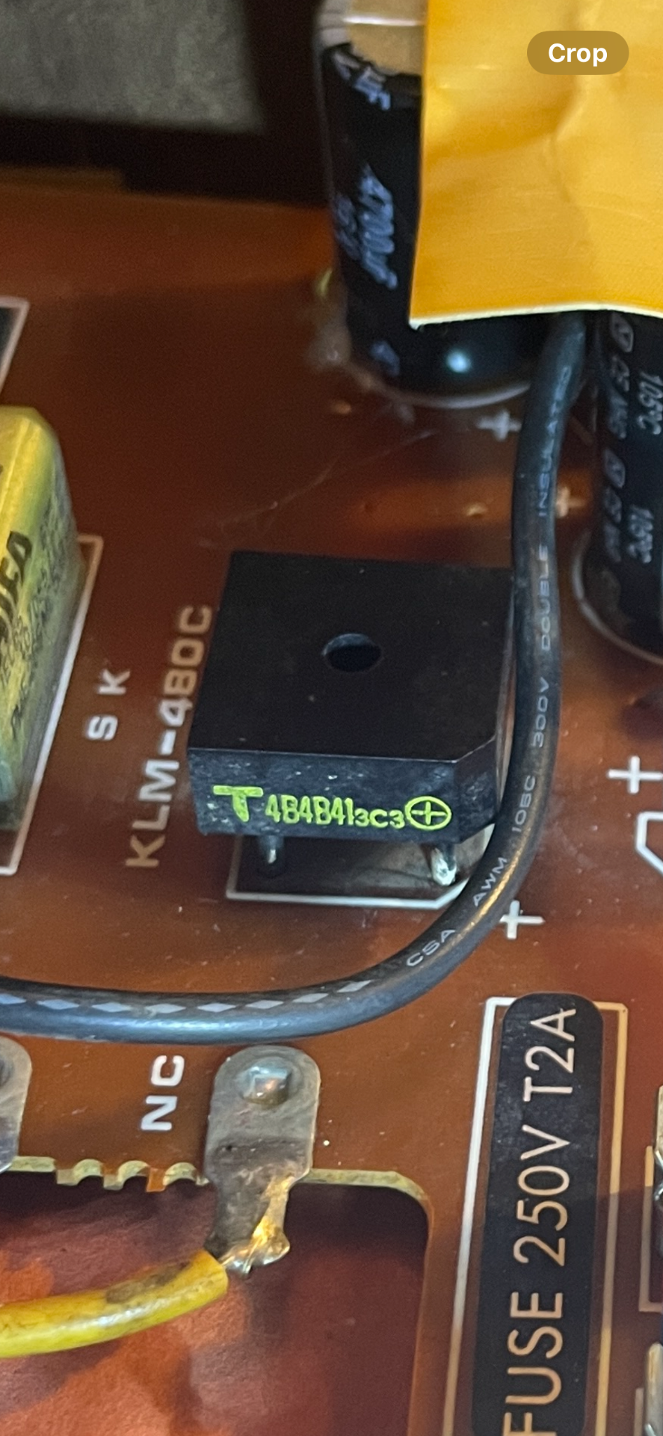

Hello,
New to this forum!
I’ve been trying to fix my Poly 61- the transfomer gets hot when switched on (i heard a bang near the power supply side one time when i was fitting a Midi kit) i have descovered this only happens when under load when other boards are connected, and the bridge rectifier gets very hot, so i’m convinced its this that is at fault. After connecting another board to the supply and taking chips off to lower the current load, the transformer cools and the bridge rectifier still gets very hot. I could’nt find any shorts on the other boards.

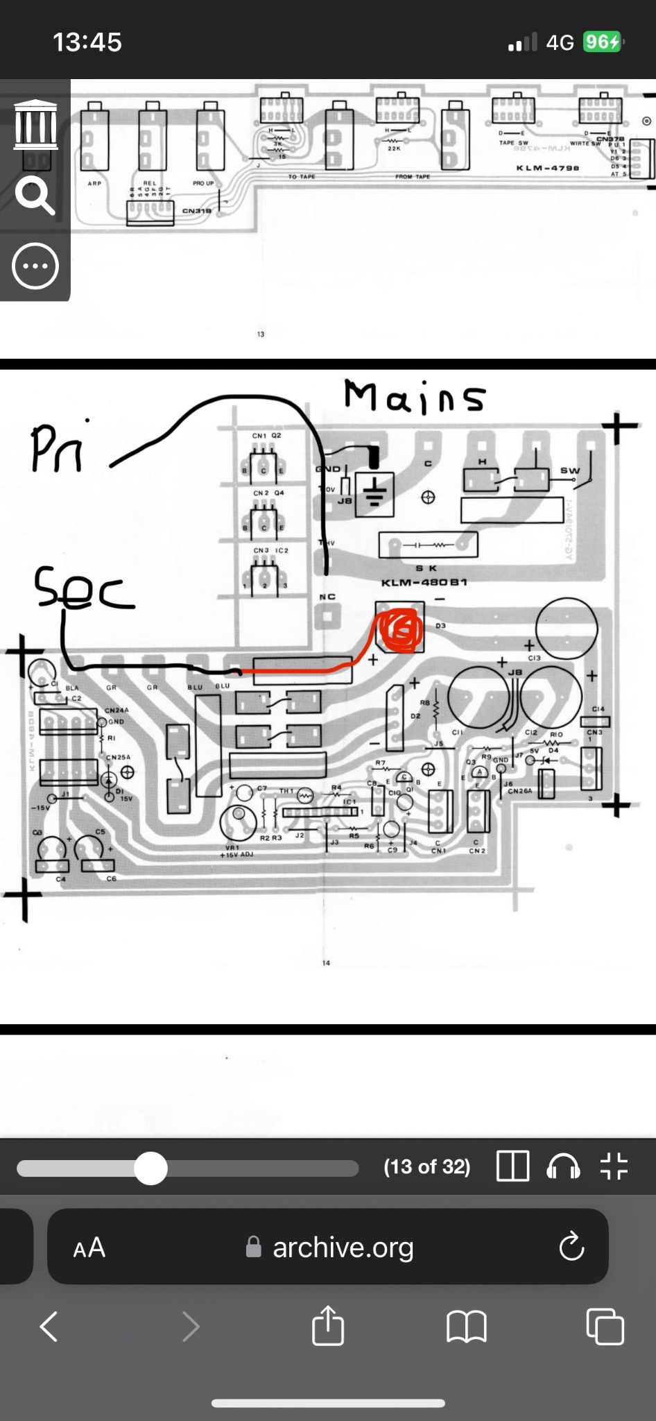

In the schematic, you can see this part is connected on the secondry side, and is labelled D3. I will attach.
Please can someone advise me which replacement bridge rectifier part to get? I’m unsure what the numbers mean, and the schematic power supply page is unreadable, it just states the part as 4B4B41?
I’m not sure how to test these components also, and if it is at fault, then it might be tricky to buy another seen as this one is at fault? Will a generic bridge rect diode part work as a replacement? I’m cautious of buying another part and using as it could cause more faults (and obviously dangerous), i’ve spent so much time trying to get to the bottom of this and I can see light (maybe) any help here to advise would be appreciated, thank you

Here's the datasheet for the bridge: https://datasheet.octopart.com/4B4B41-Toshiba-datasheet-181389253.pdf
That should help to find a replacement.

Here's an example for a replacement: https://www.digikey.ca/en/products/detail/genesic-semiconductor/BR62/3927701
It doesn't hurt (or is imperative...) to figure out why the original part failed...

if something got shorted when you "where trying to fit a midi module" you need to determine just what got shorted before jumping to the conclusion that the rectifier is bad, it could be a filter cap or a regulator or something else.
checking diodes even in bridge form is dirt simple, but you should look at some form of current limiting so as to not damage more with subsequent attempts at troubleshooting.

The original bridge is rated for 100V and 4A current draw. In order for it to roast either the voltage rating got exceeded or the current draw. The only way I see for the voltage rating to get exceeded would have been the power transformer windings getting shorted in a way that would pass primary AC on to the secondary. That would be odd and would have blown up a bunch of other parts but still check that: unhook the transformer secondary and check with the resistance setting of your multimeter, if there is any continuity from the primary to the secondary. If there is not, hook it to mains and read the secondary voltage.
Other, more likely cause would have been a short somewhere after the rectifier that would have drawn excessive current. This would also have potentially damaged the power transformer.
