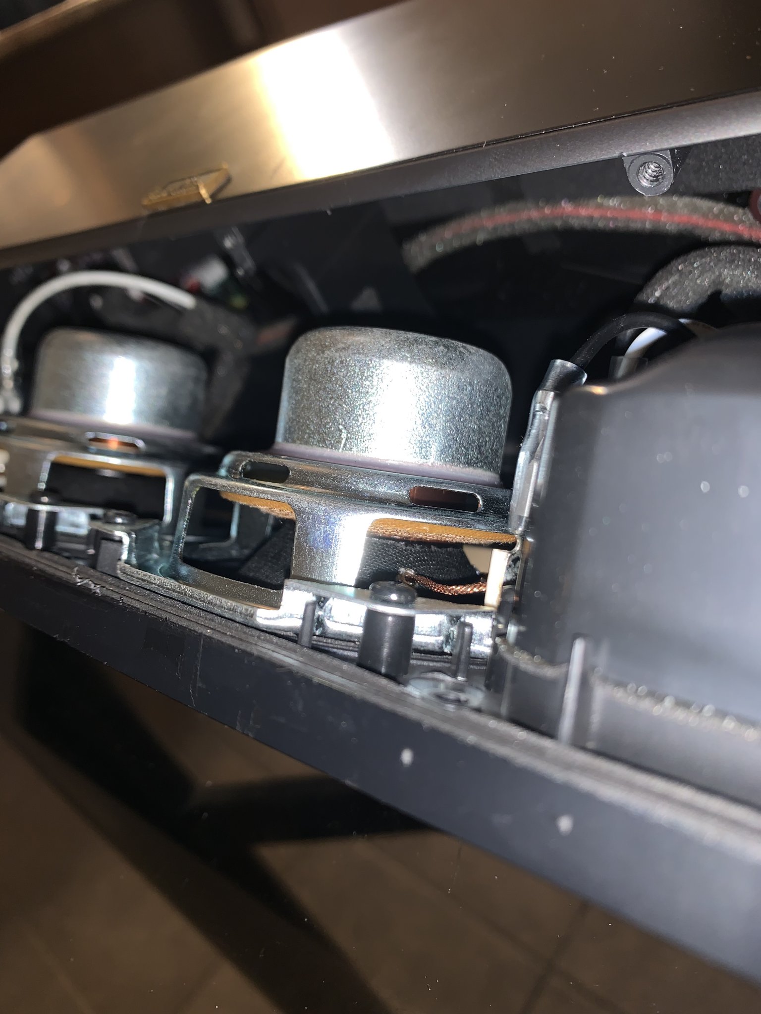

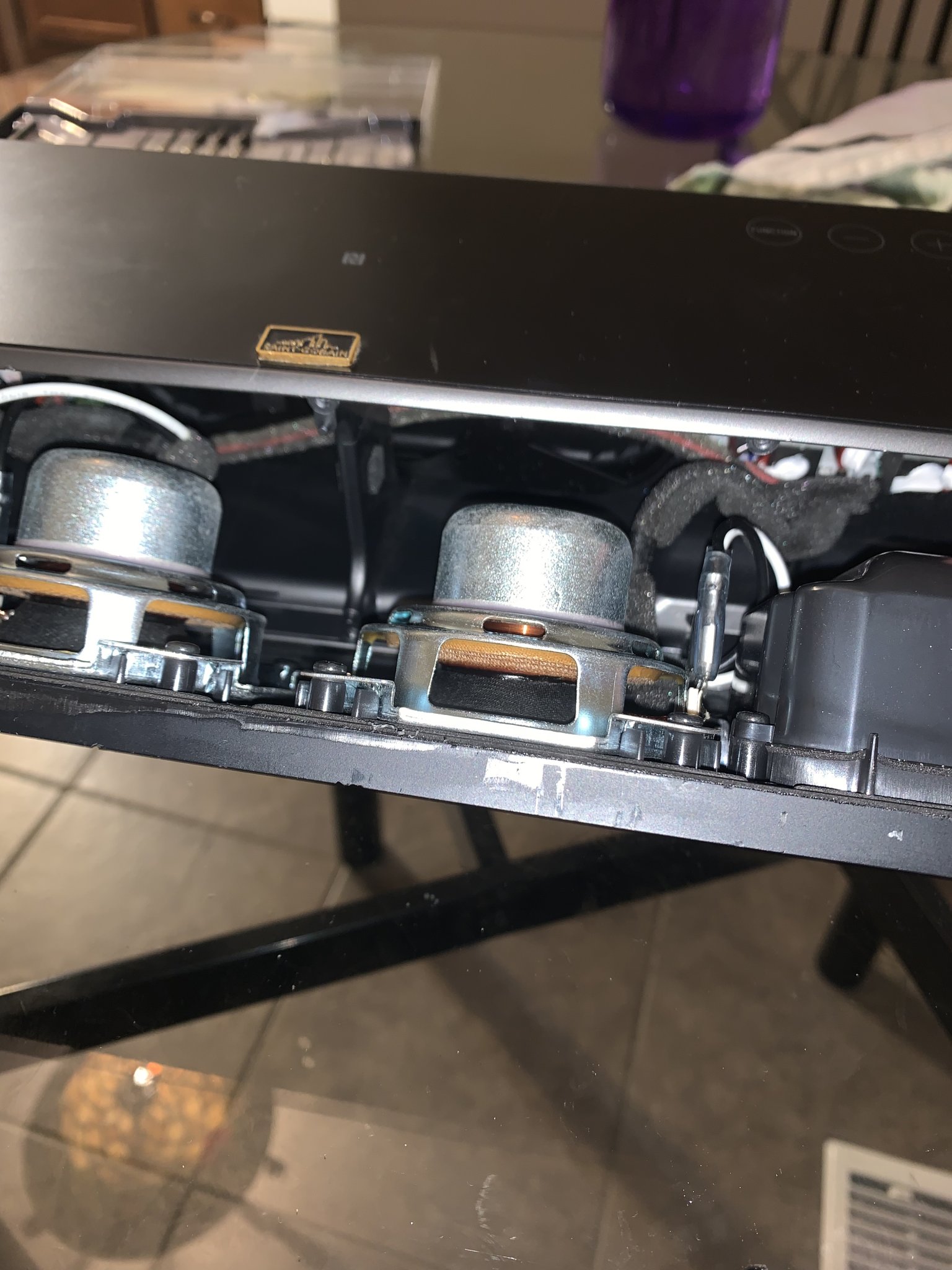

When you get inside the enclosure, you could send us photos of the rear of the woofer (top and side views) so we can inspect the magnet system.

Thank you so much @adason and @Galu! Got it open, attached are photos from all angles. When I push down on the cone I do hear a rubbing noise, but only on that one cone. Any suggestions for next steps? I’m willing to give a DIY fix a try if there is a good youtube video and any hope of fixing it (even if it’s not promising)
Seems to have shifted the magnet off center.

Your best option is to either try to shift the magnet back, or to send it to a service facility.

It's hard to tell from your photos if the magnet has shifted.
If you remove the driver from the enclosure and photograph it directly and squarely from the back and the side, we may be able to tell for certain.
