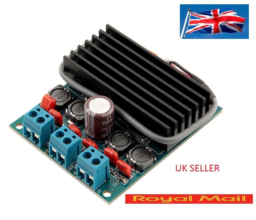

hi guys. after problems with a previous amp. I bought a several more amps to try.
one was a tda7492. my question is, what or how do I use the btl mode as it states
Maximum power:50W*2/8 Ohm Mono BTL power 100W
cheers

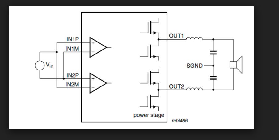

cheers guys. so in theory looking at the diagram I would say tie the speaker + to the right side terminal and the speaker - to the left side terminal. or am I wrong
This is the bridge mode.
Suppresses interference from mains.
Oh..Yes you are right......sorry my fault. Wrong Attachment.
Sorry
Google Image Result for https://m.eet.com/media/1179712/new_approaches_switched_mode_amplifiers_fig2.jpg
In pic i can see nothing. Diagram....? Can't See it

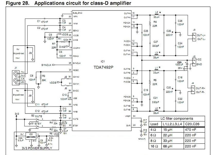

I found some pics from the other side of the PCB. In the middle there is the Power Connection. Vcc and Gnd
Left and right are the Speaker Connectors. Plus + to plus +....and Minus - to minus-
Hello.
No mono mode or PBTL.
correct
@jabie5
connect one Loudspeaker to one of the channel (e.g. R+ and R-)and put a Resistor with about 8Ohms and 5 Watt to the other channel.

sorry but it si not possible...read this...
its written by the board seller....but not from the chip specification
BTL Bridge?
BTL Bridge?
This is seller specifications, false.Specification:
Power supply: Single-voltage 10-26V DC
Maximum power: 2x50W / 8 Ohms
Mono BTL power: 100W / 4 Ohms
Size: 71 x 60 x 20 mm
Read ST specifications, it's 2x50W, so you can use one channel but it cannot exceed 50W.

It is correct what you write.
From the picture I would say that amp is already running in BTL mode ... the four output coils for two speaker connectors is a dead giveaway.
What you've got there is a nice little stereo amplifier ... hook it up and enjoy it.
The specs you showed appear to be gibberish, posted to impress you, not represent the product. Keep in mind that this stuff gets sold in pallet quantities and is often put online by people who wouldn't know an amplifier from a watermelon.
