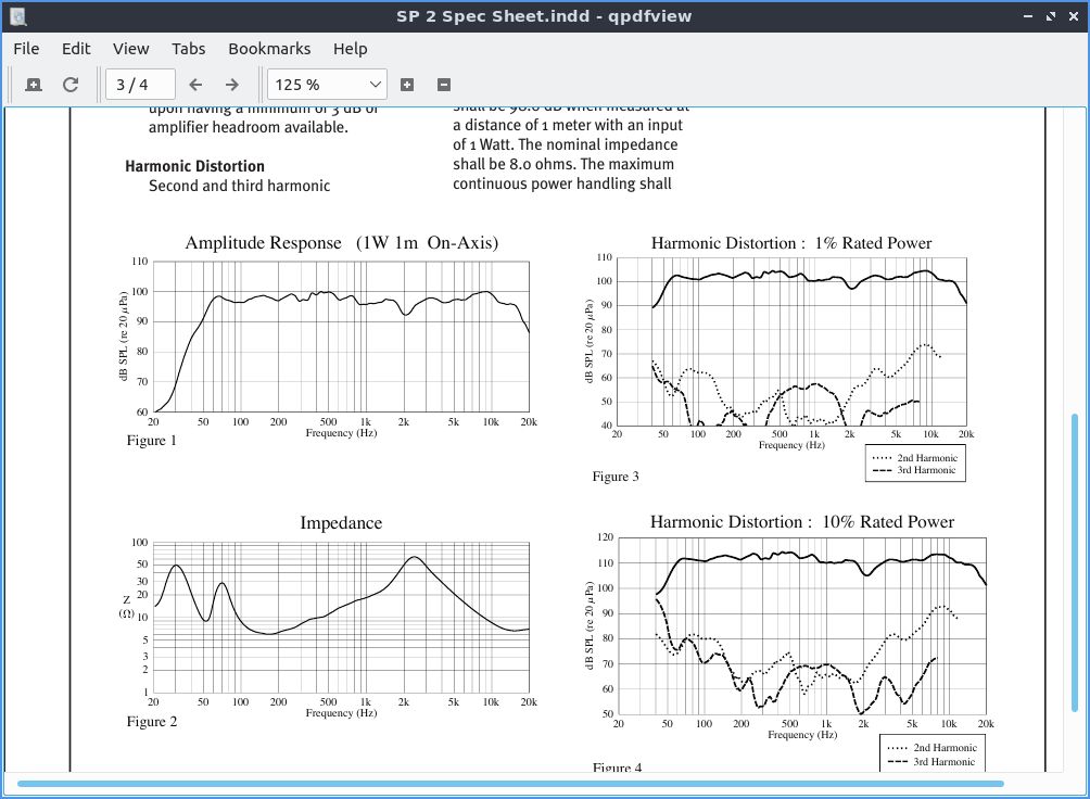

Flat alignment or response allows a speaker to sound like a real musical instrument. People from the car world are often looking for the buzz and boom, which is not hi-fidelity at all. Most bands and orchestras do not sound like buzz and boom. Look at this chart from a Peavey SP2(2004) speaker which is flat +- 3 db 54 hz 17.5 khz. The amplitude upper left is pretty flat which means it can not only sound like a singer/songwriter playing wood guitar, it can sound like a top quality piano, cymbal, tinkly bells, or pipe organ. Harmonic Distortion upper right means frequencies double and triple the real sound are not added very much. Another number describing the ability to reproduce real sounds accurately. Go listen to a Steinway grand at a concert or church, then try CD tracks of the same piano on various speakers. The first speaker I've owned that passes that test is this one. There are others, but not sold in my iiny flyover city of 2000000. If your hearing stops at 5000 hz the way most US male's does, you will not able to tell the difference.

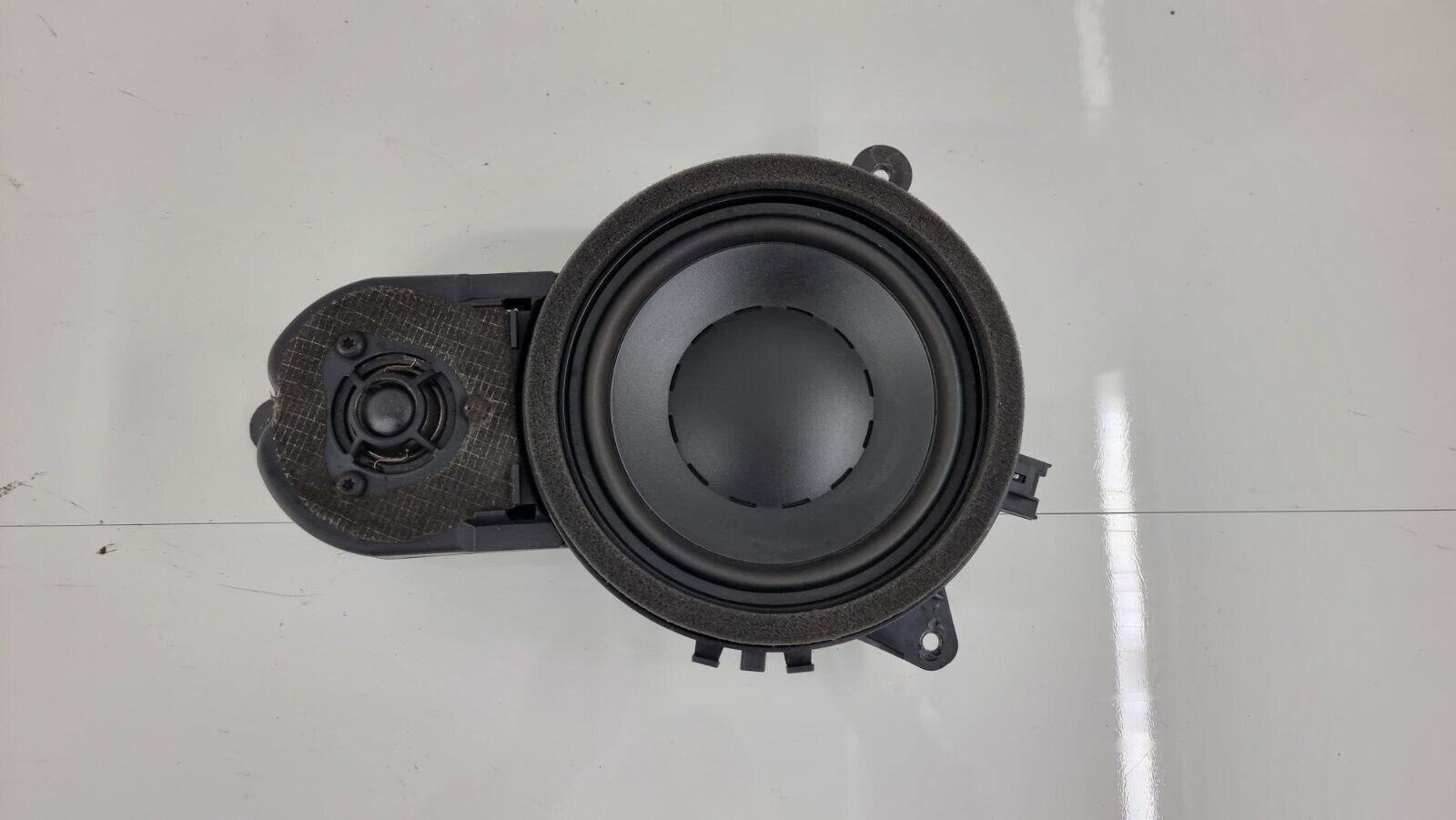

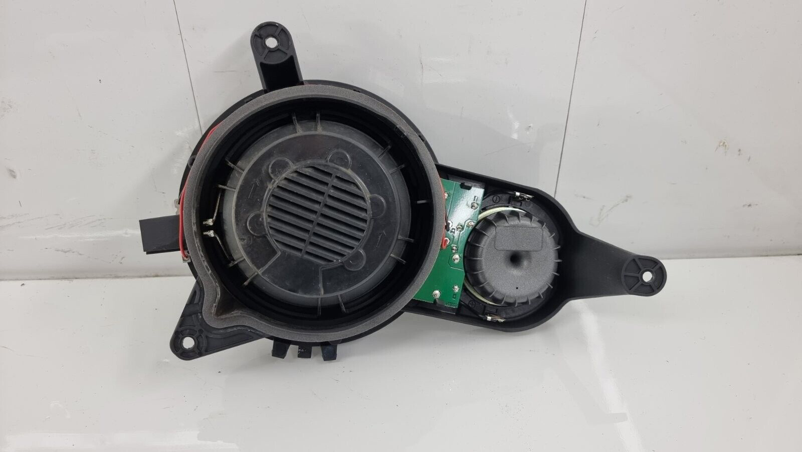

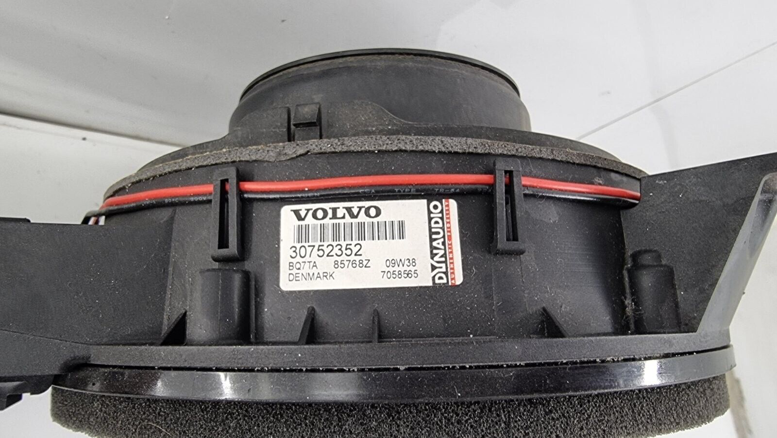

To all thanks. I have been sent the sticker on this woofer. The Volvo code is 30752352 and I presume the dynaudio is bq7ta. From memory, dynaudio had no info on this speaker. As I am bedridden, ill put the info out there. It seems that ebay has interest in the repurposing of dynaudio Volvo and vw drivers.
https://www.ebay.com/itm/155216031517
Volvo 30752352
built in crossover

Those plots in post 15 appear to be phase and impedance only. Non-interesting except for crossover design. Amplitude at 1 w 1 m on an infinite (large) wall would be interesting.

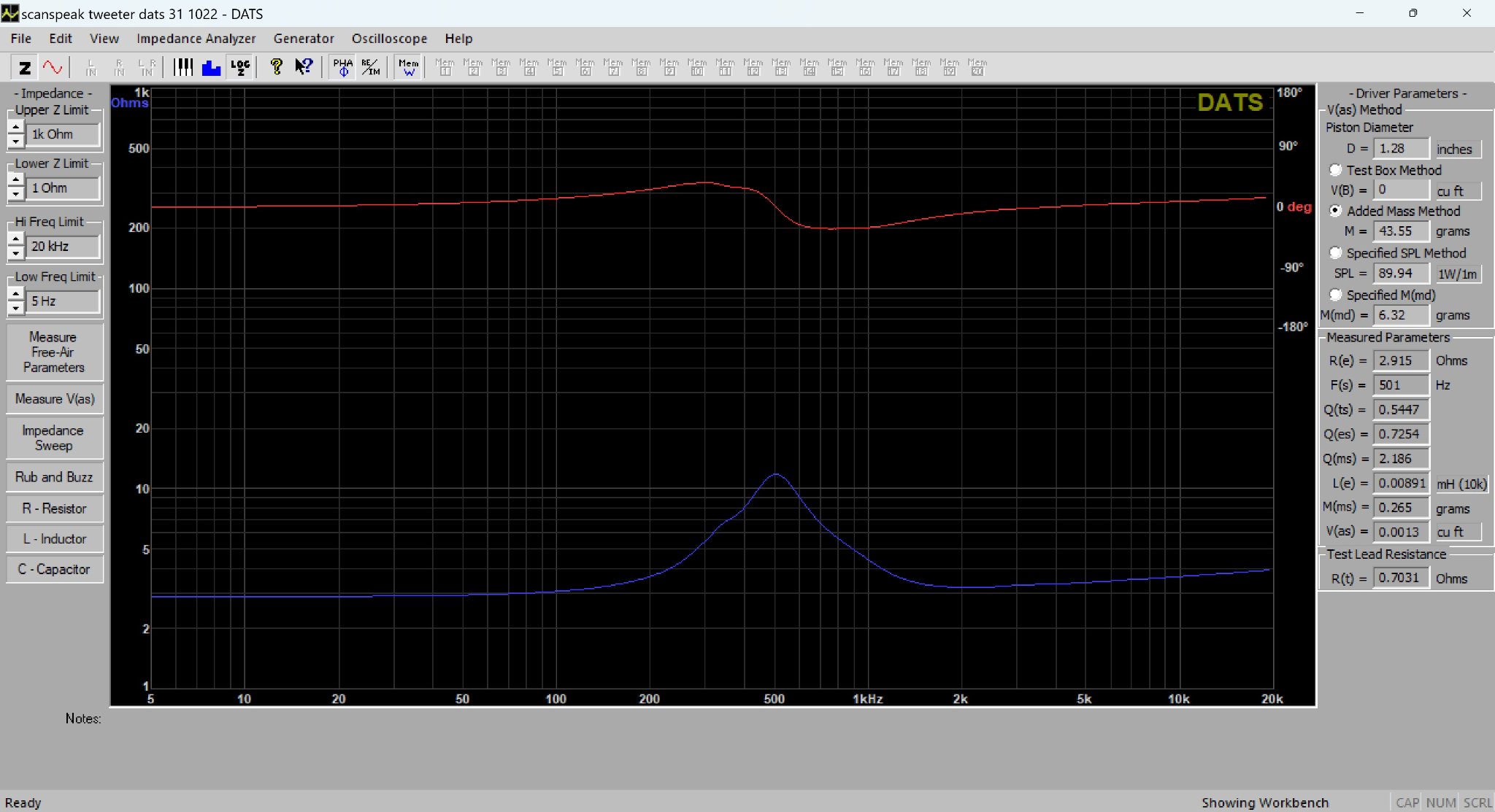

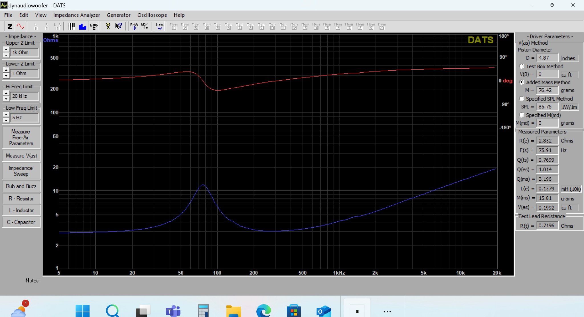

With the info provided, are any of the t/s parameters, or impedence curves providing any blurred outline of what the end product will look like?

There is the scientific approach, measuring T/S values. Requires the equipment listed in post # 5. Plus a quiet room, and some software. The name of the software, look on the software thread for a post about measuring T/S value.
There is the "take a guess and listen to the result" method. Since these drivers came from a car door, you could estimate the interior volume of a car door. Then build a box to match the volume. Listen then criticize the result. I took the second approach with found drivers I use in my TV room. I built a box approximately the size of the volume behind the drivers In the projection TV they came out of. I used cardboard. At 2 watts (13 watt limit the driver has printed on it) the cardboard does not audibly vibrate. Works okay. At least as good as the used speakers from cheap home systems sold at the charity resale shop. Most units, better. Lots of cheap plastic speakers look like they are 7:" diameter, but actually they contain a 2" woofer. The drivers I salvaged from a projection TV sitting on the curb for garbage are actually 6 1/2" diameter.
