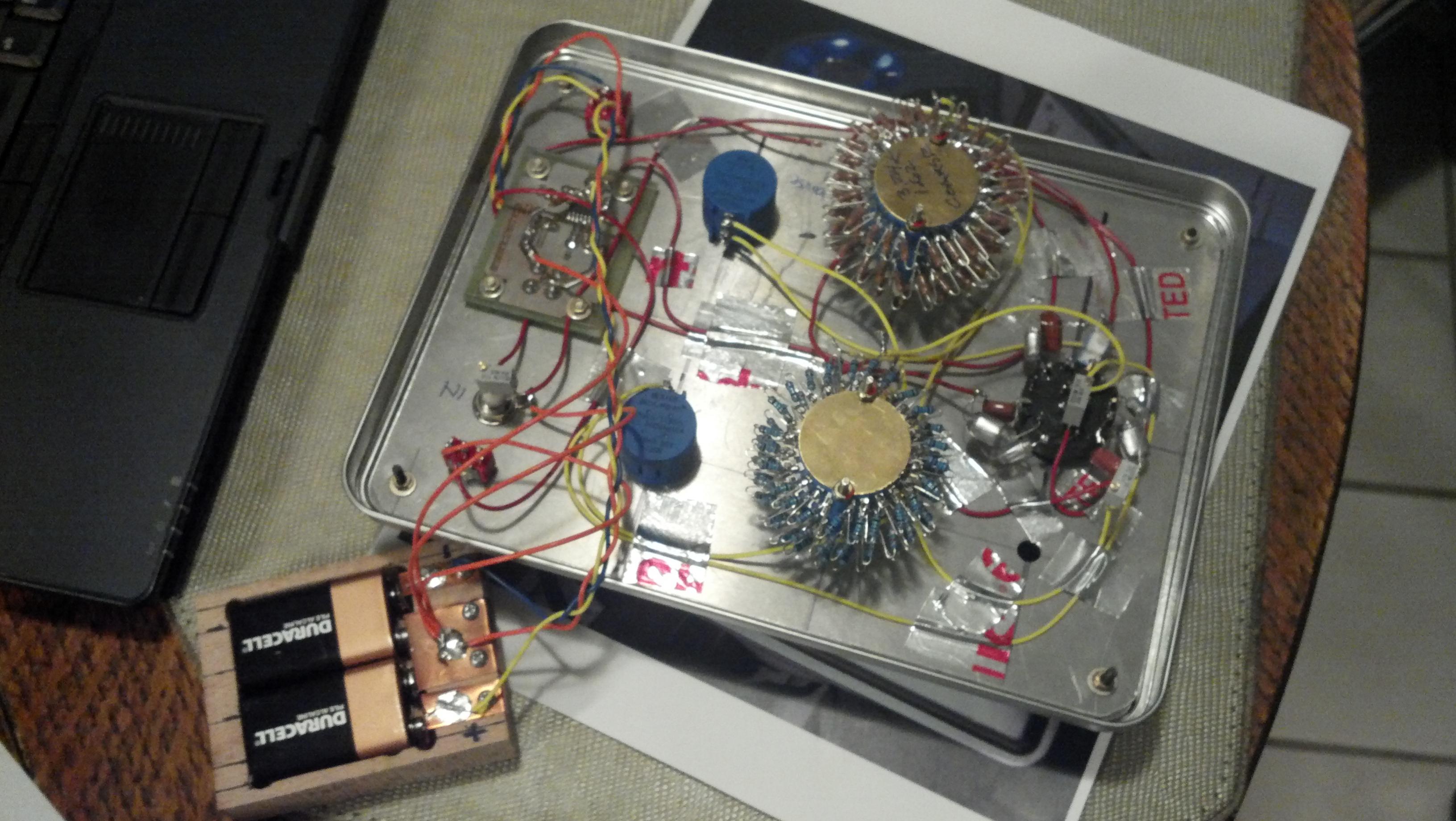

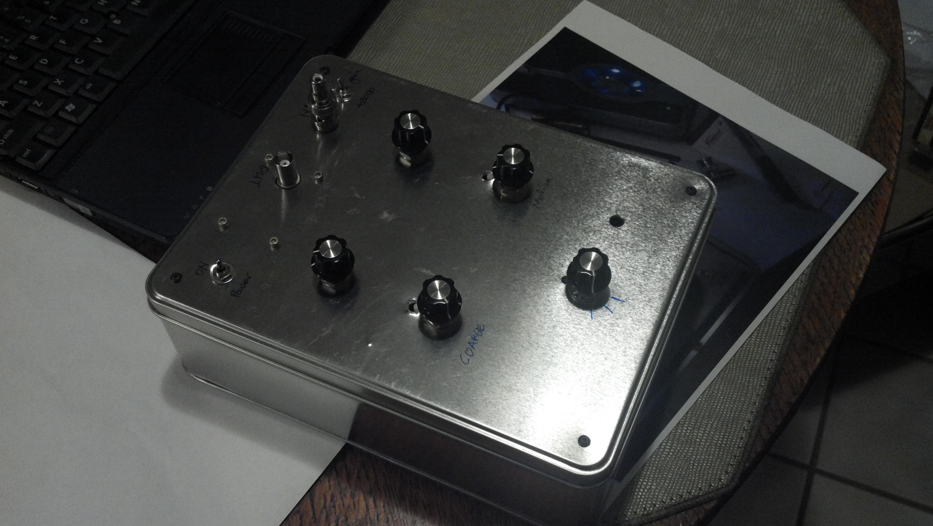

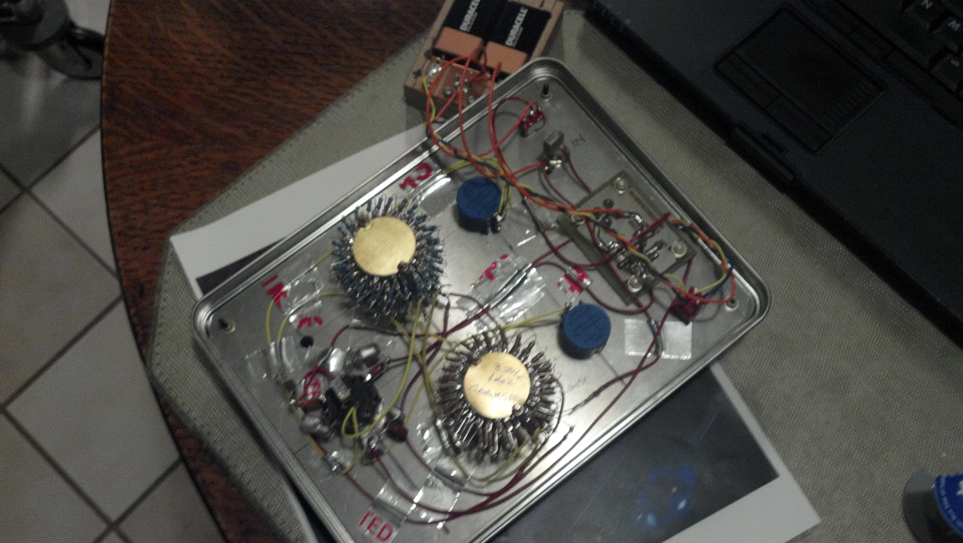

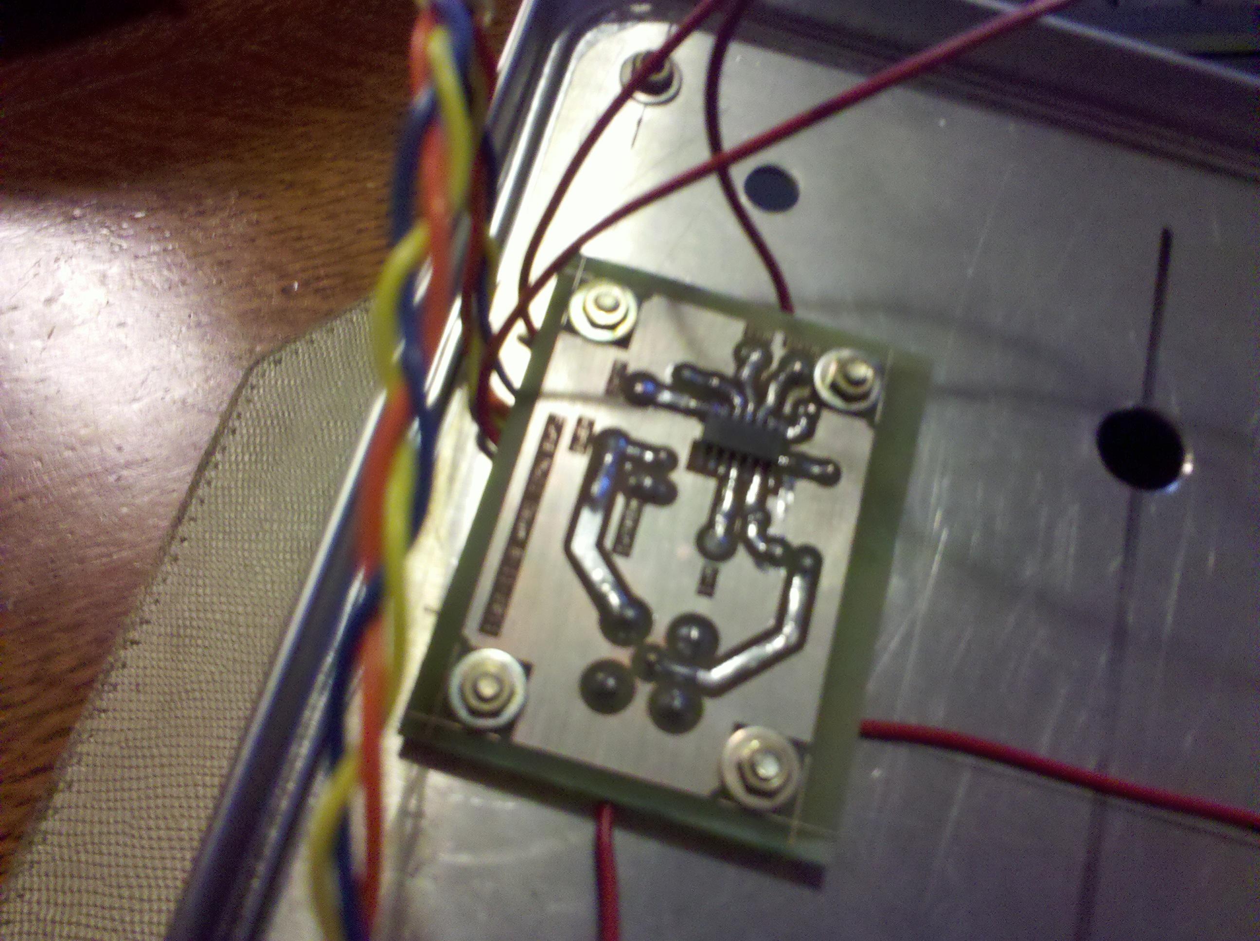

Dick,

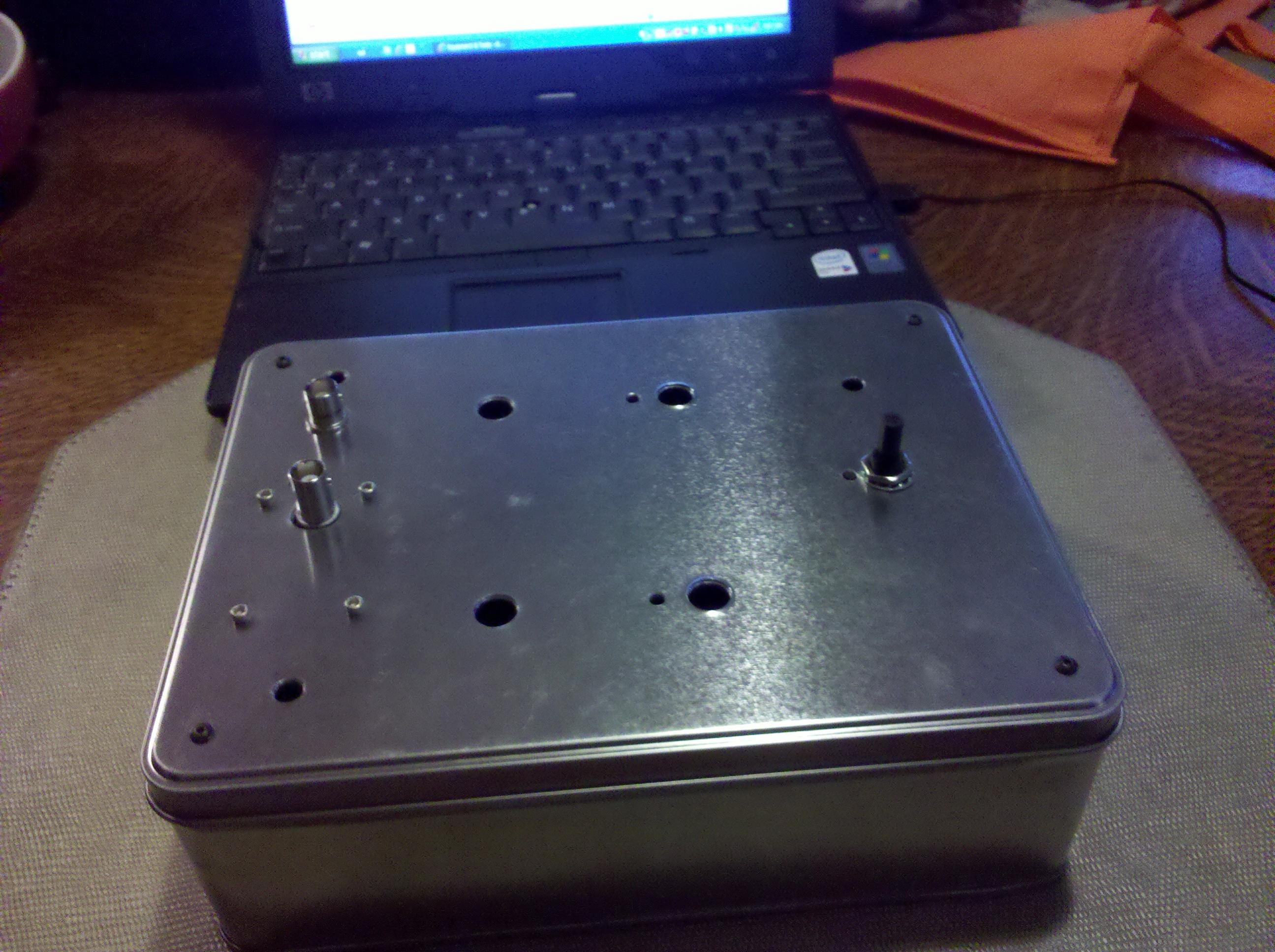

Attached are progress phone photos. I found the same tin at Michael's and added a 1/16th inch aluminum to the inside of the top to stiffen it up a bit. I etched a small board for the opamp section and used the quad opamp in lieu of singles. The resistors are on the bottom of the board. I also included the out bnc in the board. The stepped switches are done, but, not in the photos.
Ken
Ken
Dick,
Two more questions for you.
1. Gain SW-4: What does pin one (0db) connect to? or does it just float?
2. Resistor R148 value is 1N? (on leg between C4 and OPA134 U1)
Thanks again.
Ken

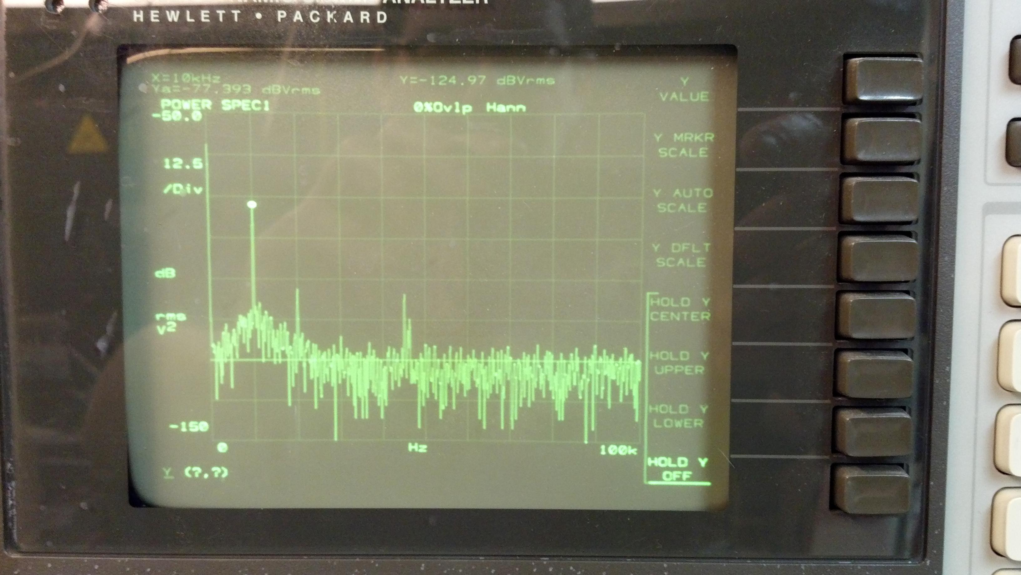

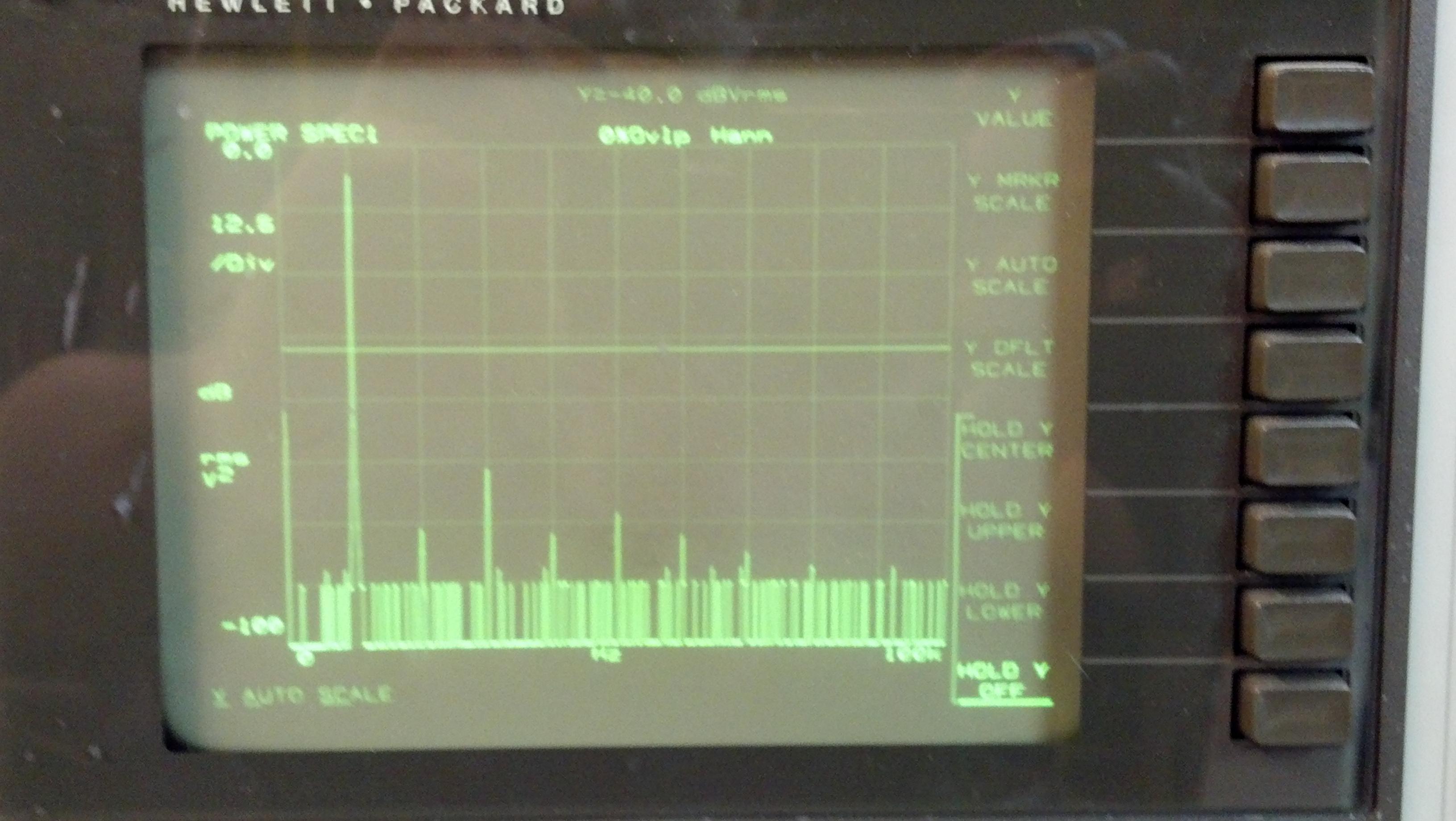

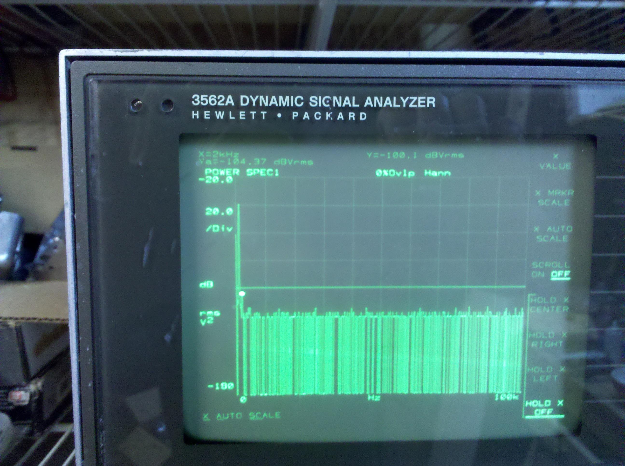

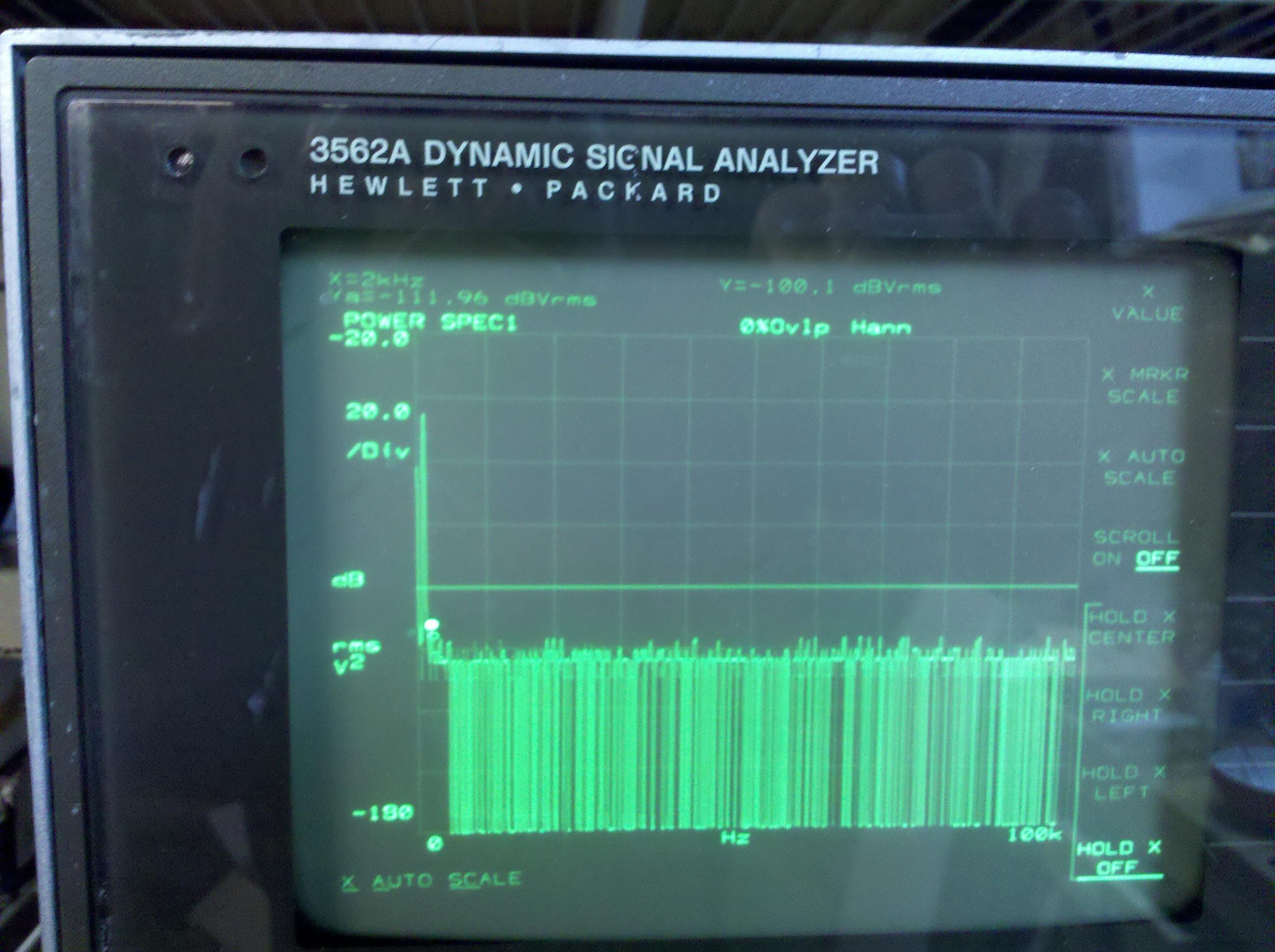

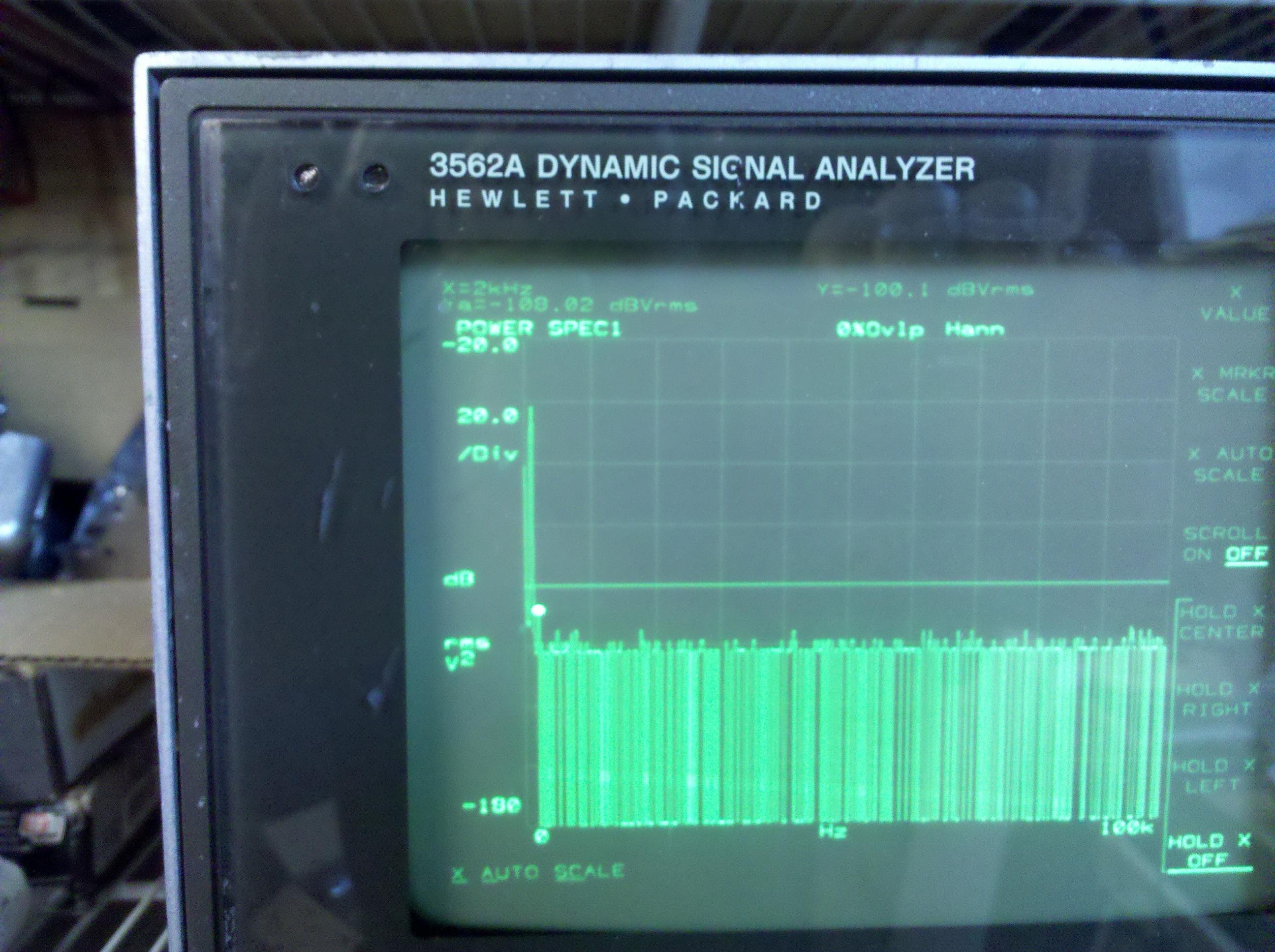

Here are screen shots from my HP3562A spectrum analyzer. The analyzer can resolve 60 to 80 db of signal.
The first photo is with the signal from HP8903A 10kHz 0.5Vrms straight into the analyzer. The signal floor is -90db due to the fundamental being at about -5 db (85 db of resolution). The 2nd, 3rd, etc. harmonics are showing, probably because I'm feeding them directly in the analyzer without a load.

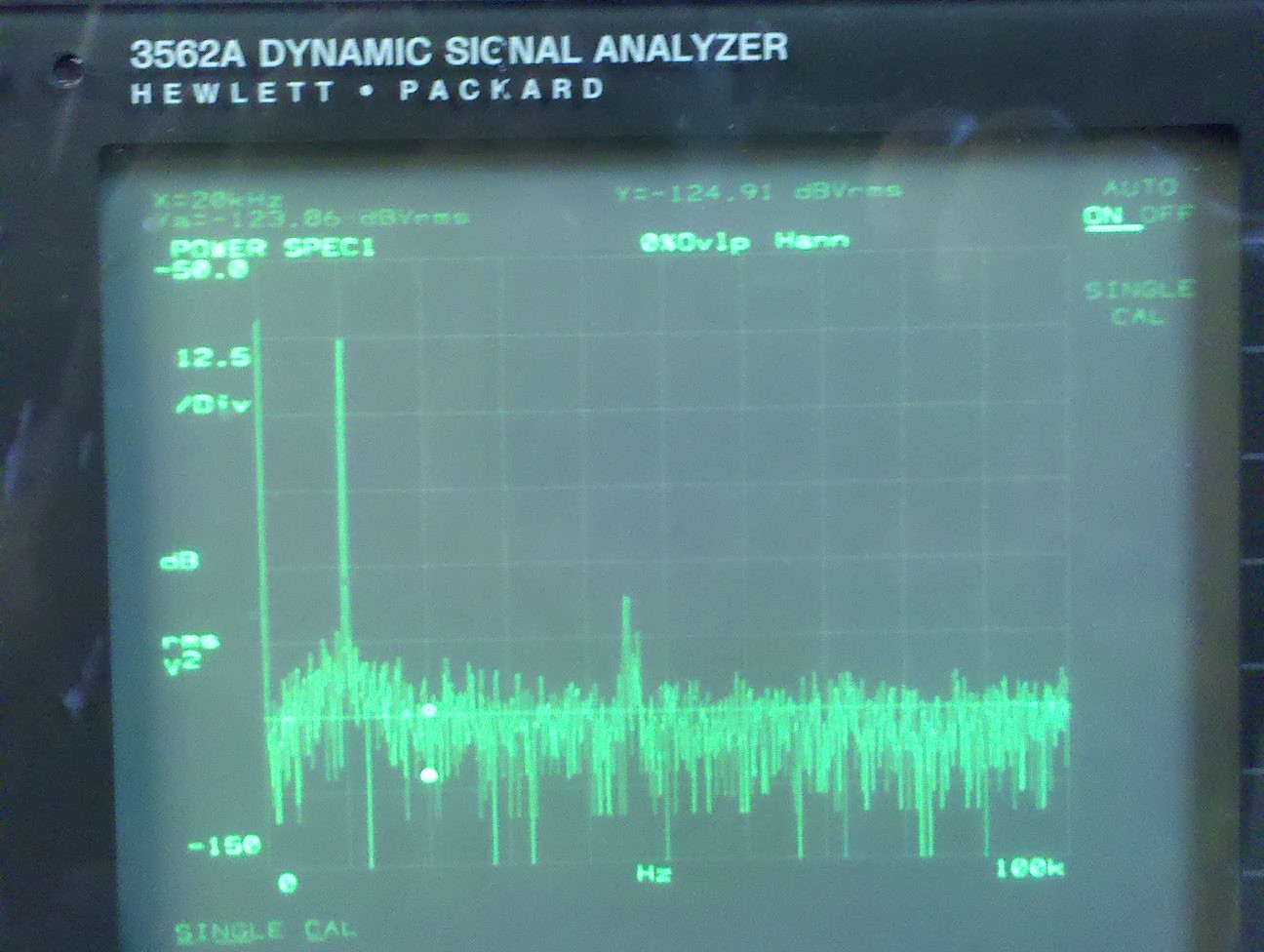

The second photo is the same signal through the Twin -T. You'll see a round circle on the fundamental, it's the marker that displays in the upper left corner - in this instance the null was -77.393db at 10kHz. The horizontal line at approx. -125db (-124.97) was placed by me to represent the noise floor of the analyzer. The second harmonic is at about -103db, the third at about -118db. The spikes at 45kHz are either from the florescent lights or my smart electric meter. I'm pretty confident that this image represents the harmonic profile of the HP8903A signal.
I also tested the slope of the notch by tuning the filter to -80db at 10kHz then feeding it an 11kHz, through 20kHz signal in 1k increments. By 16kHz the notch was not changing the value of the fundamental.

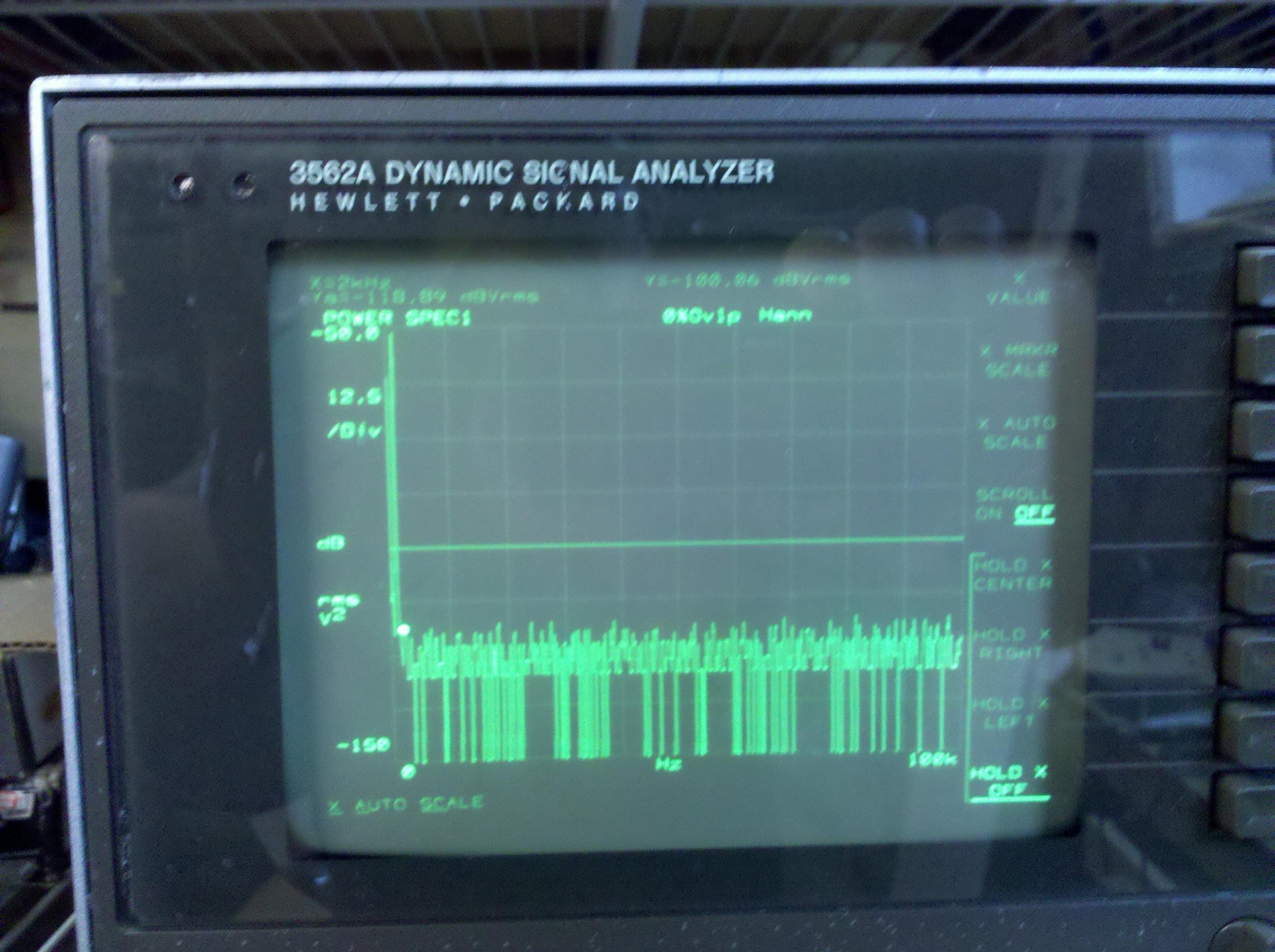

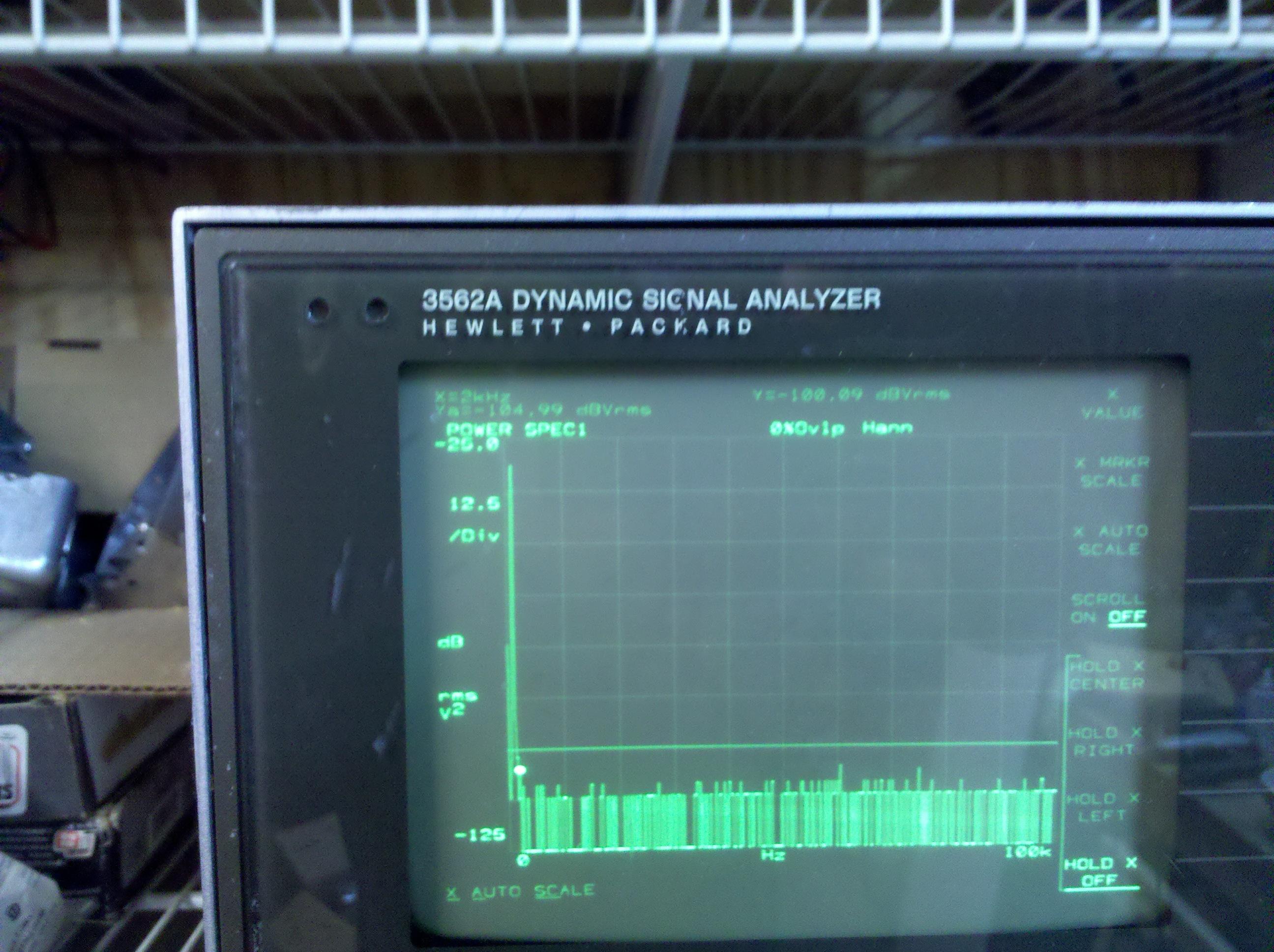

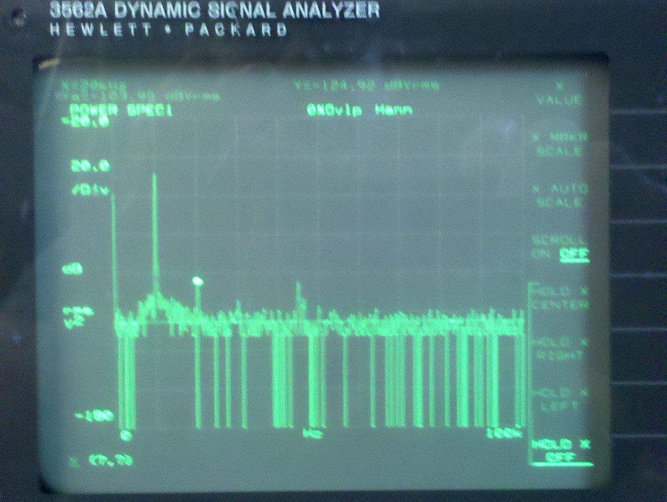

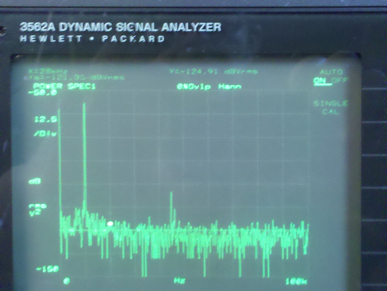

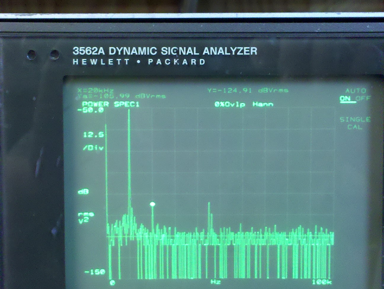

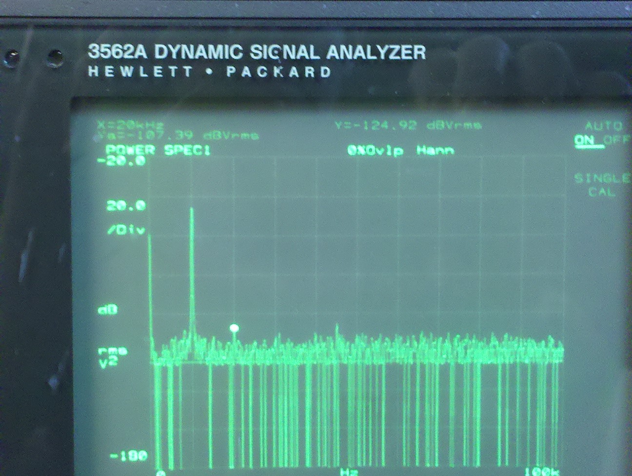

I ran a series of tests, seems the 2nd H varies with the output voltage of the 8903A.
Note that the device is set on auto scale, so, the images jumps around a bit. There is a way to set the upper/lower range, but, I made these images before work today and more importantly, before coffee.
First, I re-ran the 10kHz tests. All voltages are rms. Images as follows:
1. 0.5v 2nd H -103db
2. 0.1v 2nd H -123 (bouncing in the noise floor)
3. 0.2v 2nd H -121
4. 0.3v 2nd H -102
5. 0.4v 2nd H -106
6. 0.6v 2nd H -116
7. 0.7v 2nd H -107
I'll post the 1k results in the next.
Ken

I couldn't get as deep of a null, but, it didn't effect the results. I think that I am going to move the three trimmers to the top of the box for external adjustment as well.

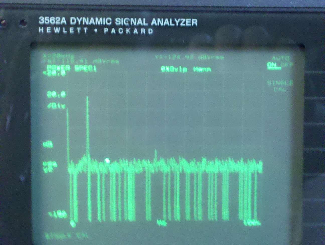

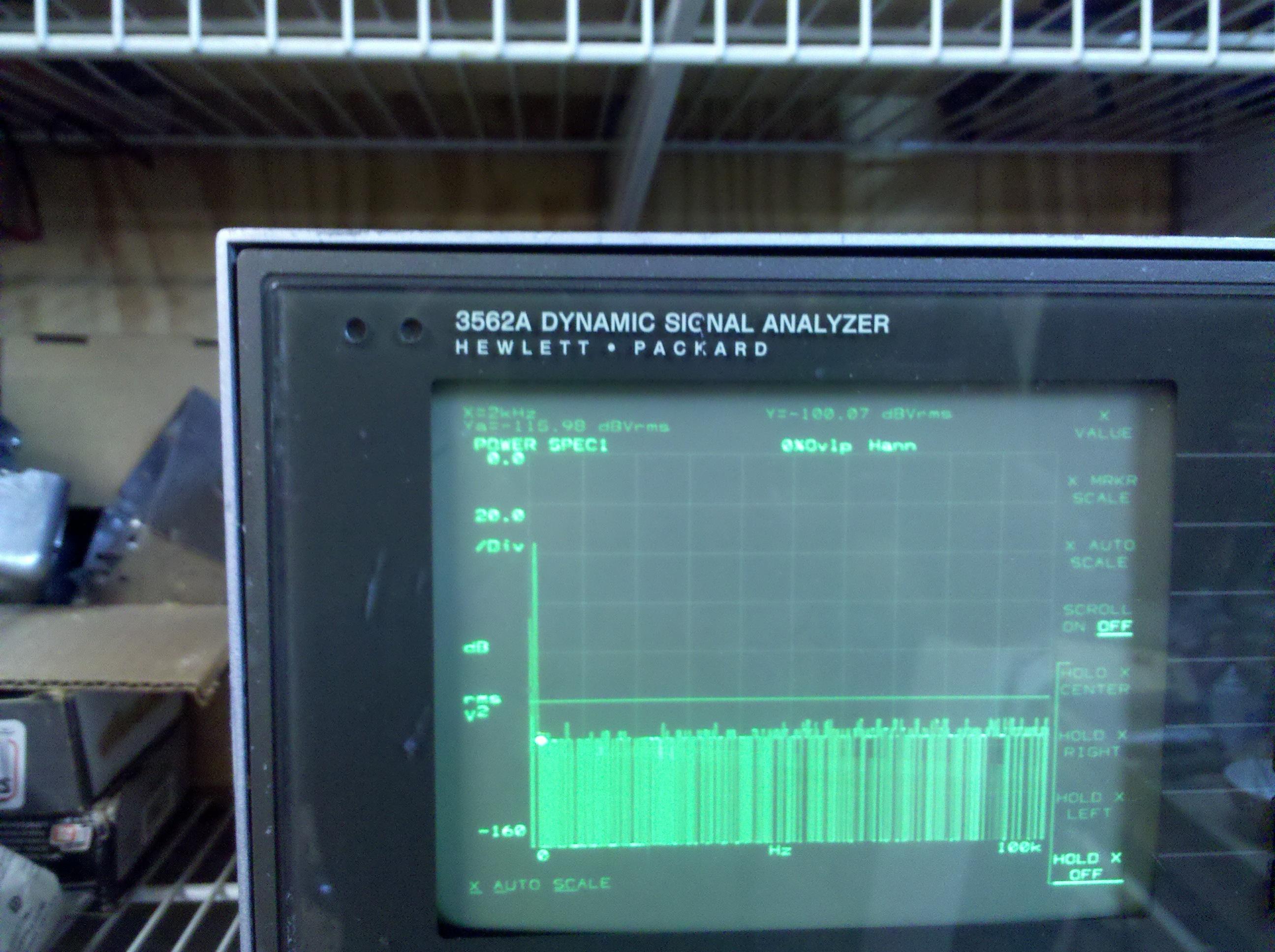

Here are the 1kHz results:
Image:
1. 0.5v 2nd H -100db
2. 0.1v 2nd H -118
3. 0.2v 2nd H -112
4. 0.3v 2nd H -108
5. 0.4v 2nd H -104
6. 0.6v 2nd H -116
7. 0.7v 2nd H -108
8. 1.0v 2nd H -105
I found a Krohn Hite 4402b Oscillator on ebay last week. Hopefully it will arrive before the weekend. I'll post results for it as well.
Ken
