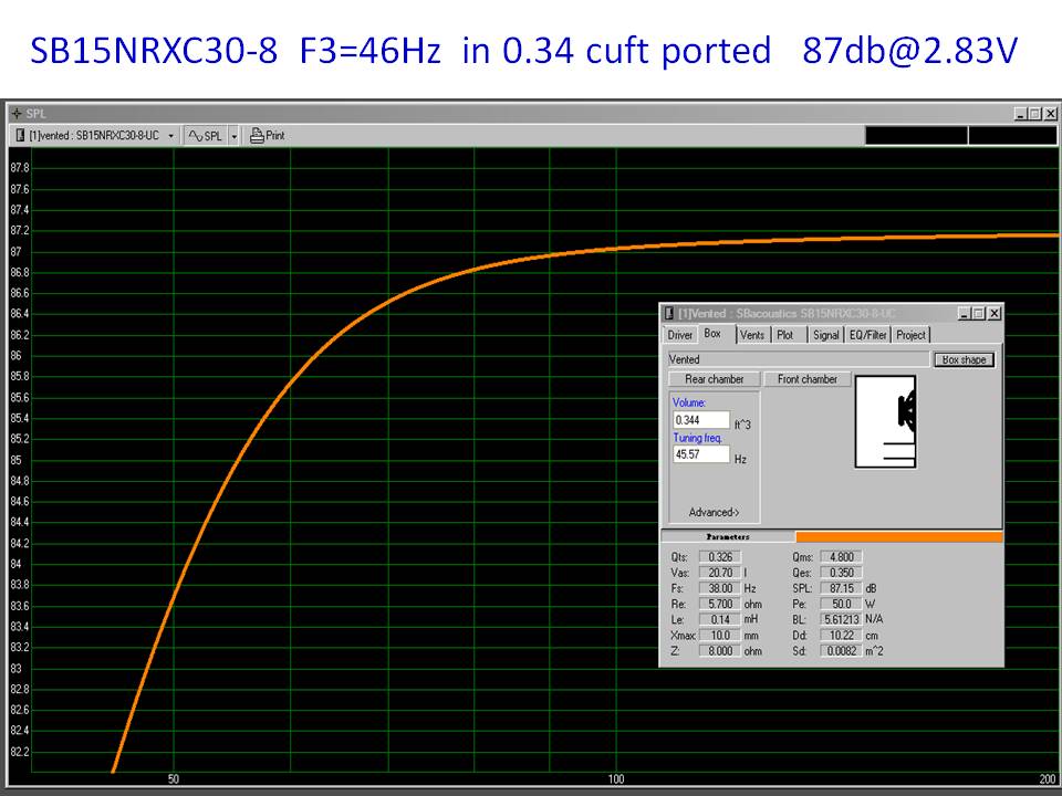

=========Simple passive Xover T-M

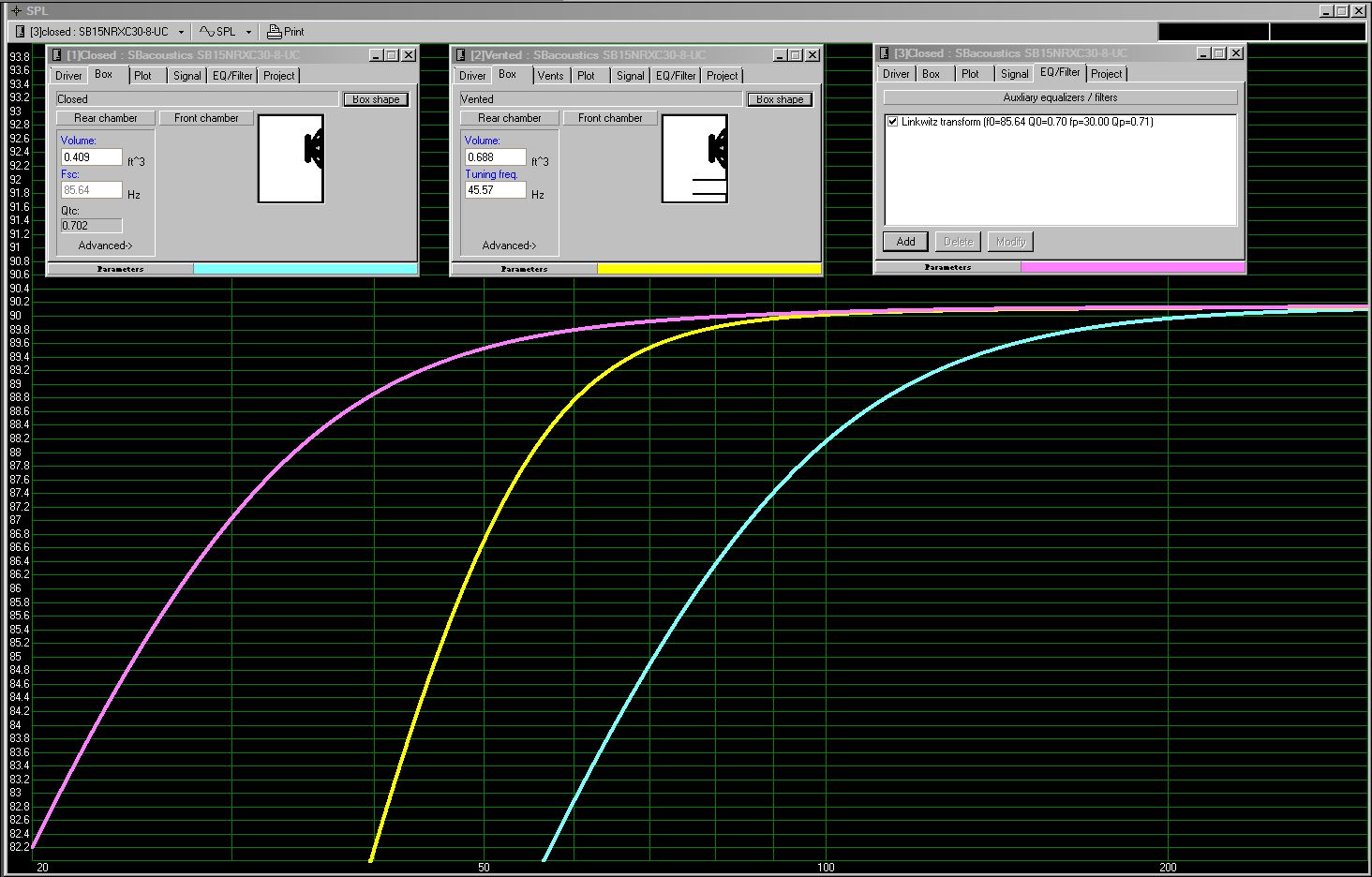

For diyAudio, this SBacoustic TM will reach down to 50Hz in a ported cabinet. 5" midrange == 7" wide box. Several port placements.
$33___1" Tweeter SB26STCN-C000-4
$53___5" Midrange SB15NRXC30-8
++Small 3-way with side woofer.
The SB15 can be put into a small sealed volume if a woofer is added.
Woofer...there several 6" and 7" options...
Small sealed box volume possible with active equalization. Like BareFoot.
(lower cost...SBAcoustics $25 SB16PFC25-8 6" Paper Cone Woofer)
(lower cost...SBAcoustics $20 SB19ST-C000-4 dome tweeter Fs=980Hz)
(higher cost...Seas 5"-6.5" coaxial ... used KEF Q100 speaker on eBay)

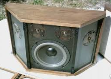

Acoustic Research produced a tidy small wallmounter called the MST below. It's actually only about 10L volume. Also one of my low bafflestep (1mH coil) wallmounting 8" designs, maybe not quite what you are looking for, but a substantial bottom end. I quite fancy doing an MST variant on that.

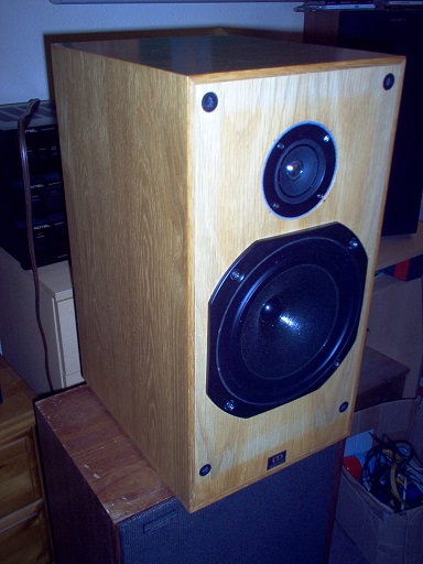

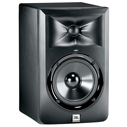

Putting the dome tweeter in a waveguide like the JBL AC15 does can help "aim" the sound stage toward the listener from a 2.2m high shelf. BUT it also increases the box height, so only you can judge the fit. The JBL AC15 gets good reviews. For diy, there are modest cost waveguides which fit standard low cost dome tweeters.
Common wisdom:
-try to put the speaker at seated ear level ~36"-42".
-If the speaker stays up at 2.2m, try to fit the height a tweeter waveguide plus a 5" midbass into your shelf.
-If you need deep bass and cannot add a 60-80Hz shared woofer, an equalized 6" side woofer on these speakers can be successful, even when near walls. You could develop a plan which adds these side woofers when more money is available. The Barefoot Company's MicroMain 35 monitor uses advanced electronics to "sound big".

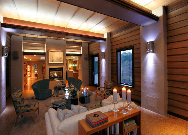

Some ideas, free or nearly so:
If you choose to design your own speakers, or just have fun, there are many programs for the PC (Mac too maybe?) that are free. I use Hornresp. Others are Akabak and [????]. These let you model and ask "what-if" questions without ever buying or building anything 🙂
Another suggestion, is to build prototype speakers. Xrk971 here is the master of building speakers out of foamcore (foam board). I do something similar, using plastic advertising signs (coroplast). Cardboard can also be used. This is perfect for smaller speakers (probably like yours you are creating). Even with my fast and sloppy builds, I get decent performance making small horn speakers. Are they perfect? No of course not. But I can build one in an hour (+ glue drying time.) The glue costs more than my raw materials 🙂
I've not done this, but some people like speakers built into the walls or ceiling. This would be unusual for you if you are in Europe since (1) you are not likely to own your home and (2) the wall is probably made of concrete or stone, not flimsy wood or gypsum board like here in the USA 🙄
There are so many options; my last suggestion (in this post!) is to read up on al the options you have, and you have a huge amount, even with your Euro 150 budget. Maybe spend it on drivers, mount them in a cardboard box, and worry about a wood cabinet later 😀

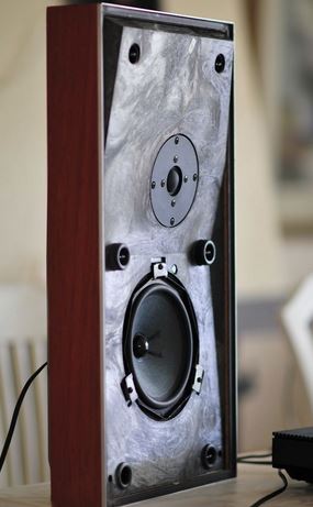

It's really an interesting idea, this wallmounter.
Bang and Olufsen did this sort of thing. Like the B&O P30, the wallmounting version of the S30. It came with mounting brackets on the back.
It even has a suitable down-firing tweeter for 2.2m high mounting.
Joe Rasmussen's "Elsinore" Peerless 830875 and 830874 would be suitable. Some adaptation required for single midbass, but just technique. Halve the coils and resistors, double the capacitors. FWIW, designed for a waveguide tweeter as dynomike likes, but that is optional IMO.
Elsinore Nomex Drivers
Being a wall mounter, with 6dB gain at the bottom, you don't need the bass, just the midbass. The Classix II might be a bit bassy IMO. It's a standmounter.
I have seen flush wallmounters with the entire wall covered in 2" rockwool except a waveguide cutout for the drivers, but that may be mission creep... certainly no Wife Approval Factor there!
