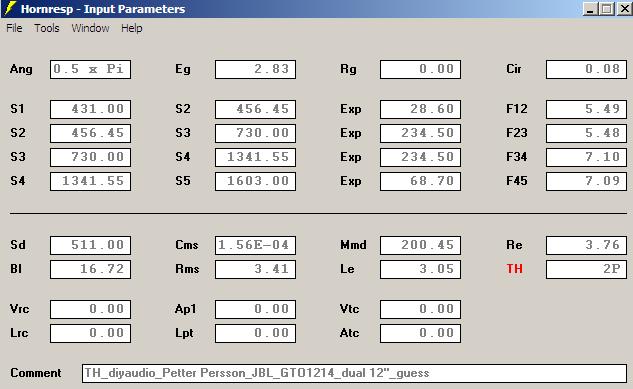

Drivers can handle 350W RMS/piece (700W total) 14 mm X-Max
Model JBL GTO1214
Net volume is 500 liter.
Simulated for corner placement, 2,83V, driers in parallell. 135 dB @ 20 Hz.
Braced with 12 mm plywood/MDF, as image below
Internal dimensions, materialthickness 22 mm

you could probably flatten out the higher spl response by flaring out the mouth,
No, just increase the high freq. sensitivity on cost of low end sensitivity.
but then you would not have a nice rectangle dimension.
Yes, thats true. This box design is made to be as flat as possible and to just fit on a standard 120x240 cm sheet to maximise acoustic output compared to the material used.
i bet the distortion would increase as volume does with that port shape as well.
Why? Plese explain. At these waewlengts, i can't see why...

Aha, okej, then I understand better. A larger mouth creates a better coupling
between the air in the horn and the surrounding air and reduces air speeed in
the mouth region. The mouth area in this horn is 1625 cm2, about three times
the SD, so it's pretty large any way...As you mentioned, a larger mouth would
not fit in the desiered outer dimensions.
A larger mouth also lowers the q at the res. freq. and then lowers the group
delay, giving a more tight "musical" sound on cost of efficiency/box volume though.

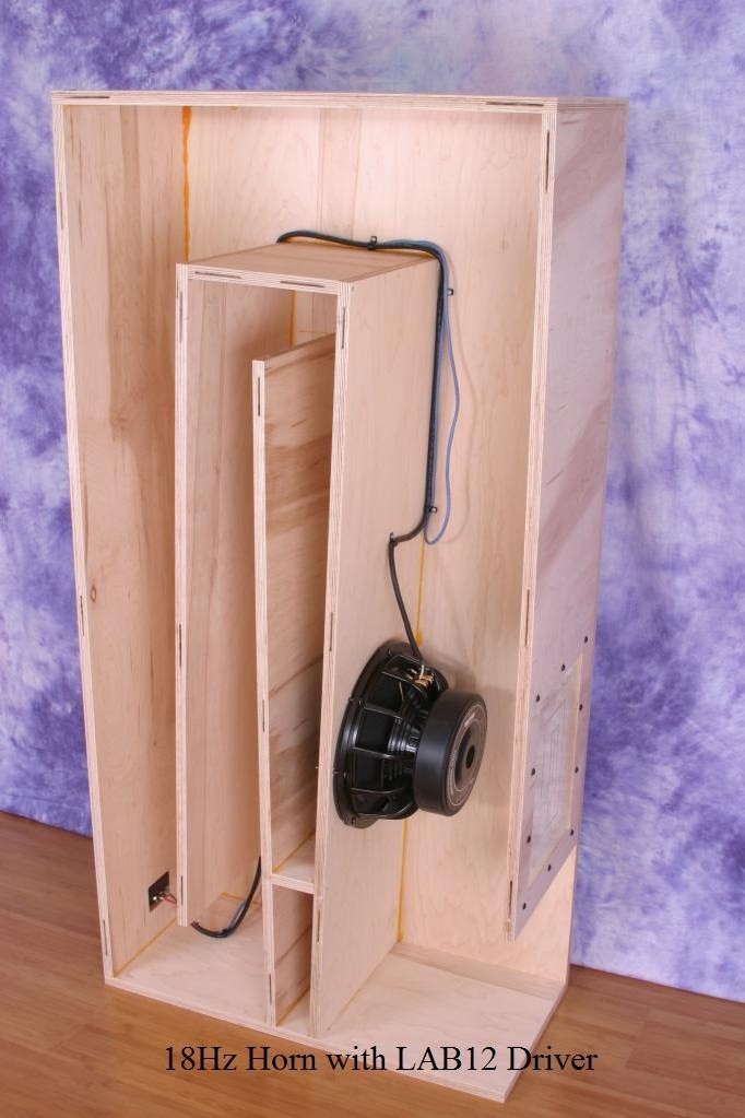

Hello Petter,
I really like the footprint of your design. Would it be possible to alter the port location? If so, I'd consider building this as part of a riser for my second row seating if I could get the bass firing out of the front of the riser.

Here's a similar TH that has been built & tested using the lab12 from eminence. Changing the direction of output is a simple
modification on most tapped horns.
