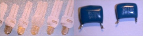

Like everybody else I started my projectordesign with a halogen bulb, but found out that it was too hot and didn´t give the light output I wanted. So I started looking for HID-bulbs. I found a lot of them in disco-equipmentshops, but to find a ballast, was much harder. So I figured out that a fluorescent-ballast works in the same way a hid-ballast works, you just need more powerful ones. I did a electronic simulation in the computer with parallel 36W ballasts and it gave right voltage and current for the lamp I was going to buy. So I bought a Philips cdm-t 150W bulb and tested my design and it works very well. The best part is that it´s very cheap only $25. I have used this ballastdesign now for 2 months and it still works very good.

The ballast get´s pretty hot but thats normal. I haven´t measured the temp but I think my gets 60 + 20 (temp in the room) = 80 degrees, according to the ballast manufacturer.By the way, tw130 means that the winding in the ballast can run 130 degrees hot for 10 years.
If you want to be sure the ballast works and gives the right voltage and current, you can test it with 3 200W normal bulbs for 230 Volt, that is equal to a 96V 150W bulb. You can use this design for 250W hid bulbs, but you need other values on the ballasts and the voltage and current will be diffrent.
Aww jeez 🙄 , I just figured out what a "Condensator" is, I kept looking at the symbol and I'm like that LOOKS like a capacitor, and it has a rating in fahrrads, but I've been trying to look up what a condensator is for a while now
.... So for the english speakers like myself, yes those are Capacitors.
Yes, Condensator is actually Capacitor, I´m sorry for my spelling. I know it´s hard to find a 18 uF / ~300V capacitor, but you don´t need it. But without it, your electricbill will be more expensive.
I don´t think I need to supply any caps, they are pretty easy to find. You can find the 2.2nF capacitor in small fluorescent-lamp, broken powersupplys for computers and in many other things. It doesn´t have to be exactly 2.2nF, I use 3.3nF.
