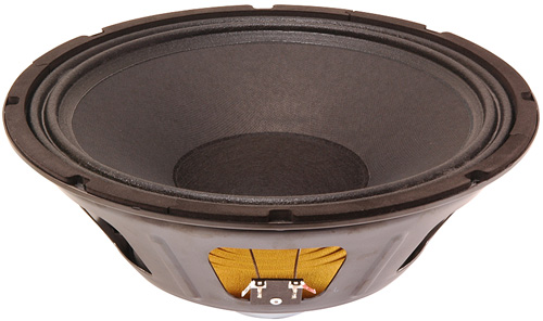

So this is what I have to work with:
An Infiniti Reference Series 12inch Automotive Subwoofer Model# 1230W. It has power handling of 1200W peak power, and 300W RMS.
Also, I have a Rampage by Audiovox AMP-592C 200 Watt Stereo Power Amplifier that runs off 12 volts D.C. (I don't know if I can use this at all for this project.)
I originally had it in my last car, however, it has been sitting in my garage in a custom enclosure for a LONG time because the original setup never really worked well.
Either way, I would love to make a bass amplifier out of it if possible. This would be my first custom amp project and I honestly have no idea of where to start. It is a solid state speaker so I think I will stick with a SS amp for ease of build and ease on my wallet. Also, I will build a custom enclosure for this project.
Anybody have ANY ideas?

John:
Are we talking about a Bass amp as in a Bass guitar??
First off Bass guitar amps are by and large driven by tubes. There are a zillion reasons why tubes are used in this application but I won't get into that right now.
I would think your best approach would be to get that amp up & running so you can see where you might go with it...& to experiment with. Besides having a high power 12VDC supply is nice to have for any other "car" equipment.
Your choices are a "linear" PS or the 'new' generations of Switched Mode Power Supply....or SMPS. While SMPS' are quite the rage now, old-style linear supplies have their merits as well.
Check the fuse rating on your amp & start looking for a 12VDC SMPS for that rating. SMPS' are really kinda cheap & I think it would be your best bet at this stage.

Rick,
Thanks for the input. Yes, I am talking about building a Bass guitar amplifier. I did some more research into the parts that I have and I have determined that I would need a higher power amplifier for that Infinity speaker because I would need some additional speakers in the enclosure to have a broader frequency response. Here are the specs of the speaker:
12" 4-ohm subwoofer
polypropylene cone with rubber surround
deep-draw I-beam basket
70-ounce magnet structure
recommended power range: 50-300 watts RMS (1,200 watts peak power)

John,
You do have more than enough power with that amp.quite literally to rock the house down.....Here ya go, Most "bass guitar" speakers are WAY more efficient than your car drivers...Look up Parts-Express.com - Speakers, Speaker Building, Home Audio and Video, Pro Audio, Electronic Parts & Accessories PARTS EXPRESS, Speakers, Speaker Parts, Guitar speakers, Bass speakers, Woofers, Drivers, speaker upgrades and replacement speakers. Emine & select 12" "Bass guitar speakers"
Your could run a stack of four 12" babies in a basic open back enclosure...& with that kinda power really get on the bad side of your neighbors!
Yes indeed your car drivers are not suited for musical work.
Keep lookin' for your PS module & let us know which you select...& we'll talk about it.

Again, I am trying to get away as cheap as possible. I know this typically limits projects a great deal...but this is also half the fun!
Even if it only cost you $20 if the amp can't do the job that is $20 wasted.
First off a bass guitar, assuming here it is a four string and you use standadrd tuning, has a rage of about 40Hz to 8KHz. There is no need to handle aything outside that range.
The nest thing to know is that a guitar amp is ANYTHING BUT a HiFi. You design them intentionally to distort just a little. Bass amps are cleaner than guitar amps. But still they "color" the sound.
Much of that color comes from your choise of speaker. A lot of them are mid scooped to kill the mids (kind of anti-hifi)
That sub woofer that goes from 20Hz to 400 would be a disaster because you have to crossit over right at about middle C or just below. NEVER d a speaker crossover right in the middle of an instrument's range. You have a pretty noticable change in tinbre right thee at the first note above the bass cleff.
Get a speaker that can do the job.
OK go one? now you can figure out how big the amp needs to be. Contrary to what was said today many bas players use SS amps simply because a 500W tube amp is a monster. You can use any very clean and powerfull SS amp you have. Look at the RMS watts and go for about 250W.
