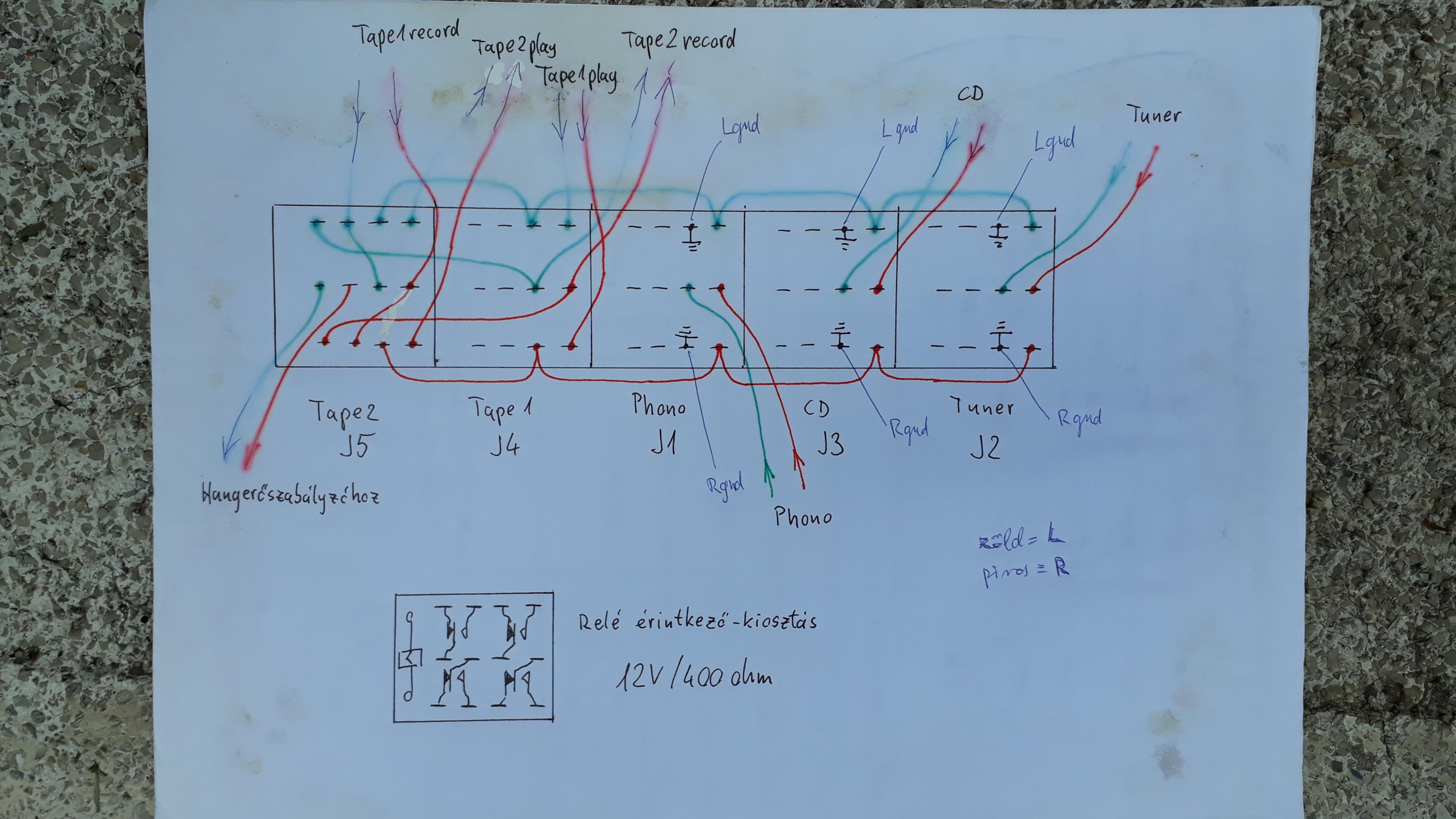

Here is my solution. Input grounds of L are on a bus, same for R on a separate bus. Output grounds come from the active circuit, also separate L and R GND. Phono GND is also separate. Hangerőszabályzóhoz = to volume control.
