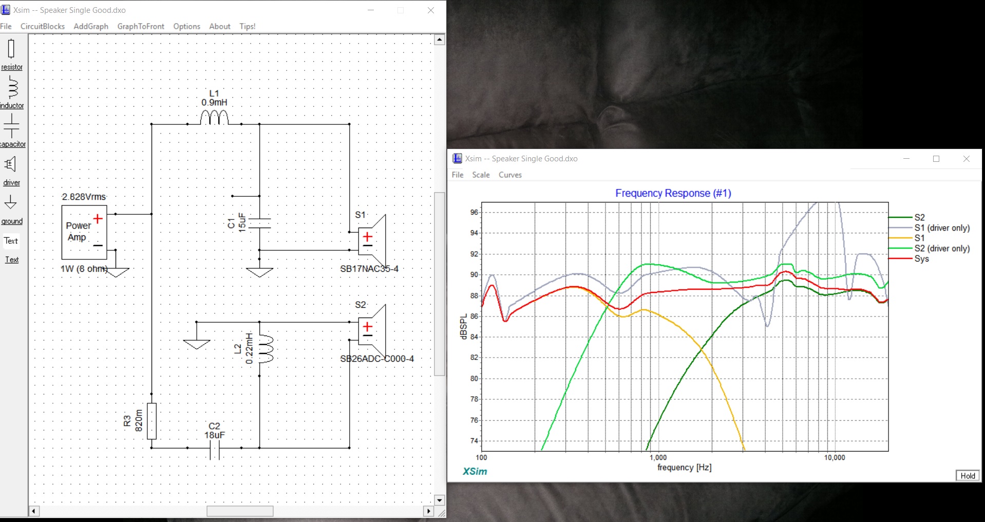

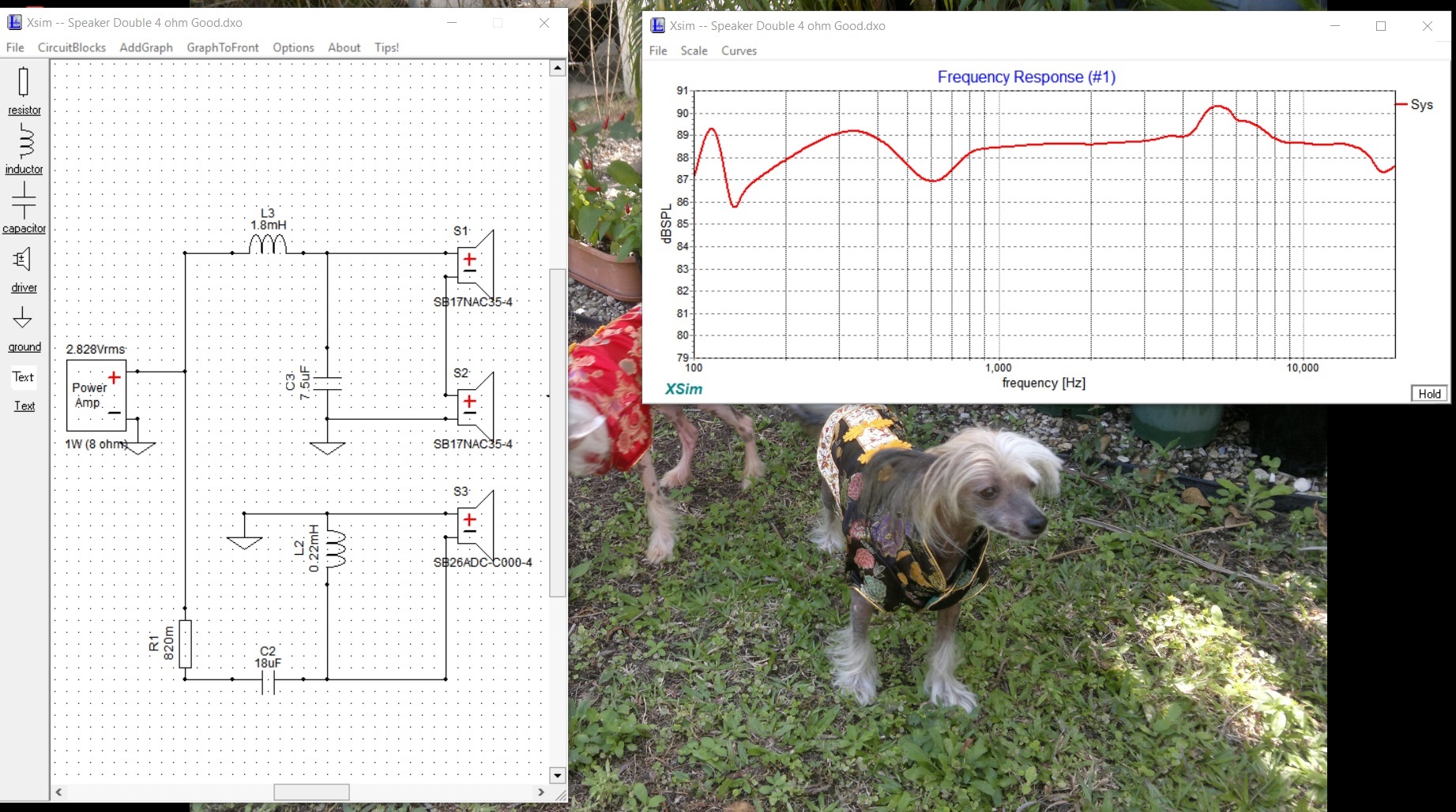

I've been playing around with the Xsim program but without actual .frd and .zma files, I've had to try to make my own from the response and impedance charts. I've managed to simulate quite a flat response using a 2nd order crossover (red line on the attached image). It crosses at 1800 hz. Is this too low? I don't plan on very high volumes but don't want to burn out the tweeters.
Does anyone have these files or know where I can get the .frd and .zma files for these drivers? The Anthem receiver comes with a microphone for the room correction. Is there a piece of (free) software around that I can use to make my own files once I buy the drivers?

I'm also in process of building SB 61-NAC.
I've read carefully the Troels Gravesen design on his website. He has provided pics of the frequency response of both drivers measured in speaker boxes.
You can trace them and create the .frd files.
The crossover
I added the frd files in VituixCAD
Don't forget to offset the tweeter by -19mm as Troels recommended if you going to follow his design.
Take a look carefully the crossover photos on the same page.
L3 coil - 13 layers x 17 winds ~= 1mH (Jentzen 000-0018)
L5 coil is labelled as Jentzen 000-0009 which is 0.39mH
L1 coil is labelled with marker ...15. I suspect it is unwinded from a coil with greater inductance.
Having the inductances is a good starting point to unveil the whole crossover schematic.
The tweeter network contains two caps one of them larger than the other. The smaller one should be 10 or 12uF, as the larger is 15, 18 or 22uF according Jentzen specsheet. I played with the different values and C1=12uF and C7=18uF gave me a closer match to desired slope.
In the woofer network capacitance includes multiple caps. The best result I got with values of C8~16-17uF and C3~13uF.
The resistors values are R1 (tweeter attenuation)- 1.5 to 2.7 and R4 is around 1 ohm. For R4 I used R1.2 and it works well.
Troels has provided very detailed information about his design even w/o the component values. Seems that everything you needed has been in the front of your eyes
Hope that info was helpful for you.
