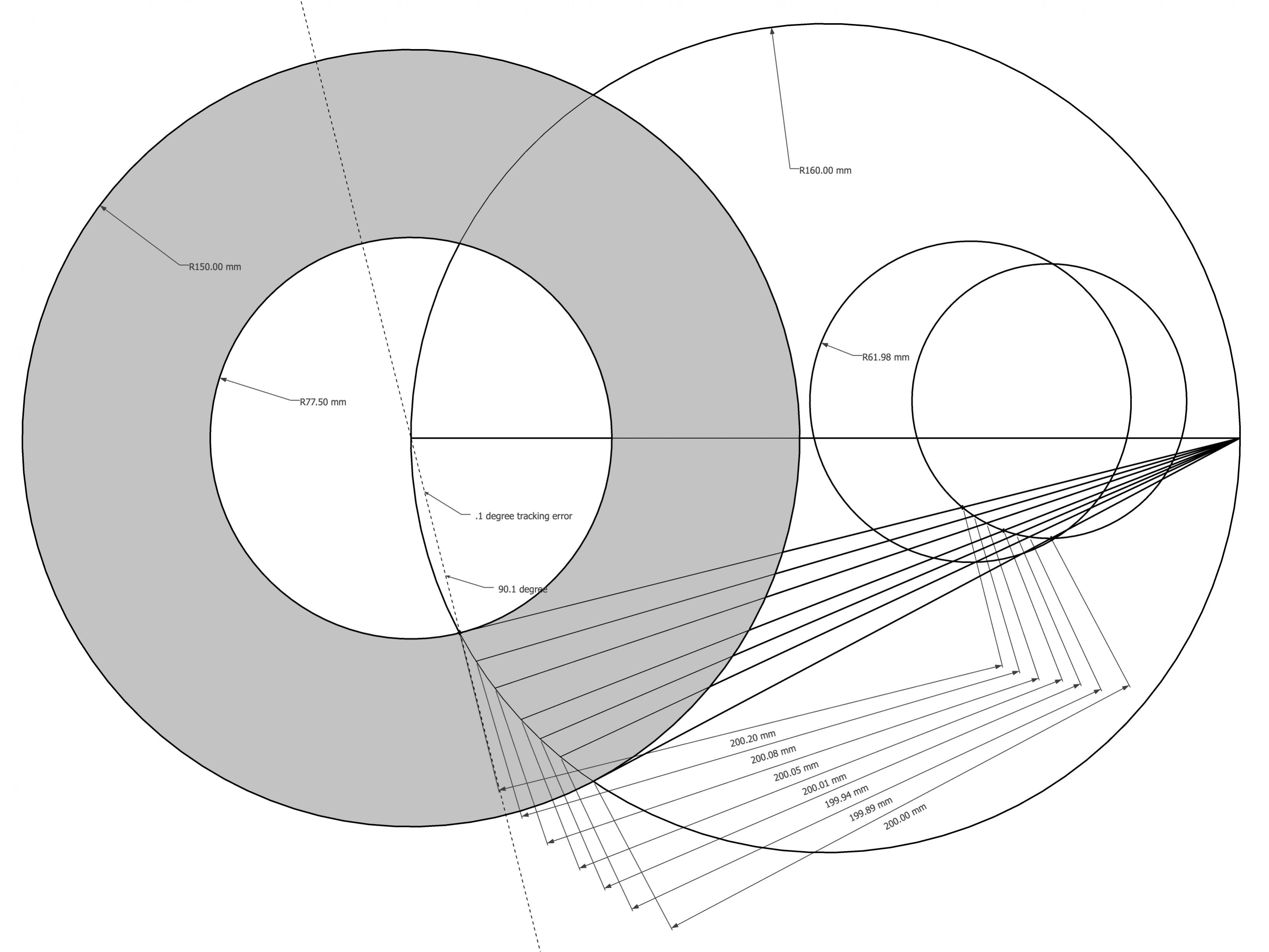

I have been studying Reed 5A and trying to design my own building plan. After many different versions of the design, I finally came up with the version I think has the smallest tracking errors. I would like to prompt criticisms and suggestions before I start to build. There are two things I paid a great deal of attention to. First, I concentrated in the playable area only. Please see the gray area in the diagram. Secondly, I tried to minimize the tracking errors.
The purpose to build a clone of Reed 5A is to approve that a tangential tracking pivot arm based on Birch geometry won’t skate. I intend to build a fully working arm without actual wiring. If one day, all of a sudden, I have eager to listen to this arm, I can simply wire the arm up and have a listen.
In theory, Birch geometry is not perfect. Therefore, there are some small tracking errors. As long as the tracking error exists, it means that side force exists. But in reality, such side forces are so small that they are not strong enough to cause arm skating. So, an arm based on Birch geometry won’t skate in reality. This is all I care about. For my arm, the largest tracking error is 0.1 degrees. In the diagram, the largest tracking error exists the most inner groove. If in actual use, I can align the arm so that the largest tracking error will be on the most outer groove since it is easy to play the most outer groove. Please see the diagram for tracking error analysis.
Comparing Reed 5A with my design, I think my arm has less tracking errors than Reed 5A. Of course, I can be wrong since I don’t have the data for Reed 5A. All the analyses are based on the screen catch from the video of Reed 5A.

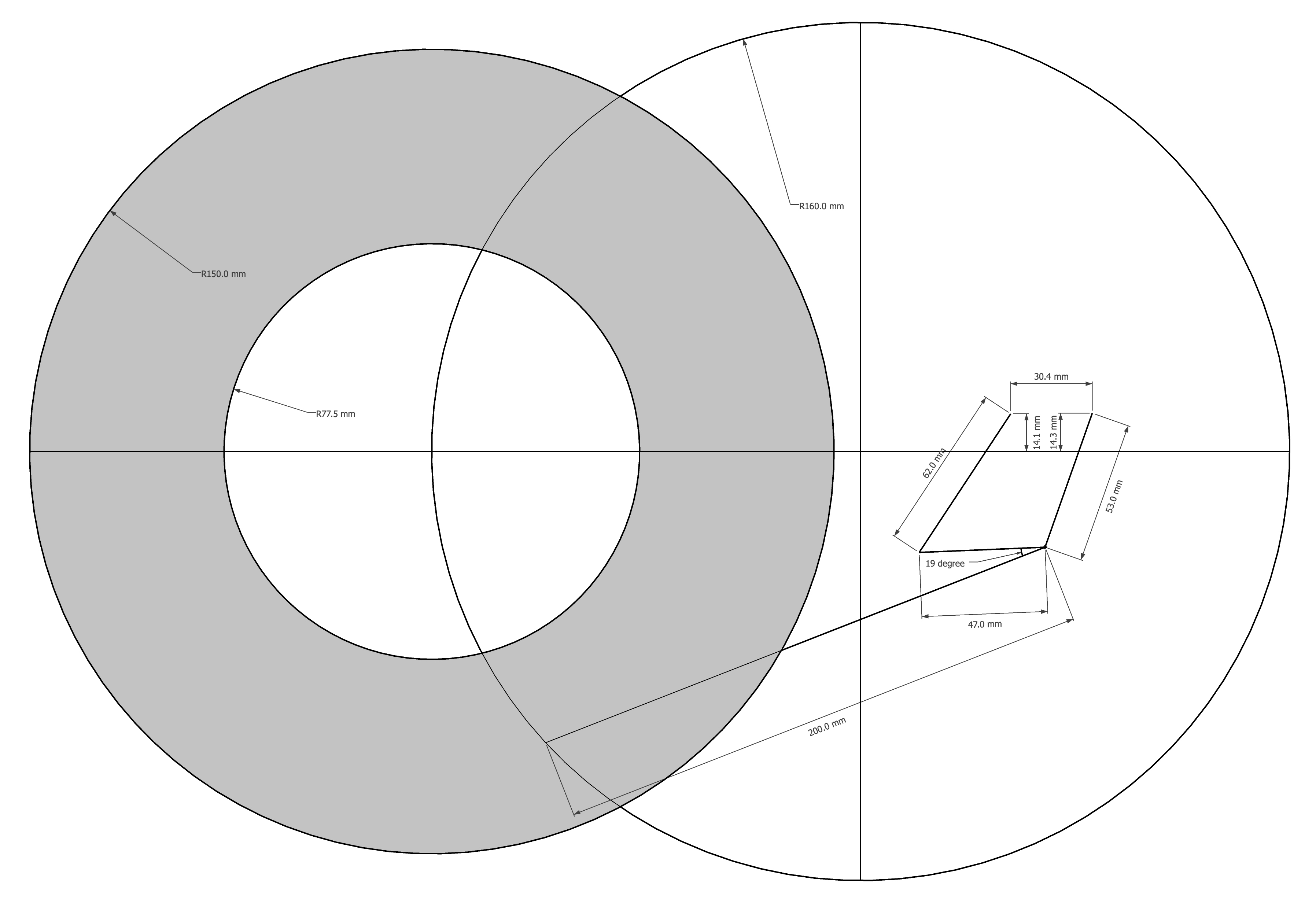

You are 100% right. What I said was based on the following skating diagram and it was specifically referring to Birch geometry tonearm. Even for Birch geometry arms, tracking error is not the cause of skating. But tracking error and skating must co-exist. This was why I said as long as the tracking error exists, it means that the side force exists.
![](https://live.staticflickr.com/65535/51275666127_7856fd0c6a_z.jpg)
1 pivot vs 2 pivots
When you did your test for that diagram you did it with a non-offset single fixed pivot tonearm. You moved the pivot point incrementally and charted your diagram so essentially you were doing what a servo would be doing. Don't forget all Birch style tonearm has TWO horizontal pivot points. And no matter how tangentially accurate you make it to be there is always that extra pivot to deal with which is not in line with the Thales segments, the bête noire of this whole debate. Well, your Reed 5A clone will eventually test it properly so I look forward to your finding.
https://flic.kr/p/2m84c86
I understand you very clearly. We all agree that a single-pivot tonearm with no offset will not skate on Thales circle. The key difference we have is for the multi-pivot tonearm with no offset. I think it makes no difference and it won't skate on Thales circle. While you think multi-pivot does make difference. A multi-pivot tonearm will skate even on Thales circle. Let's see what the test tells us.
But there is an offset. The moving pivot is the offset.
But there is an offset. The moving pivot (1B1, 1B2, 1B3) is the offset. And 1P2 is the main fixed pivot. So you can think of the black line from A3 to 1B3 as a long headshell that Hiten referred to in the other thread.

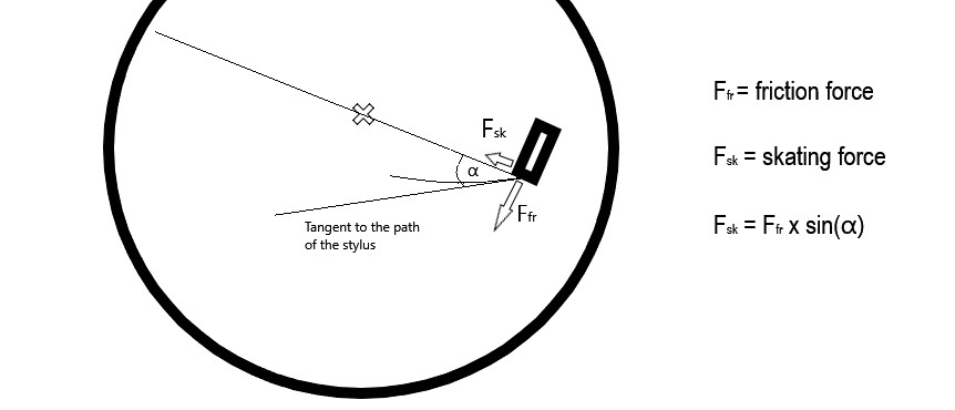

This is a generalized formula for the skating force, it does not depend on the realization of the tonearm:
This is exactly what I think. The model does match my skating diagram perfectly.
On second thought, your model refers to the tonearm doesn't have an overhang. It doesn't apply to a regular tonearm that has an overhang. When, sin 90=1, i.e. at the null. Fsk is not equal to Ffr. The arm skates.
When sin (90) = 1, Fsk IS equal to Ffr. They overlap.
I But for a tonearm that has overhang, the tonearm does skate at null, ie, sin 90=1. Therefore, Fsk must not be equal to Ffr.
Yes, it will skate, because the path of the stylus will be orthogonal to the line to the spindle, i. e. the friction force will be equal to the skating force.
As predicted by my formula.
