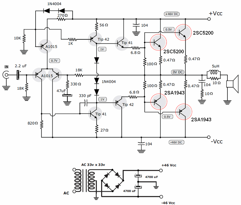

Helo friends I am building class Ab Amp using this schematic Do i need some changes for better performance?

Hi Zohaib
I am a little bit concerned about the bias-configuration:
You have 2 diodes drop plus the voltage over R7 compared to 3 base-emitter drops though the output stage.
This may - depending on the exact characteristics of the the 1N1007's and the base-emitter of Q1, Q3 and Q4 - give you a very low idle current.
So low in fact that cross-over distortion could give you problems.
You may consider adding a diode and a trimpot across all the diodes for idle current adjustment.
Cheers, Martin

This looks like a circuit not to be built, but one to teach the basics of an amplifier. It's performance would not be very good. Will it amplify? probably.
Have you simulated this in SPICE?
Have you read Self and Cordell?
Have you analyzed other well understood schematics?
No RF filter in input
IPS, no current mirror, no constant current source
VAS, no Constant current source
Fixed bias, no thermal compensation
Severally limiting voltage to the IPS.VAS. Excessive rail resistors
No adjustment for DC offset
Questionable compensation methods
Very poor PSRR
No protection circuits, DC, power, thermal...
No muting
Why the small power supply cap on the negative rail?
1N4007 may not be the quietest diode choice
100W through only one output pair? Not a good choice by far.
Why are R15 and R11 not the same.
So, yes many many changes for quality. How much power you want is up to you.
You have also not included the power supply nor anything on the physical layout and construction which can have large effects on the quality.

Thanks For Huge Explanation Yes You Are Right This Is Not A Good Circuit For Build. There are Lot Of Changes To Do with This Schematic.This looks like a circuit not to be built, but one to teach the basics of an amplifier. It's performance would not be very good. Will it amplify? probably.

I Am Using 35v AC Transformer with it...

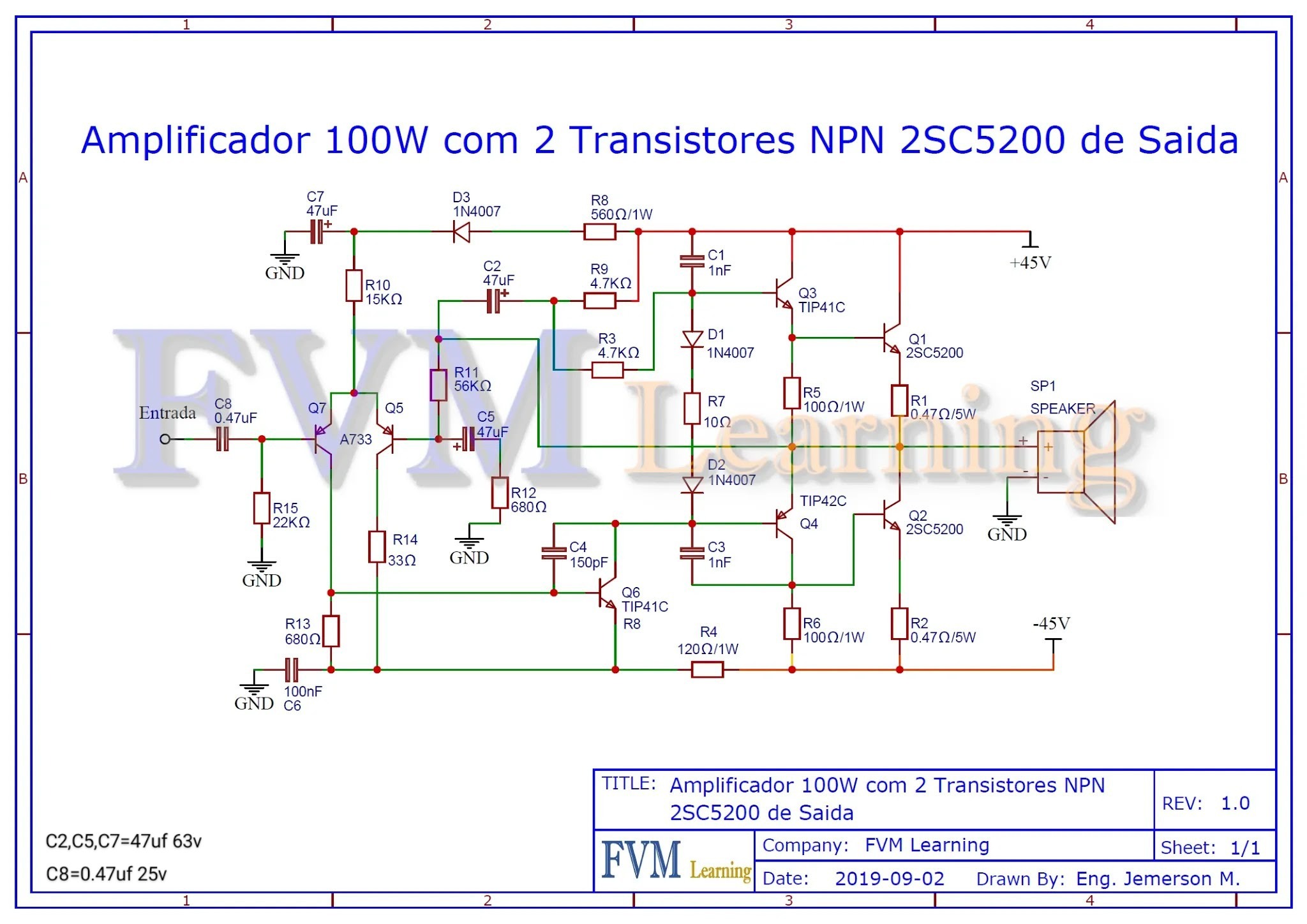

Thanks For Reply Martin I Have Not Design This Circuit My Self I Just Want To Make npn outout transistor amplifier So I Just Download It From Internet I Think This Is very Poorly Design Shematic With fixed Bias..Hi Zohaib

Can You modify It For me With diodes and Trim port For Perfect Output with Good Sound Quality I am Using 35v AC TransformerHi Zohaib

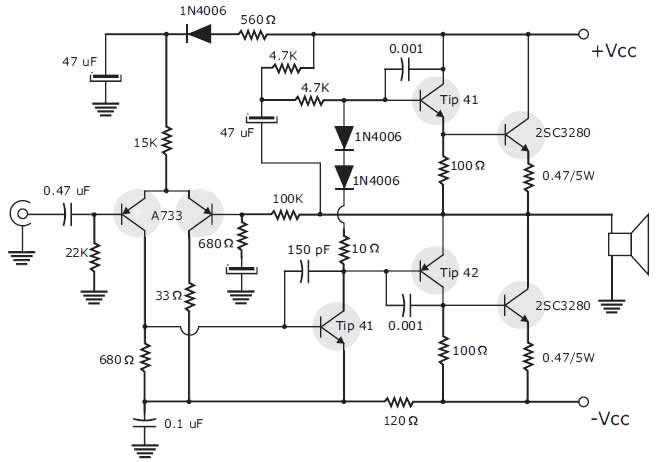

I don't think that is a lot better, Zohaib. Several points to think about:
1. No obvious need for 33 ohm on right side of input pair.
2. No emitter degeneration on input pair- this pushes the high frequency response up, needing a big compensation capacitor (150pF ios getting on a bit) and leading to generally poor slew rates.
3. You have been advised to think about the bias. The circuit is far from optimum. You need to considerone of three options :
4. The two diode and resistor bias is so old hat and should be replaced by a Vbe multiplier, preferably with a pot to adjust the bias.
5. TIP42/43 are not good drives IMHO. They are ~3MHz and are better suited as low/medium power output devices.
6. The 2SC3280's are fast devices and are better driven with faster drivers.
You may have some problems stabilising a fast driver and fast output stage in the PNP/NPN configuration, which could require base stopper resistors but you have got stopper capacitors in your diagram.
My recommendation is to read Self's Blameless design and adapt that for NPN only output.

Yes, your second "version" is a bit better. But, do you understand why each change may be better?
There are many ways to get something done. The actually smart folks I mention all have slightly different approaches. Even me, with my very limited experience, have my preferences. For example, I tend to like MOSFET outputs.

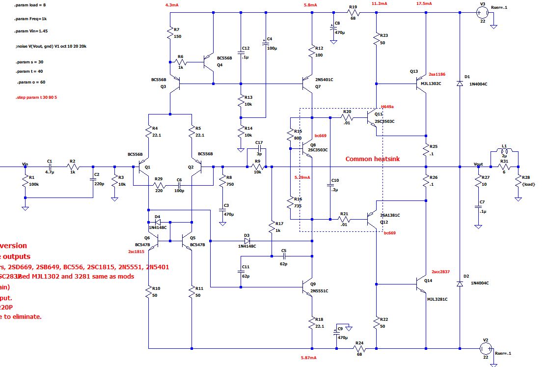

Here is one I was playing with when I was first learning. Not finished and I have even more "hindsight" and would change it quite bit if I were to build one. (no claims if it would actually work, so do not build it!) But it is a fairly strait forward design covering the basics. You can also find schematics for well respected amps, everything from the Aragon, Music Fidelity, Creek, Quad, Parasound, and many more. All different for different reasons. Informative to see the differences.
You are getting there, but you should be considering better transistors for the VAS/CCS and drivers.
Indianajo suggested MJE15028/29 and that is a good choice for the drivers.
For the vas/CCS you should think about devices like 2SC3503/KSC3503 and 2SA/KSA1381.
You have now gone for complementary outputs, but you can improve the design by using just one resistor between the output bases, you don't need separate ones. Whether you add a capacitor as well is debatable. Self suggests using one; often a moderate value helps with stability but a lower resistor value does not have the charging/discharging effects of a capacitor but increases driver dissipation.
But you still have the basic slew-inducing input stage, and now the compensation capacitor is 330pF! Whether that is even needed with a slow TIP VAS is questionable, but is likely to limit the audio quality at the top end.
And, your three-diode bias is not optimum. You should use a Vbe multiplier of some description.
Do read up on Self's blameless design ... you are making your way there slowly. I'm sure his original Wireless World/Electronics World articles may be available on line perhaps on Electronics World web site or Self's.
Finally, it appears you are aiming at a 4 ohm speaker for 200W.
Not sure that a pair of output devices will be enough. I use a set of 3 pairs for 100W into 8 ohms.
This is due to the need for good second breakdown protection.
You should really read up on these things if you want to progress.
Self and Cordell's books are strongly recommended if you can't read Self's articles from the mid-1990's.
This bias is controlled by the stack of 2 diodes and 27 ohm resistor between the two driver emitters. Actually I use a 100 ohm pot instead of a 27 ohm resistor. I mounted the 3 parts above the output transistors heat sink to pick up the heat & collapse the voltage when hotter. You can see them in the picture on p 42. I paralleled the pot with a 3rd diode in case the wiper of the pot let go. You short the wiper of the pot to one end. I set the idle bias current to 20 ma which is 40 mv across one of the output emitter resistors. I have a lower O.T. .51 ohm emitter resistor too.Thanks I Have Seen Your Schematic Apex Ax6 Thats Good But I Am Confused With Bias??
The schematic of post 15 has 12 transistors instead of 6, and more resistor. Possible if you have a circuit board, a lot more trouble point to point with wire on bare board. Plus with any of the split supply versions, you make one iffy solder joint that lets go later, the output goes to +rail or -rail and tears your speaker suspension or overheats your speaker winding. The speaker capacitor amps that problem is solved by a $3 3300 uf capacitor. Other DC on speaker protection schemes have 6 to 8 times the part count. Those 6 extra transistors of post 15 increase resistance to rail voltage variation, which I solve by a 1 transistor 1 diode regulator on my rail voltage. 30 or more wires to lay on a point to point bare board.
Your post #14 has complimentary outputs instead of quasi-comp. I can't hear the difference on speakers with harmonic distortion >20 db below signal. (Peavey SP2(2004)) My comparison amp to the AX6 is a Peavey CS800s, that specifies HD at .03% full power. No speaker cap, no input cap, full-comp, no difference @ 1 W in my music room. Note 2sc5200 2sa1943 are 1.2A safe operating area @ 80 v parts. Not as tough as 1.5 A 80 v soa MJ15003 or tougher output transistors listed post 11. Don't try 2sc5200 at 75 W/ch for 5 seconds from 70 v rail as I did my unit. Note my transformer is very still. The advantage of all those extra transistors in post 15 is it allows a cheap undersized transformer to sound good for a short time. My transformer is 75 v 6.75A continuous.
