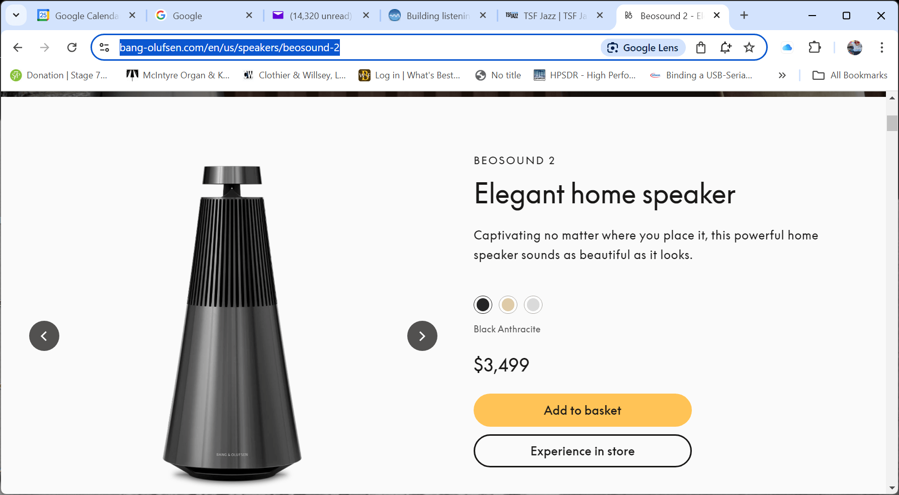

Bang & Olufsen wrote a white paper about it for the Beolab 90 speaker. It's too
large to upload here. I hate posting links as they stop working.
https://audiovideo.fi/wp-content/uploads/2016/01/bang-olufsen-beolab90-whitepaper.pdf
The Beolab 90 has variable directivity, and this manual describes how to
use each mode.

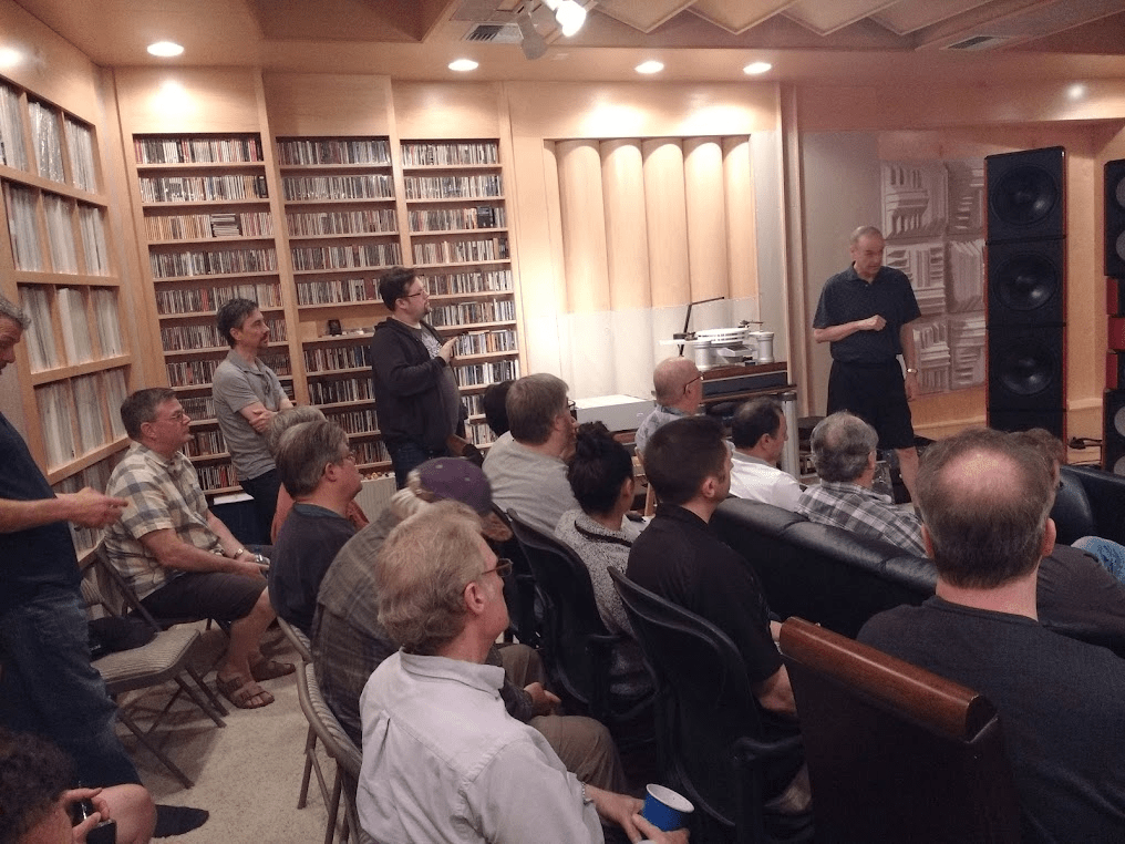

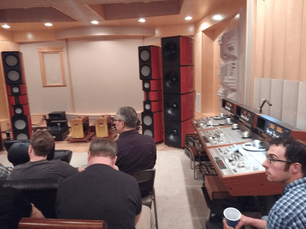

This is a room a guy built for personal use in the area. You can see both absorptive and reflective diffuser surfaces.

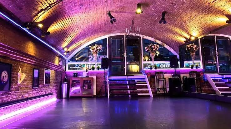

What I have in mind is a earth covered brick building with vaulted ceilings and non parallel walls.
Something like these railway bridge arches in Amsterdam but with non parallel walls and maybe double vaulted ceilings.
No noise pollution to the outside and easy to keep cool without giant electric bills.

Yes, true omni. A dipole is very nearly omni in practice. Many of the Bang & Olufsen speakers have omni modes and have the advantage of being wireless. I would team up with a Bang & Olufsen dealer to populate the bar with speakers along withYou mean diopole/open baffle or true omnidirectional like German Physiks or Duevel?
information on how to buy them.
