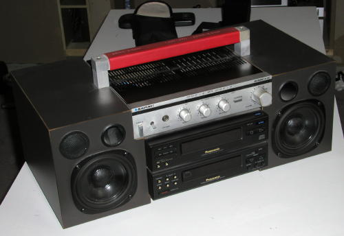

I've built once a portable. I used Panasonic minicomponents and Blaupunkt amp. The case is out of 1/2" MDF and drivers are Seas or Audax IIRC. Although a bit heavy it was better than any commercial units available at the time. This was also before GC madness😉
I was also contemplating building another unit with better components and chassis made of honey comb material used for aircraft floor panels. I have a nice Alpine deck, Pioneer CD player which would fit nicely here and the amp would use GC technology.

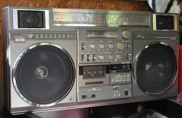

Yeah, actually I think it was from JVC, and it was a tube, with the bass drivers looking out of both ends of the tube...

I Remember the JVC boom blaster with it's camo style [rubber end caps and camoflauge pvc body.]A 6 inch sub in each end[with funny ports sticking out] and x2 4 inch fullranges at the front.
I used to own a boomblaster but even though it had two 6 inches[most 6 inches cannot handle sub bass frequencies].Which the boomblaster circuitry was producing and making the low wattage 20w rms subs 'bottom out' hit the back plate.
Who even back then I replaced the crappy JVC bass drivers with some Beyma pro pa drivers[same ohms of course],and replaceable the crappy 5 w rms fullrange speakers in the centre with 2 way coaxial speakers[same ohms of course].
Then after the modifcation it handled the bass a lot better and went much louder and clearer and it was the first portable system which has loud enough for disco use[at the time when i was rather poor and young [15]].
