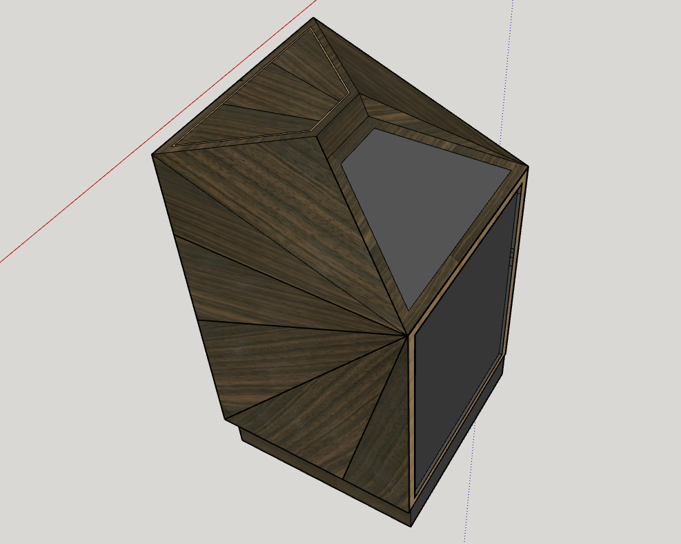

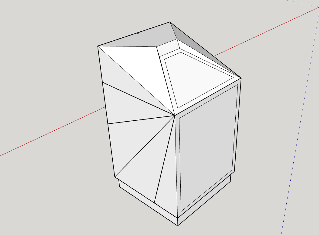

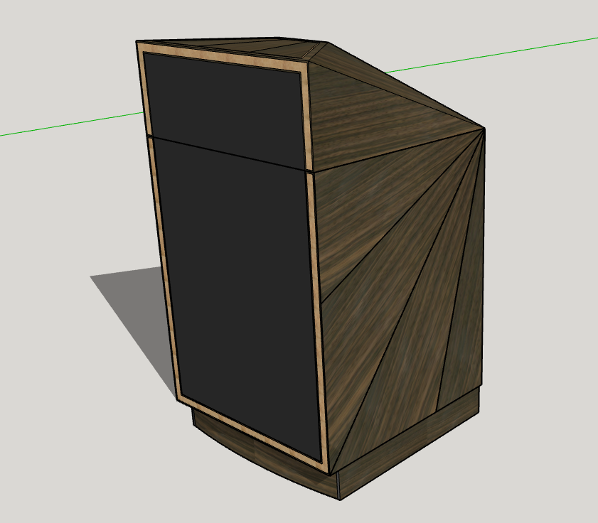

As for the time being I fail miserably with the design. the 'Holy' front plate of the loudspeaker is huge and well... holy 😉 means I cannot change anything and thus creating something a bit more fine... dammit. What more, seems that I am working in hostile environment since my wife and my 5 years old daughter made it clear that what I'm trying to create is ugly no matter what I do! Kids are lovely!
First sketch- with a window on top to show the crossover- looks fancy but.. I don't know could be also a speaker wearing a hat 😀
Hmm, if aesthetics is part of the deal, you will have to think about the speaker concept. Even the best craftsmanship and materials cannot bring elegance in a speaker whose outlines remind me of a dishwasher. If I had to sacrifice everything aesthetic for a speaker concept, I would'nt build it.
