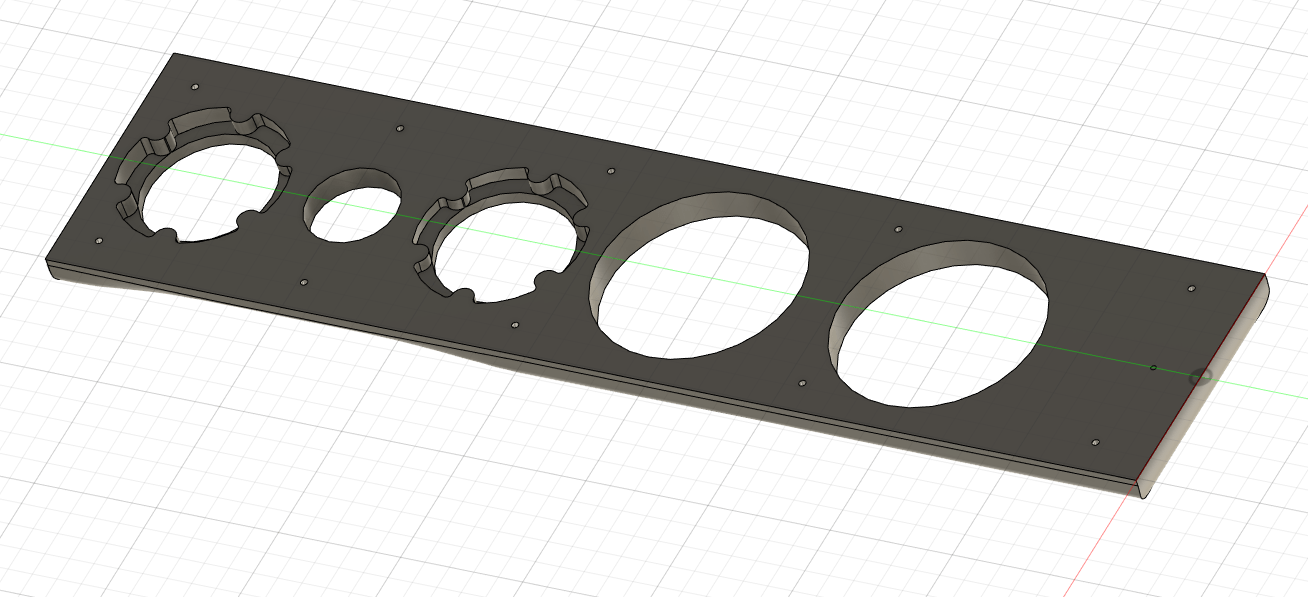

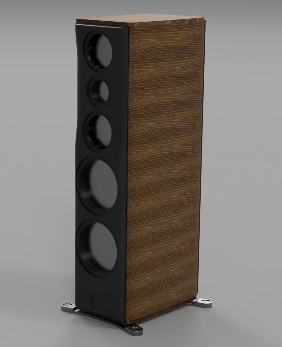

Hi Forum,

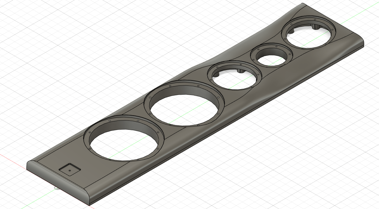

During my holiday I tasked myself in learning Fusion360 to help me model a front baffle with some angles and curves.
This is the flat drawing as a first concept.
The 3D render of the end result.

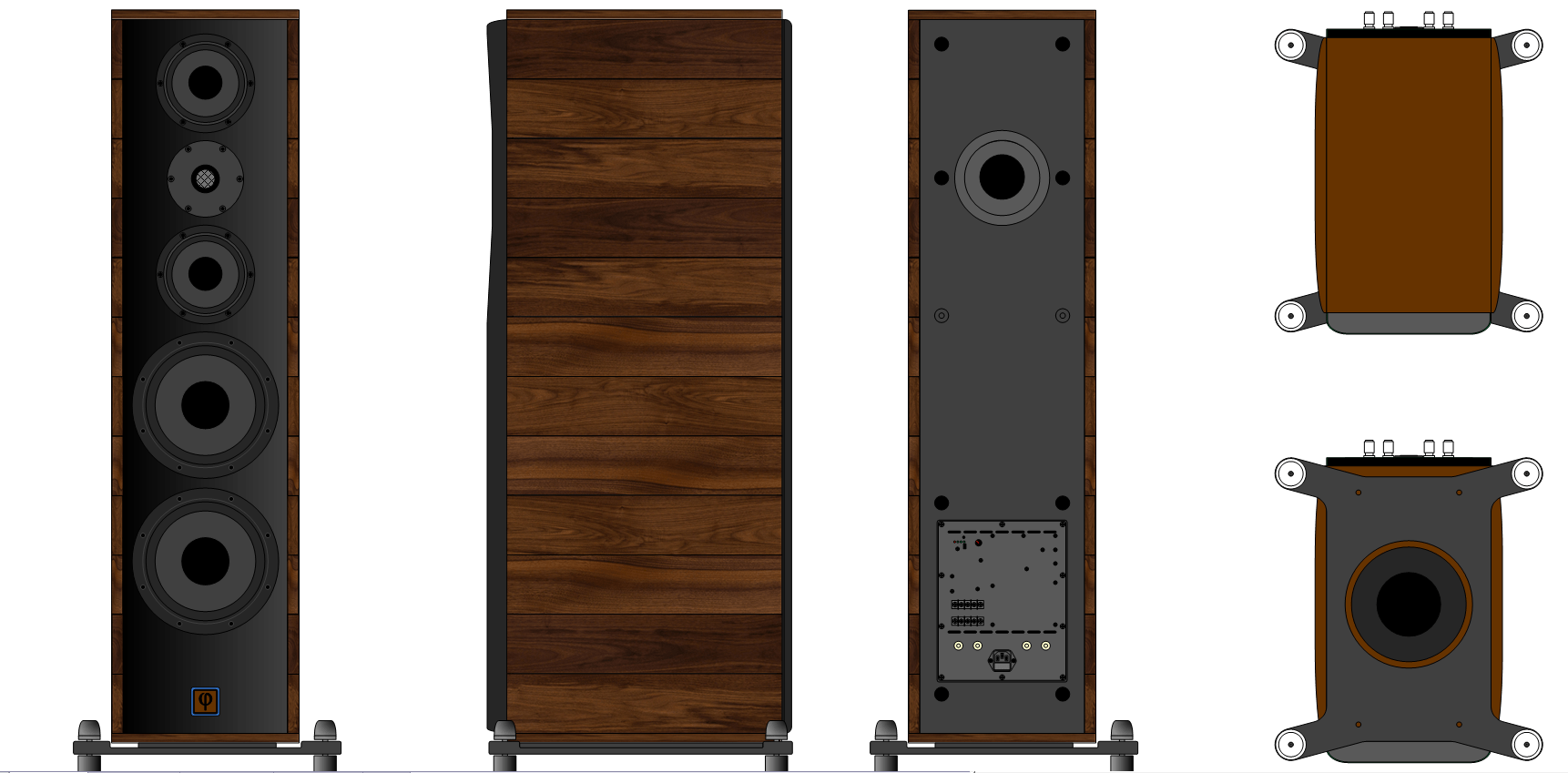

The render of the aluminum base
The front baffle that will be machined from a solid billet of aluminium.
The two midrange units are placed under an angle helping the d'appolito arrangement and moving the tweeter backwards without having any stubs that could influence the diffraction.
The rear side of the baffle with the flowerlike cutout behind the midrange to give it "breathing space" as the magnet would block the airflow with such a thick baffle.

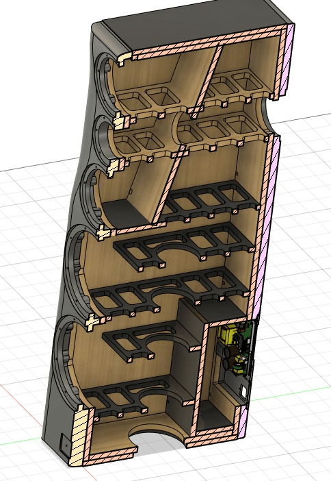

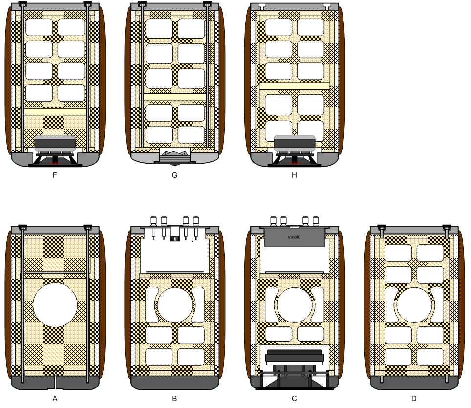

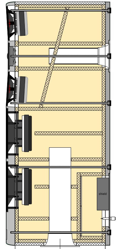

And this is a vertical cut trough the internal construction.
And some horizontal cuts

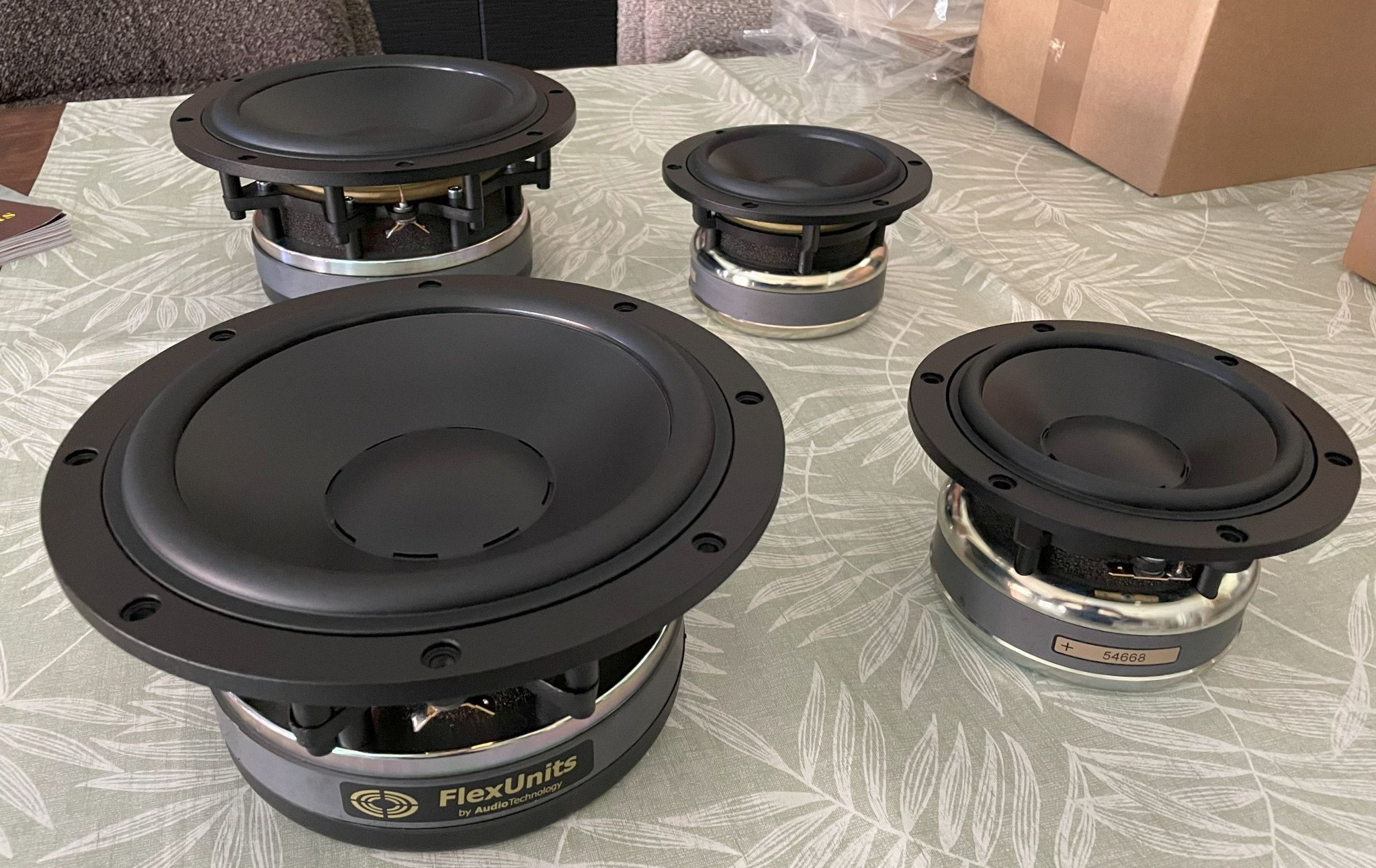

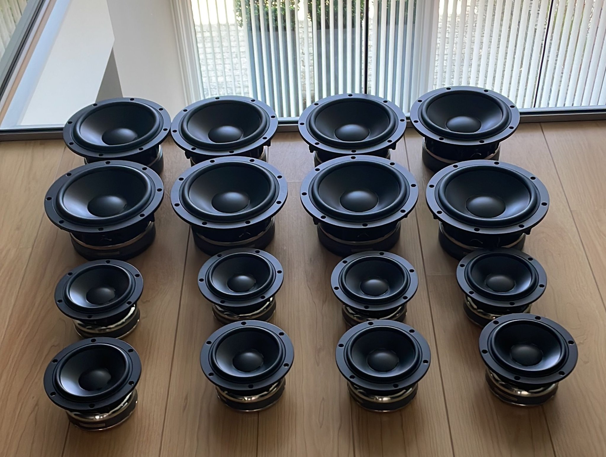

A small update:
The drivers have arrived and look great. The built quality is fantastic as always.
I have been putting some extra hours in Fusion 360, and although I still run into things I cannot explain I am getting better in it.
So I have put all flat panels into Fusion, and check if it all fits.
This has brought some errors to the surface so a good check, I also tried to make the speakers units in Fusion to make some renders of the final result,
The base is still under construction but this is the direction I want to go.

For someone who just started working with Fusion360 a month ago, your 3D renders are amazing! I might have to follow in your footsteps re- the software.I have been putting some extra hours in Fusion 360, and although I still run into things I cannot explain I am getting better in it.
Too thin IMO. The steel rods will be tensioned like strings so are prone to resonate. I would go 2-3 times as thick - what diameter does Magico use, since they came up with this construction approach afaik?10 pieces metal 8 mm rods
Nice project! I like minimal compromise speaker designs. The "take no prisoners" approach is very close to my heart. Those AT drivers have the potential to sound very neutral in that setup. Hopefully the front baffle will work out the way you envision it. The biggest obstacle you'll face with those AT drivers is working through the surround to cone reflections which are pronounced with the smaller cone drivers. Thats honestly my only gripe with AT chassis. They need alot of preconditioning before measuring them for the final crossover design.
When you find out how much those 8" woofers sell for, the "reasonable" may no longer be as stated for the majority of us.I have the price of the front and back, and that price was not too bad.
About the same price as one 8” woofer.
And that sounds very reasonable.
That is quite impressive. If you don't mind me asking, who do you use for your CNC work? I run a manufacturing shop and could send quite a bit of work their way.I have the price of the front and back, and that price was not too bad.
For the new base I have no price yet, and could indeed be expensive
