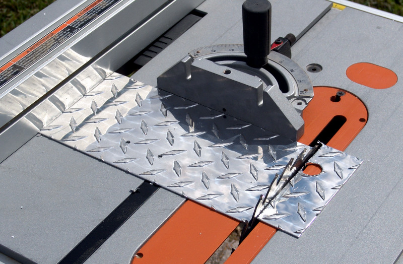

You can cut aluminum with a jigsaw. Use the finest pitch blade you can find and clamp the metal to cut down on vibration. You can clamp or screw the metal sheet to a piece of thin wood and cut both at the same time.

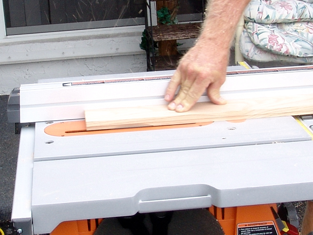

My wood shop teacher strongly advised me not to, but I have been cutting aluminum on my table saw. I got a 10 inch cutoff blade for cutting storm shutter panels, but I find that a carbide tipped plywood blade works better on aluminum. Just go real slow.

I can't find all my pictures since I have recently moved and built a new computer.

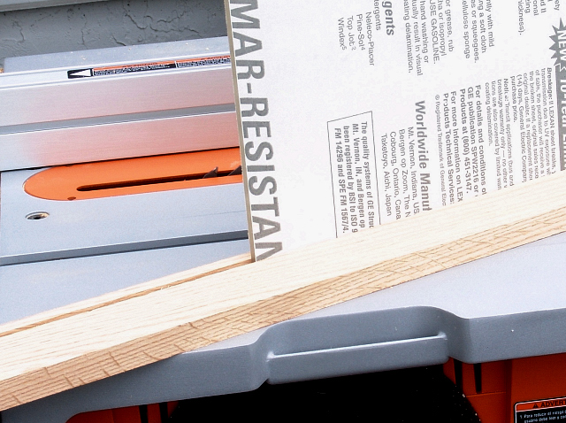

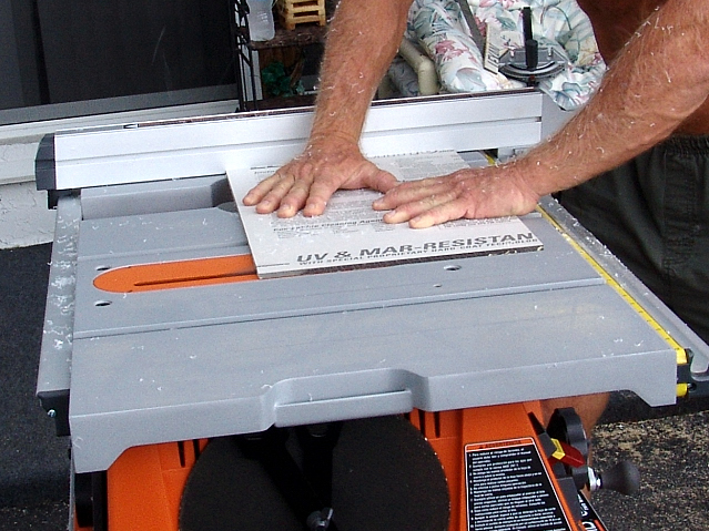

I have a picture of the result of cutting a piece of .062 aluminum diamond plate with the blade that came on the table saw. A finer tooth plywood blade gives a better cut. This was used for the chassis in a guitar amp.

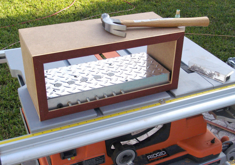

Also a picture of the outer wood box for the guitar amp. The box got covered with tolex (vinyl covering) and I made a Lexan front plate.

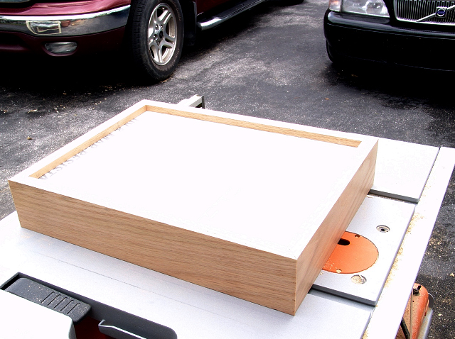

Next are some pictures of an amp chassis similar to your design. I made the top plate out of 1/4 inch clear Lexan to show off all the wiring and PC board. I do not have pictures of the final build, but several of the wood work.

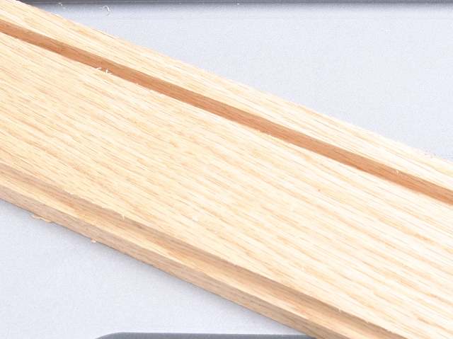

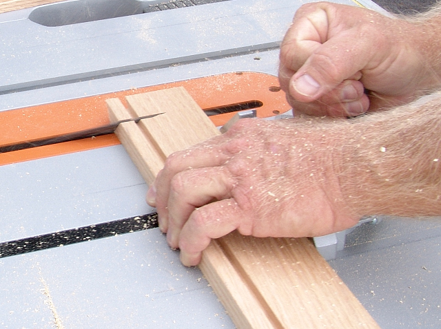

Here is a picture of the method used to cut the groove for a recessed top plate. The plate is 1/4 inch thick, so each side panel gets cut twice since the blade makes a 1/8 inch cut. I cut all 4 panels against the fence, then moved the fence 1/8 inch closer and cut all 4 again. the next picture shows the groove with the Lexan sitting in it.
Next I cut the rough edge off the bottom of each side panel. Then I cut the rabbet in the bottom of each edge for the bottom plate to sit in. This takes two passes of the blade. One pass is done and the blade is part way through the second pass. The next picture shows the panels after the long cuts are done.
Then each panel was miter cut to their final dimensions, and a Lexan panel was cut for the top plate. Next is a test assembly of the box before I took it to class for time at the router table to cut the openings for pot and connectors.

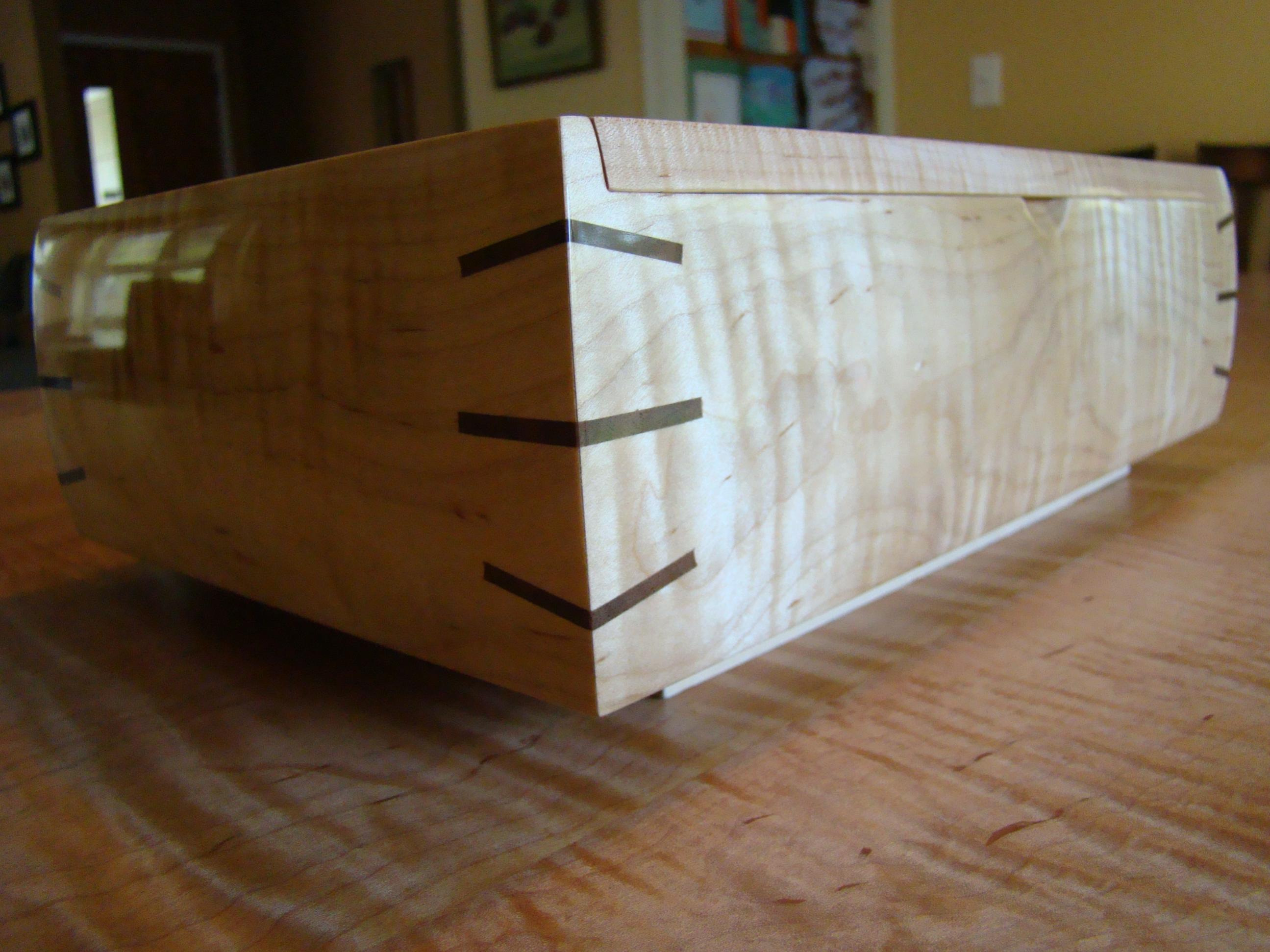

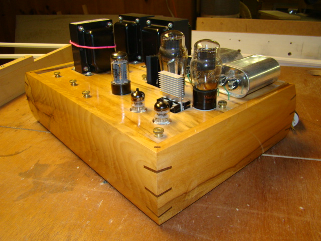

I just saw the pictures that Evan posted. His first picture is the same amp design that went into the box I made, a TSE. Unfortunately my amp was completed in wood shop class because they have a router table. All of those pictures were taken with a phone camera and are on a USB stick that is in a box somewhere. So is the completed amp. It will all be unboxed once the house id built.....several months from now depending on winter weather.....it snowed today.
Mitred corners look great but are difficult to get 100% accurate and without tearout. Start with a good quality corner clamp to ensure that your joins are at 90%. Also make sure that you work on a flat surface. I usually do my first glue up with a corner clamp before doing the remaining joins with a band clamp - this helps keep the mitres square.
Regarding holes for terminals, power entry modules etc, use a router to reduce the thickness of the wood before drilling out your holes - this makes it possible to use speaker and RCA connectors intended for less thick metal enclosures, giving you a much larger choice. Route out and drill your plates before doing your glue-up.
AS an aside, I recently invested in a Kreg pocket hole system and will build my next box using the kreg - the joins are very strong and it's easy to keep things flush and square. the pic shows the kind of look I plan to go for on my next project. - the Kreg makes this kind of build relatively easy.

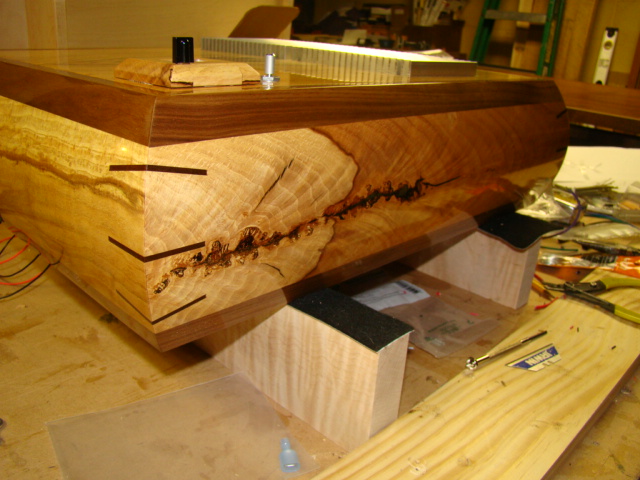

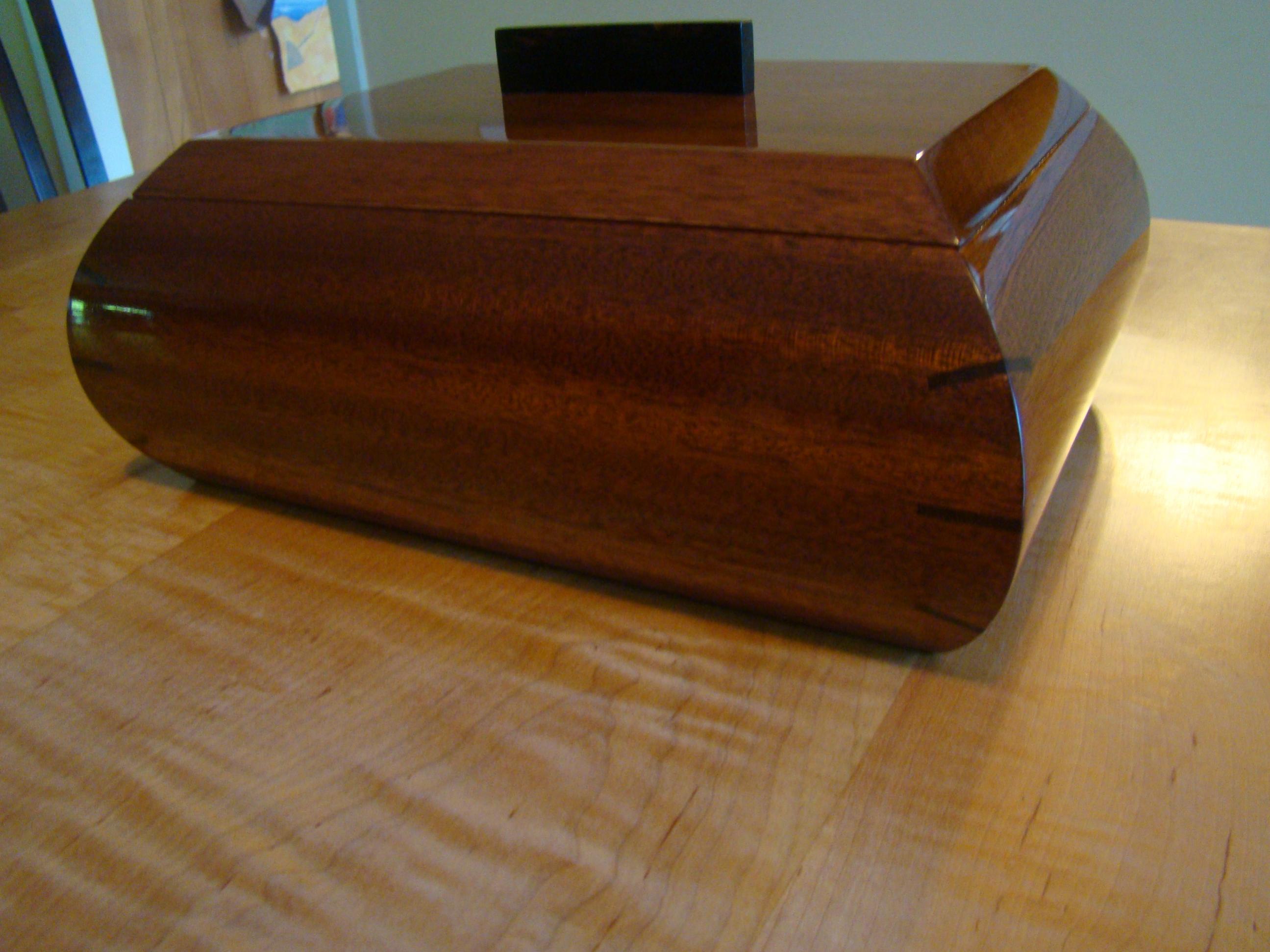

This box was built by Sceleratus on Head-Fi.
