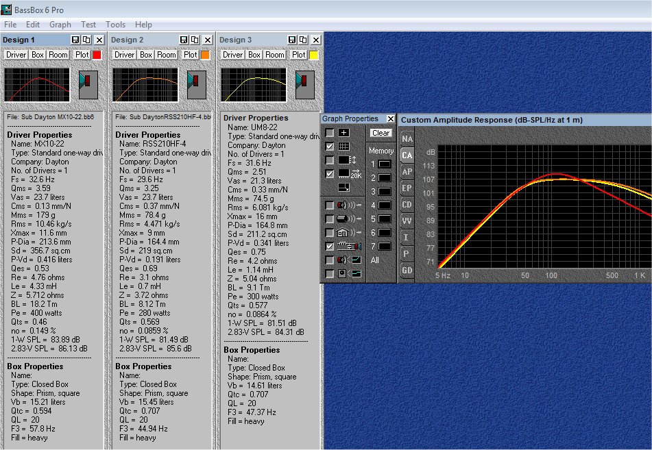

According to BassBoxPro, not really. BB suggests about half a cubic foot for either one (you can get a few dB more output down low by increasing to 1.0 cuft). Bass rolloff below 60Hz is about the same (MX10-22 peaks a bit more at 100-110 Hz), and efficiency is about the same.
MX10-22 will take more power and has more excursion available. The plate amp doesn't push enough power to make use of the 10" extra power capacity. But for excursion, software suggests that if you were running max volume sine waves down low you would run out of excursion with the 8, but you never would with the 10. As a music sub you could probably do the 8 and be fine, but for the same price and the same size box you can do the 10. The 10 will be operating at lower excursion (with more cone area / Sd), and have more to spare, so I would guess that it would sound better than the 8?
On the other hand, inductance (Le) on the 10" is 4.3 mH, and it's only 0.7 on the 8". I know on a woofer (reproducing mids) you'd rather have lower inductance - it goes with distortion. But on a sub I'm not sure if you'd care. I think (?) Le indicates IMD, which on a restricted bandwidth system like a sub might not be an issue. If any of our readers know, pls chime in...

BassBoxPro thinks they all look pretty much the same at low frequency, in half cu ft sealed boxes. The ultimax 8" in ~.5 cuft cant be driven past Xmax by 250 watts, it's got plenty. They're all rolling off around 60 Hz, but you can turn on the boost on that plate amp to get flat-ish response down low. I don't know the Q on the boost, so tough to say how flat. They all score a few dB more output below resonance if you feel like giving 'em 1 cuft, the ultimax 8 is still within Xmax.
Thanks. It's nice seeing the FR's overlaid like that. If you just look at, say, F3, the FR's seem different, but when they are overlaid you see that they are not really so different after all.
