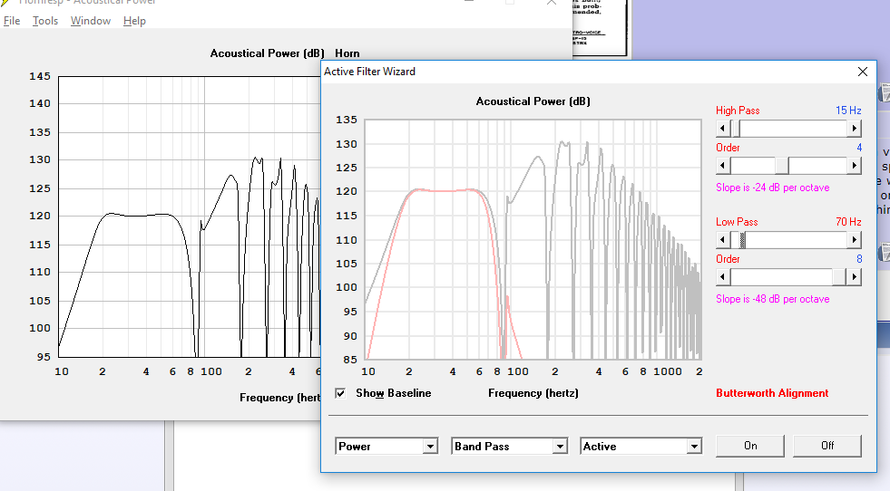

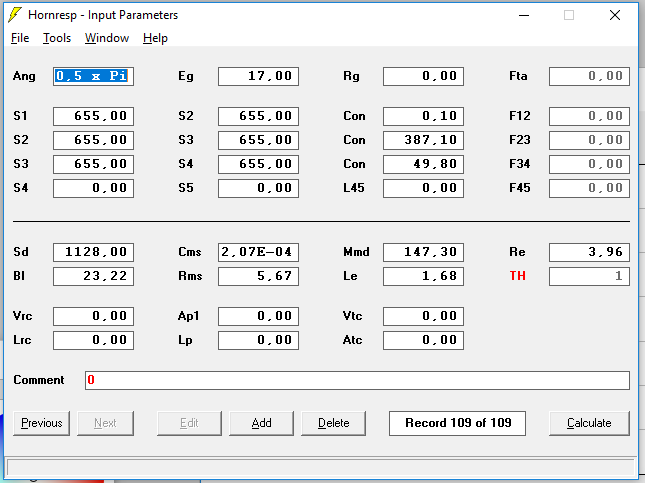

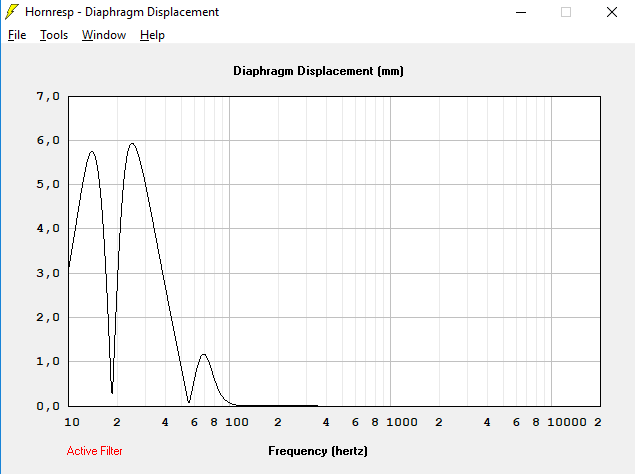

Hi, 20 to 70hz tapped quarter wave in a 0,5 pi space at xmax.
Wow, thanks akvaro, that looks like it would exactly fit my goals! Now I just need to figure out how to turn Hornresp parameters into geometry and figure out if it's a viable build for me. If so, that could end up being only a dollar per Decibel!

Yes, the TC Sounds is quite a bit heftier but it has to be because it displaces 5 times more volume than your driver. In that way the driver is it's own enemy, it has to be tough because it can displace so much air. The B52 driver will run out of steam at 6 mm Xmax (instead of 33 - 38 mm Xmax), as long as you power it with ~300 W (and use a decent high pass) I wouldn't worry about a thing.
Akvaro's design looks quite easy to transform into an actual plan, just remember that to fit the B52 driver into a square tube it needs to be around 47 x 20 cm (940 cm^2). Other then that it could be designed and build within a week time.
