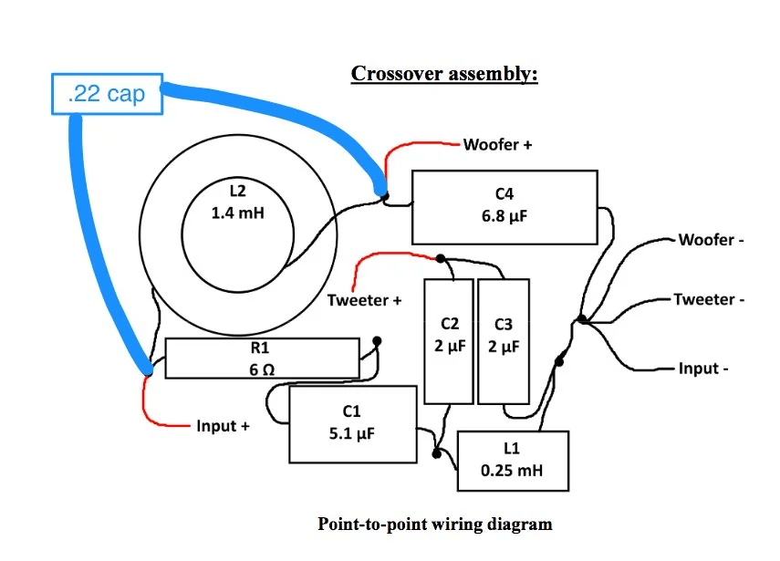

I have read that there is a quick mod for the C-Note speaker's crossover that apparently involves adding a 0.22 uF poly cap.
What I can't find is where to add the cap in the xover and what it is there to achieve.

According to the links below, the modification pushes down the high frequency breakup region of the woofer more (around 8 kHz).

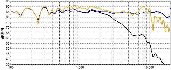

"Here is the woofer response with the crossover design as is:
Blue= system response
Orange= Woofer response
Black= Woofer response with existing crossover

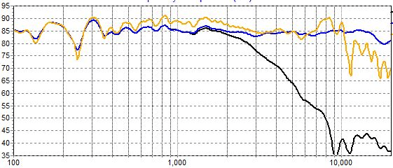

Here is the woofer with the additional 0.22 uF cap:
Black= Woofer response with crossover including 0.22 uF cap"
"The leads on most cap are plenty long enough to just piggyback the cap right on top of L2... just hook one side of the cap to one side of L2 and the other side of the cap to the other side of L2 (I'm not so sure those instructions are helping anyone, lol"
https://www.avsforum.com/threads/dayton-c-note-capacitor-mod-info.3204772/
"if the instructions say to install the capacitor "across L2", it means to solder one lead of the capacitor to one lead of L2, and the other lead of the capacitor to the other lead of L2. For the circuit, if you say to put something "across" another component, it means to install it in parallel with that component."

If you have the circuit board version of the crossover, it looks like there's solder mask on the traces everywhere except the expected soldering points. That will make soldering into traces more difficult (the green mask will need to be removed where you intend to solder). The factory holes are normally through-hole plated also to increase the solderable area and make the mechanical connection more robust.
You would probably be better off just wrapping the capacitor leads around the tinned portion of L2's leads and soldering there. The varnish on the inductor wire creates the same soldering problem, but where it's tinned the varnish has been removed already at the factory and a thin layer of solder applied.

However the guy that designed the C-Notes appears to recommend the tweak to counter an undesirable characteristic of the Al cone.
huh I've met Chris several times and had my cnotes measured in house, never heard him mention that cap mod. he does have a cost is no object xover I wanted to get from him at some point.
The small cap across the inductor has been used in several projects to kill the upper woofer/mid resonance and FR issues of some metal drivers, check out Paul Carmody's RS180 designs such as the Core and Amiga for some examples.
I've used it in a Peerless 6.5" project, not a metal cone but the cap killed a nasty spike at around 3,000 Hz. I read somewhere that when you use the small cap, you should add a 8 or 10 ohm resistor to it, but knowing very little about electronics I've no idea why.

YES, I did notice the measured change in the 5 to 7Khz region, but it comes at the cost of other things above that.
As so often occurs, their is a compromise involved. You end up with a 'cost/benefit' equation.

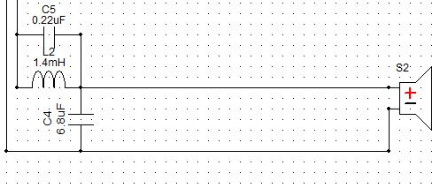

Thanks for your questions.
I mistakenly thought I was looking at a first-order woofer filter, when in fact it is second-order,
so the comment about adding capacitance across the woofer is not relevant. (silly me)
Also, the modification appears to be very effective at taming that 4 to 8Khz region but at the expense of
some distortion at higher frequencies. Having reconsidered the 'pros & cons' of the modification >
I would proceed with it. However, to make it 'perfect', you need to add a final .33mH coil in series
with the woofer to filter the 'very high frequency' distortion. (high quality low-loss .33mH)

PLEASE NOTE :
There is another fairly serious problem with the modification that is so obvious I failed to notice it 😕
If you look at the circuit, you will notice that the .22uF and 6.8uF caps. are in series creating a direct
high frequency path straight to ground (-). This is the same as putting a capacitor across your box input terminals.
This is not a recommended thing to do. Some amplifiers might not like it at all and will drop your impedance to
very low at 'super-high' frequencies. Also, it will make the 'Air & Sparkle' of your speakers very dependent
on the amplifier being used.
All I can say now is, if I was building these speakers > I would wire the .22uF with a switch so as to be able to
'listen & pick' the most favorable sound.
