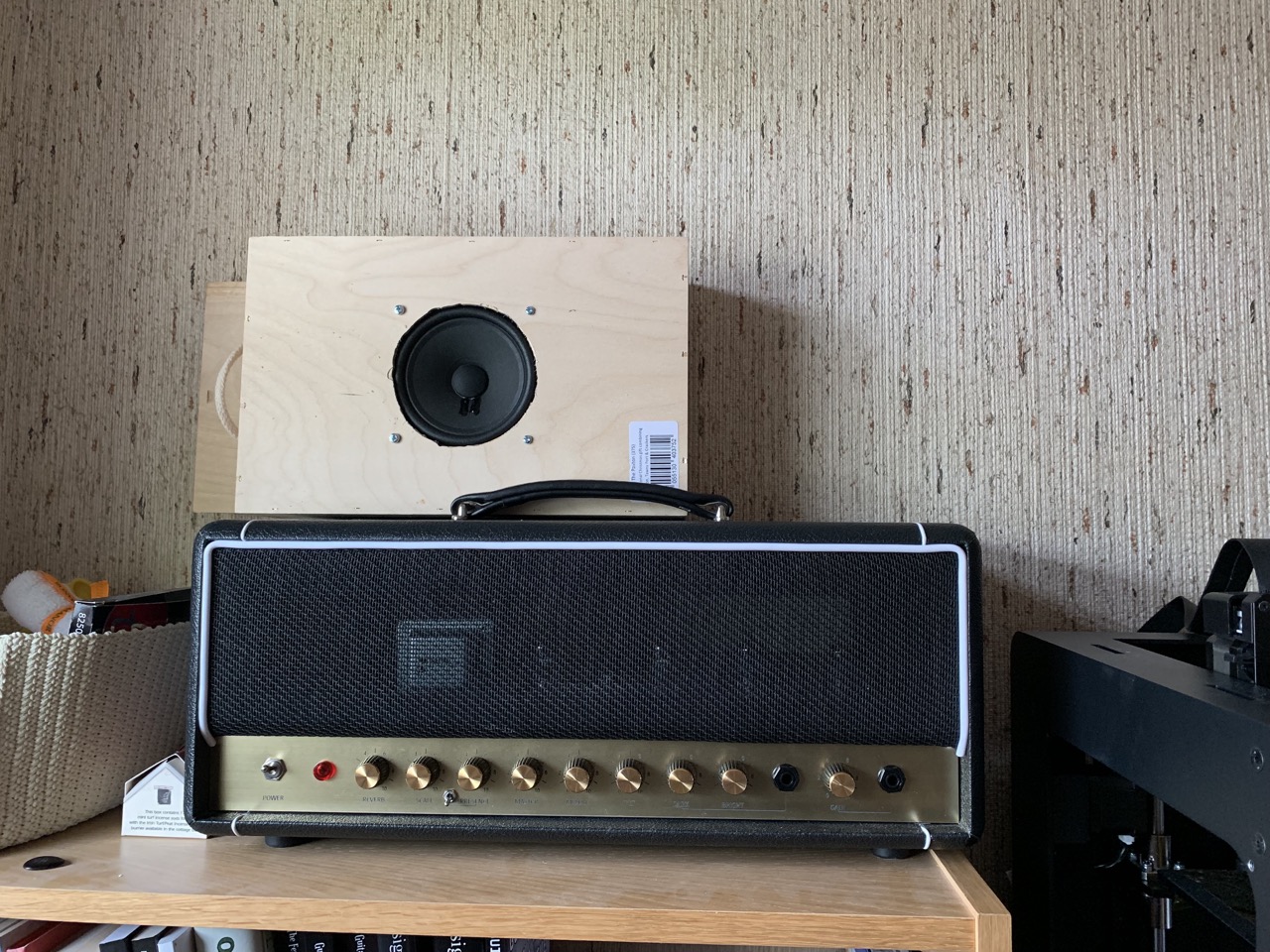

I've a spare Jensen Mod 5-30, a 5" driver for guitar: Mod 5-30 | Jensen Loudspeakers Parameters below.
Given the small size, what would be the best approach for designing a cabinet? Would a multiple of Vas, sealed, extend the bass and give a 'normal' feel?

Serious guitar wants a bigger driver. Bedroom playing is usually not about the lowest notes, and that MOD will do fine in bedroom work.
I have to go along with Sonce. 3-10 liters sealed. Try with and without stuffing.

Just build a small box, from shoebox size (literally) to, say, the dimensions of a Fender Champ.
Open or closed back, both are valid but sound different,
You may experiment with removable back strips so you try fully_closed/half_closed/fully open.
You can even change from one to another when you get bored.

Attached is what I have to hand today. The 'baffle' and rear are thinner plywood, which might be an issue but it's something to experiment with. Volume is ~6.7l.

The sound is OK-ish clean - lots of top. But it's a kazoo when the gain is set higher. This would be an excellent example as to how much of an impact the speaker / cabinet can have on the overall tone.
Striking chords and sliding the back in and out is a fun excercise - I've yet to give it enough time to settle on a position, but initial findings:
- more closed = more bass
- more open = more top and 'honk'

Funnily enough this is exactly how I had it placed - on top of my amp head, which was on top of a mid-height bookcase.
Not bad for a cheap speaker and an upcycled wooden box.
Thanks for all your help and input. I'll report back once I've settled on a set-up.
