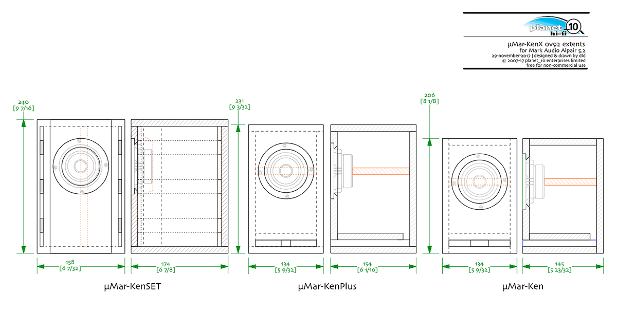

I just had an email bounce from a member with this exact question, so i will copy it here:
Any box for the Alpair 5.2/3 will work fine with CHN-50.
I have a paid planset, http://www.planet10-hifi.com/planset/A5x-extents-291117.pdf
Since that drawing i have added the wedgie versions of the µMar-KenPlus. And many other odd-balls, and a set of woofTs (helper woofers that act as stands).
The basic CGR plan is free: planet10-hifi.com/downloads/CGR-µMK-251220.pdf <http://planet10-hifi.com/downloads/CGR-µMK-251220.pdf>

No such thing as a regualr miniOnken. There are 5 basic shapes, CGR is one of them, and the one i usually release for free.

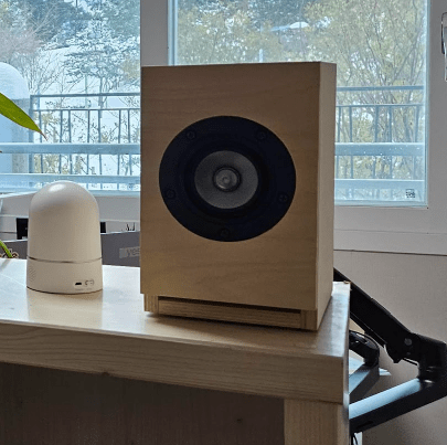

Hi all! It's my first time posting here.
Thank you so much for all the information I already learned from here.
May I have a couple of questions about CHN-50 enclosures?
I'm a total noob and I just built a small box last year without any knowledge. That was based on the below slot vent box design.
https://www.kjfaudio.com/wp-content/uploads/2020/08/CHN50-slot-vent-box.png
I saw the below note about some resistance but I didn't understand that at all so I just ignored it. 😵
The other question is about the lagging. Some plans suggest lagging with fiberglass board or wool felts and avoid acoustic foam. But I saw some other plans (i.e. pencil 10.3 although it for the other driver) suggests stuffing with polyfill. What's the main differences between lagging the faces vs stuffing?
For me, stuffing is much easier and way easier to adjust later so I wonder if I can use the other method to get a similar result. Or the two have totally different functions?

Thank you all for the prompt responses.
One of the big challenge while building the previous box was this actually. I couldn't find those commonly mentioned materials here in Korea. All I could find was different products with different name. No detailed specs like density. I just used some layered felt dishcloth.
https://www.amazon.com/Universal-Household-Absorbent-Eco-Friendly-Non-Woven/dp/B094JYF33C
So I couldn't know what's the right amount. If it's ok with mixing the both, that will make it much easier for me. 🙏
Actually, I realized a mistake after I built it. I changed the shape like this to make it easier. There was no way to make the square slot hole. 😢
I liked the new shape but I think this made the effective length of the port shorter like 60cm not 72cm.
So (although the current box also sounds great)... now I'm thinking of trying a new box with this driver. Probably a little bigger one?
Also I got a pair of a10.3 so I need a box for it as well but that's out of scope of this thread.
