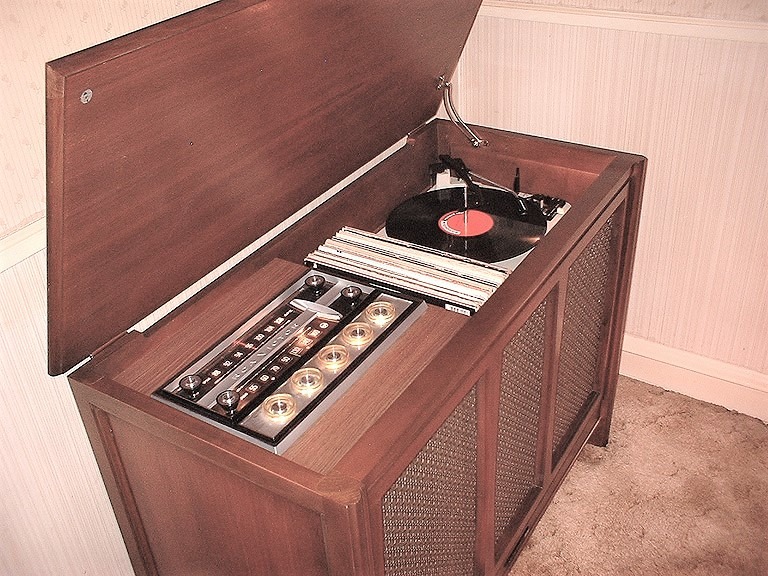

When I first got this lovely, virtually pristine 1960's console stereo, I naturally brought it back to working order, not that it had issues, but as a restorer I have extensive experience in vintage equipment.
The 106 year old lady that passed away three homes away from me owned it, and probably only dusted it over the decades, hardly used.
The side walls were walnut veneered 1/4 inch plywood, the front speaker baffle was 1/2 inch plywood, sporting 8 inch woofers and cone tweeters.... basic, mass produced stuff by RCA Victor.
The overall sound was sloppy-boomy, as it should have been. - AKA resonance......
People back then liked that type of sound as an upgrade to the typical table radios of the era.

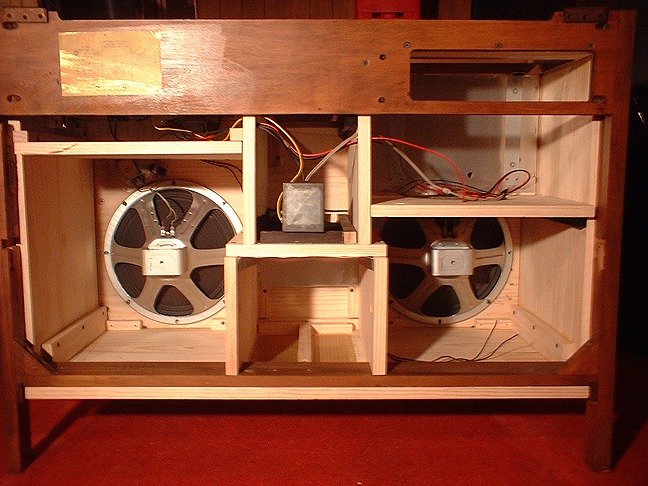

But I wanted better, being a sort of audiophile that I am.
I wanted stellar response from that nice old cabinet, something remarkable as possible, within reason.
A few trips to Home Depot/Lowes, and brought home 3/4 inch solid pine panels.

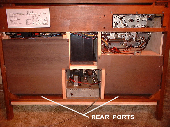

I gutted the internals of the console to populate it with a better electronic chassis, and better larger speakers.
After designing on paper what was to be, and hoping for the best, I went to work and fired up the table saw.
Lining the whole cabinet with the pine panels - including gluing those thin veneered sides that boomed, I configured the internals to mount the guts, including a newer, nicer Garrard record changer.
12 inch woofers, midranges, and tweeters now lived inside, on a solid 3/4 inch baffle.
Certain additional modifications were needed, mainly a sub-sonic filter to prevent loud-volume feedback of the record changer (using a magnetic cartridge of course).
And tailoring the preamp/amp to suit the resulting sound took a few tries as well.
GUESS WHAT??
No more boomy RESONANCE! - even with the large woofers.
Clean, clear, rich, distortion-free room-filling lovely sound.
Even my audiophile friends that stopped to audition it by were impressed.
And some of them guys are picky-picky, moreso than I am.
So yeah, resolving cabinet resonace in my case was an excellent thing, and well worth the effort.
This is an early photo of the internals - those alnico woofers have been replaced by high-excursion cloth-roll ferrite monsters that dig deep and sound tremendous.
Also, added is rear panels with a port, internal polyfill stuffing, and proper crossovers.
