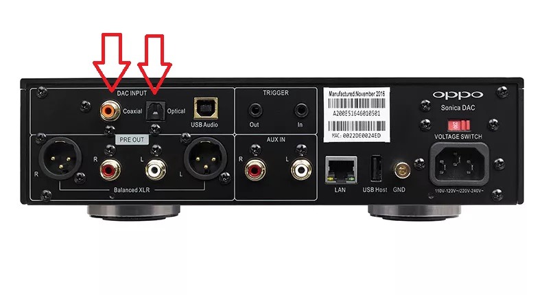

Having said all this, and having used the optical connection from the beginning and coupled the Philco to an Oppo Sonica Dac, - the idea was to use it as a transport and take advantage of the virtues of the ES9038PRO chip of the Oppo Sonica DAC -, I had a doubt.
Lately I have read that to listen to music the coaxial cable connection is better than the optical one ..... and a demanding audiophile like me cannot ignore this just like that!
Delving deeper into the subject, in favor of the optical cable is the null interference of nearby electromagnetic fields, and against its lower bandwidth, also against the fact that the cable should not be bent, and the poor quality of many "generic" cables that in instead of a crystal center conductor they use plastic, which would degrade the entire bit path. Well I use the one that came with the Pioneer.......
In favor of the coaxial cable we have a greater bandwidth, against which it is prone to pick up electromagnetic signals from nearby equipment and that the cable must have a characteristic impedance of 75 Ohms, so common analog interconnection cables should not be used. RCA.
Thinking ? Am I missing some SQ (sound quality) when using the optical connection? I want to do the experience, should I buy a specific "boutique" coaxial cable or is it the same to prepare one with a generic 75 Ohm cable and two RCA connectors?

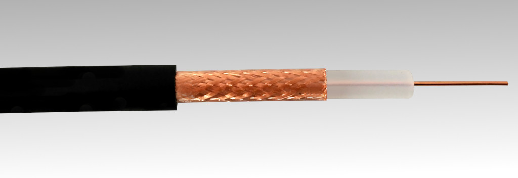

They both have their evils but the coax goes through fewer conversions. From electricity to light and back again making more places to screw up the signal. If you are in RF and EM hell then the optical might be the way to go. Find some Belden 1694A coax and roll your own cables with the connectors of you choice. It’s a little stiff but it’s what we use in the broadcast industry to move HD audio and video. There are lots of other good ones by Canare etc..
Belden is indeed fine coax but it's so stiff it would be unwieldy around the back of theThey both have their evils but the coax goes through fewer conversions. From electricity to light and back again making more places to screw up the signal. If you are in RF and EM hell then the optical might be the way to go. Find some Belden 1694A coax and roll your own cables with the connectors of you choice. It’s a little stiff but it’s what we use in the broadcast industry to move HD audio and video. There are lots of other good ones by Canare etc..

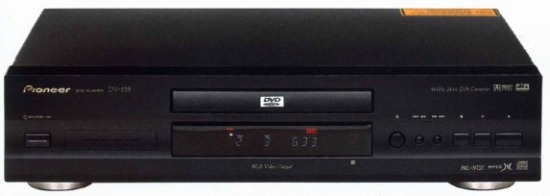

I like my SACD DV59aviPioneer through its stereo L&R coaxial until I plug thorough a up to date moderized Dac and by pass the dual Burr Browns inside. Imagine those were cutting edge back in the earlier 0000's. This one and that are cracking good players, I always stuck with Pioneer mostly. The 59 is one of the best transports Pioneer put out even to this day.
Otherwise I feed the digital coax through the Dac. Sometimes its hard to beat the redbooks and a solid player no matter how much resolution you throw at the thing 🙂

for coaxial s/pdif connection, a high quality 75 ohm "RG-59" video cable with decent RCA connectors works just fine, Belden 1694A is too stiff, Belden 1505F (about 6mm O.D) used for SDI digital / HDTV video should work and is more flexible / lighter than the 1694A.
Thank you all for the answers.
I will try to build a coaxial cable with a piece of 75 Ohm cable of the type used in home installations. I think it's the RG-59. I will look for one as flexible as possible, I have many scraps out there. I guess the length shouldn't matter because it transmits bits, but anyway I'll make it just the right length to get from one artifact to the other comfortably, without too much leftover, which is always a hassle.
So, will there be a difference in sound quality with respect to optical?
