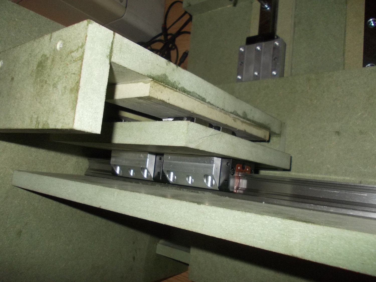

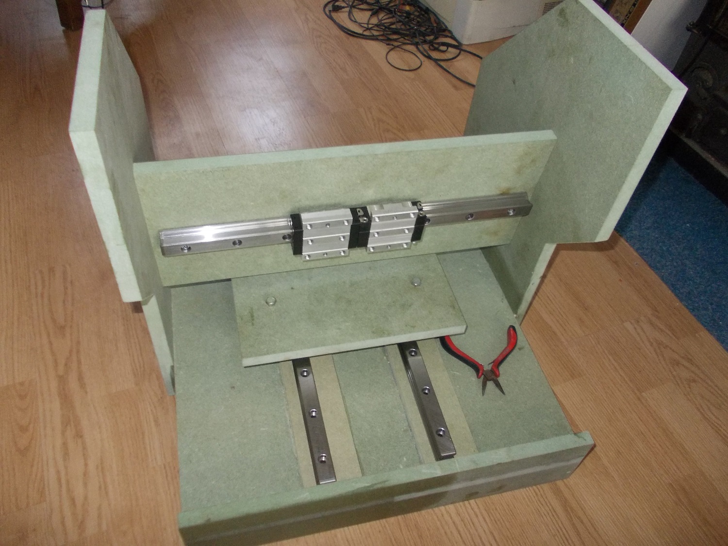

Busy now with a cnc for pcb routing, a lot of work and need for precize work.
I use pressed wood, waterresistent and stif enough for pcb.
Rails are a little overdue but had not something smaller.
regards
regards
Looks very good, but if you have the possibility, take laminated wood. MDF pressed wood is not very durable, even under moderate pressure.
I have the version of mdf who is water resistent, these are quite good, but the machine is for trying out, when i like it, I go for better stuff, the mechanics is a lot ,more easy as the electronics.
I have however some trouble so now and then when measuring, because things need precise, I have now use sketchup, making a precise drillplan for the rails but printing with sketchup is a dramatic difficult to get right, I sill understand not why she did that this way in there software.

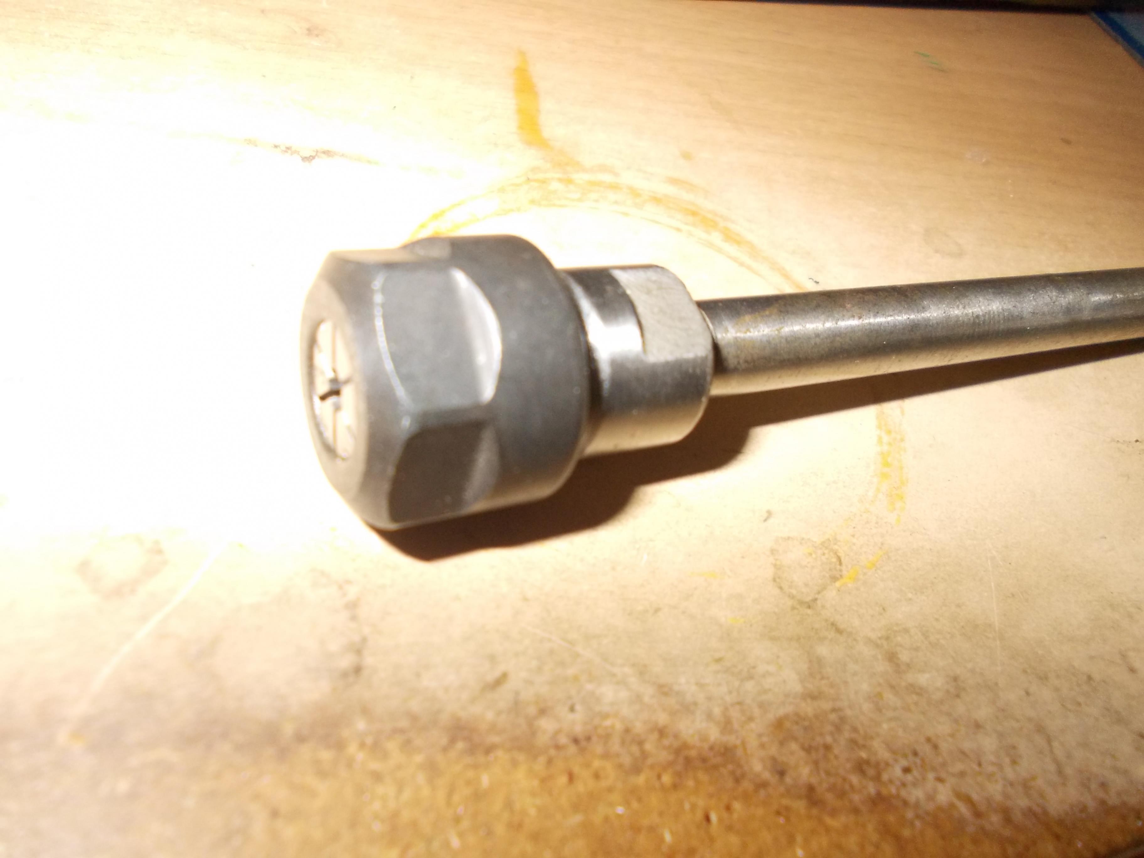

What kind of laminated wood is oke?, I have use in past the waterresistant version for the house builders. Afcourse aluminium is better, now the lathe is setup I can make a spindel, I have paired bearings special for spindels for 50 euro a set. That is quite cheap.
I had see a spindel on ebay who did use a beld, I can not find the ad for it and the spindel anymore.

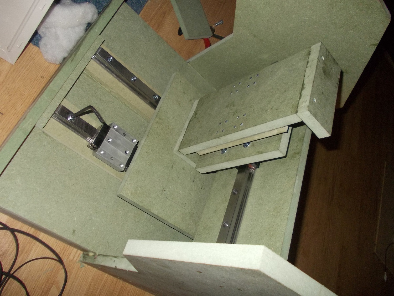

Here is a store who have this pressed laminated wood, but I think when it will do well, I go for metal like aluminium and a new design, using the same rails, need a ballscrew for the Z axle, becouse of weight total spendel and house system.
Here I am further with the design, get things drilled precisely did ask for sketchup on 0.000 mm setup to make a mold on paper for them, did work fine..
