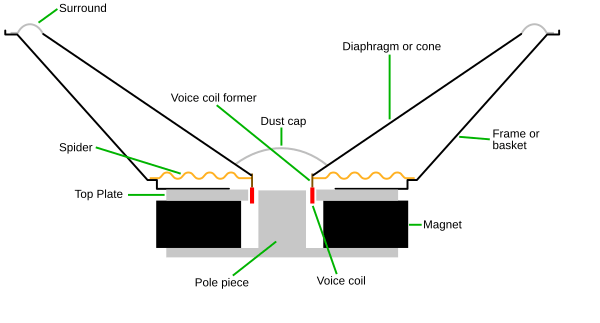

You aren't going to know Vd without a spec sheet though. It isn't something you can easily measure.
Your best bet is to try and shine a light through the spider, in an attempt to glance at the voice coil, and then guess at what the amount of coil overhanging the top plate is.
Could you explain this a little better?Lo mejor que puede hacer es intentar hacer brillar una luz a través de la araña, en un intento de echar un vistazo a la bobina móvil, y luego adivinar cuál es la cantidad de bobina que sobresale de la placa superior.
The "Top plate" is usually the magnetic gap length.
Voice coil length - magnetic gap length / 2=Xmax.
12mm voice coil -6mm gap=6/2= 3mm Xmax.
Xmax is one way excursion.
If you can see the voice coil above the gap, you can estimate it's total length.
This speaker would have very little Xmax, the coil length/height is not much more than the top plate/magnetic gap/length/height:

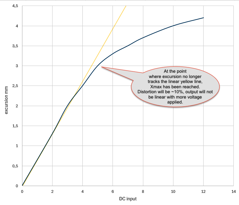

There I should stick a piece of paper or something at a right angle to the woofer, put a ruler on top, and see how much it moves, right?

Radew,
Yes.
The idea is to chart the movement (excursion) against voltage.
Below Xmax, the range of linear operation, doubling voltage (+6dB) should result in a doubling of excursion.
At the point where excursion no longer tracks the voltage, the linear yellow line, Xmax has been reached.
Distortion will be ~10%, output will not be linear with more voltage applied.
The further the voice coil is driven out of the magnetic gap, the less control the amplifier voltage has on the cone.

but when I do the test with a 1.5 volt battery, it takes 1mm, then I connect two 1.5 volt batteries in series, and it gives me 2mm, then 3 batteries in series, and it gives me 3mm, that doesn't mean I have Do you have to reach the maximum power of the woofer to be able to find Xmax?Yes.

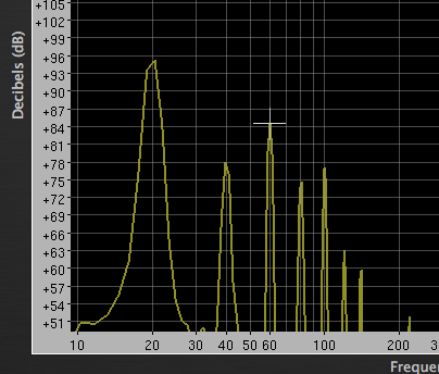

An alternate to the DC test would be using a 20Hz sine wave signal through an amplifier with a volt meter connected to monitor the voltage as level is increased, while measuring excursion.
A small speaker open air won't produce much SPL at 20Hz (the fundamental frequency), but when you start hearing harmonics buzzing, multiples of the 20 Hz signal at 40Hz (x2), 60 (x3), 80(x4), 100(x5), 120(x6) the speaker probably has reached or is past Xmax, 10% distortion, harmonics -20dB below the fundamental.
Using a RTA (available for free with REW https://www.roomeqwizard.com/) the output may look something like this:
In this example, 20Hz reads 95.3dB, the 3rd harmonic reads 84.6dB, -10.7dB below the fundamental, ~30% distortion, well past Xmax.
Any harmonic above 75.3dB in this example indicates distortion above 10%.

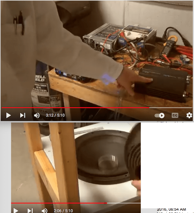

Could you explain this better, and how to do it step by step please?An alternate to the DC test would be using a 20Hz sine wave signal through an amplifier with a volt meter connected to monitor the voltage as level is increased, while measuring excursion.
but in the video they do not explain if I have to use the maximum voltage of the coil, or if I have to use a specific frequency, they do not explain it.This video explains it better than I could:

A specific frequency is not required.but in the video they do not explain if I have to use the maximum voltage of the coil, or if I have to use a specific frequency, they do not explain it.
A low frequency, like 20Hz, makes hearing the distortion easier- the reason you are concerned with Xmax is the speaker distorts and generates multiples of the drive frequency when driven beyond it.
The excursion can still be plotted as in post #11.
There is no need to "use the maximum voltage of the coil" whether using DC or AC (a sine wave) to test excursion.
