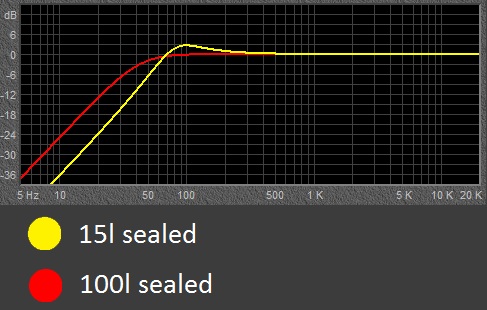

Hello,
I have just started designing subwoofer boxes (i did it before, but with random dimensions, sometimes I was successful, sometimes not so much).
Let`s get to the point...
How do I know when box is too big and will sound boomy? or perhaps when it`s to small and driver will struggle?
Currently I have 15l sealed box for my 10" 125W RMS sub.
It plays to high and after entering T/S and box volume into the program I get the graph that shows exactly what I was expecting (tuned to high) YELLOW LINE.
However I was playing with the box volume until I get it lower RED LINE. Yes I loosed the 3db gain (at around 90hz), but I can deal that. I rather turn the volume higher than listen to this loud 90hz bass and when it realy needs to hit (lower) there is no output at all.
But... the box should be at 100liters to achive this frequency response. Something is telling me that a 10" sub in that big sealed box will sound boomy.
How can I know when box is too big or small. What is warning me of exceeding the right volume?
Or is there any rule in general?
Should I go ported for this driver in order to lower the frequency?
Somewhere I read that round port shoud at at least in diameter 1/3 of the driver, what about square (L) port
And why does the bass response of 15l box YELLOW LINE act like it`s in ported box? I mean 3db boost in short range?
Thank you all for your time and help

A sealed box too big will not sound boomy unless it is thin-wall, not braced and has no damping material in it - in which case the boom will be from the enclosure and not the driver. The 90Hz peak you see in the small box is "boom"
The small box is not 'acting like a ported box', it is acting like a sealed woofer in a small box.
To better understand how the ratio of box Vb to speaker Vas changes things, try varying the box size by 10L at a time. The box "stiffens" the cone and raises the resonant frequency. The smaller the box, the higher the frequency and vice versa.
Fc=Fs*sqrt(Vas/Vb+1)
Qtc=Qts*sqrt(Vas/Vb+1)
Vb=Vas/((Qtc/Qts)^2-1)
Qtc cannot be less than Qts
0.5<Qtc<1 for a decent sounding system

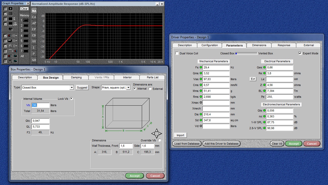

Hello,
thank you for your help.
I don`t have exact accurate T/S parametres yet. I measured them with 5% tolerance resistor and I`m waiting for 1% tolerance resistor to make more accurate mesurement.
My current measurement is:
Parameter/Value Description
fs 29,4 Hz free air resonance frequency
Zmax 23,9 Ohm impedance at resonant frequency
Rdc 3,8 Ohm DC-resistance
Qms 3,52 mechanical Q of the speaker
Qel 0,66 electrical Q of the speaker
Qts 0,56 total Q of the speaker
Mmd 50,87 g/1,794 oz mass of driver's cone
Cms 0,57 mm/N compliance of driver's suspension
Vas 97,83 l/3,455 ft³ compliance volume of the speaker
I would also like to use this opportunity to ask if Rdc is the same thing as Re?
And if Qel is the same thing as Qes?
Driver is a cheap one from Mac Audio Ice Block 125 (bandpass box) but it will do for now. The whole point is that I want to get some experience in designing encolures and I will be more pleased to get good performance out of cheap driver because of the design than good performance from 200$ driver (like JBL GTO 15" 1500w that shakes the whole car with a box that my friend made without any use of T/S at all)
Qtc was automaticly calculated by a program (BassBox 6 Pro) and it is 0,683, so this is good.

Hello,
thank you all for opinions.
I have started reading a Loudspeaker Design Cookbook as Ron E advised to me. I had just finished with sealed box chapter.
I had learned alot of things from it.
I didnt even red the vented box chapter yet and I already know that this is sealed box woofer with its low fs, 0,56qts and heavy cone.
I think that I will use 30l sealed box with it`s Qtc at 0,95 and F3 at 49hz.
Thank you again

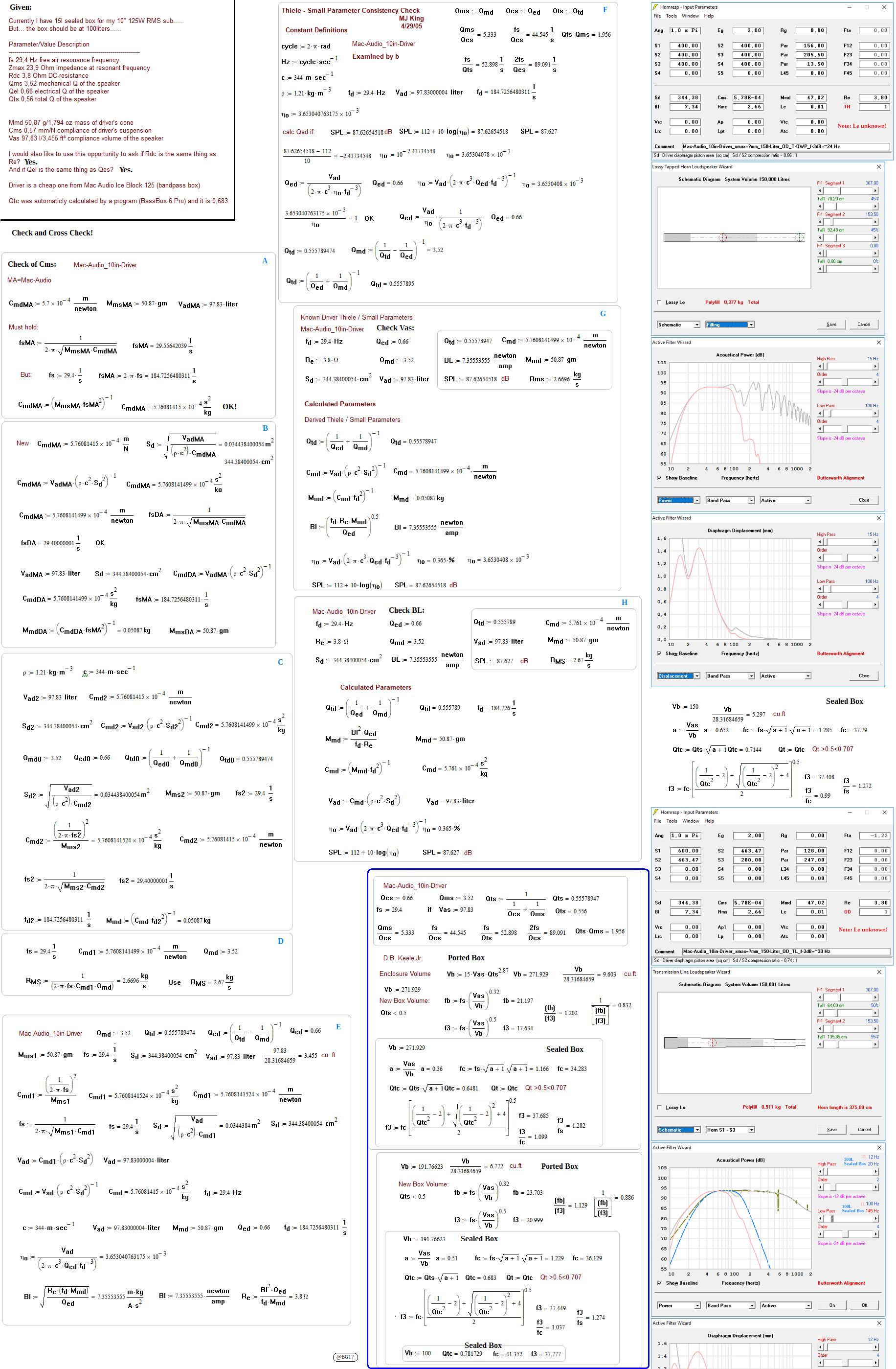

Hi diy1995,
A 30 L Sealed Box (No Damping) will return, a Qtc of ~1.1473,fc=~60.7 Hz and a f-3dB of ~45.3 Hz that IMO must be EQ'd if placed near a Wall.
I expanded(Checked) your T/S data and tested QW Designs that allow total Q's above 0.5:
b
PS:If xmax is less than about 5 mm and if Le has a large value, I would too make a Sealed Box but closer to 100L.
I`m confused right now.
Had you ever used BassBox 6 Pro? Can you say if this program calculates incorrectly?
![30l.jpg 30l.jpg](https://www.diyaudio.com/community/data/attachments/597/597602-c57f21199d36d17be03b6ae2489a0972.jpg)
This is what I get in BassBox 6 Pro.
However after some thinking I decided to go with bigger box (50l according to my calculations) for more flat response and Qtc closer to 0.707:
![50l.jpg 50l.jpg](https://www.diyaudio.com/community/data/attachments/597/597608-4dad9e35f1afabeb31c4bf7d3b024ae4.jpg)
