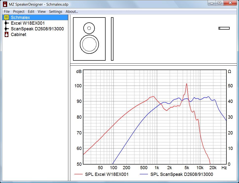

I'm looking to emulate these with birch ply, not perspex. Maybe desk or stand mounted. [That's a w22, not w18]
This little freeware program can get you something close enough for OB, though ideally you want it to be same size as the finished cab's baffle, but since it isn't designed yet, probably best overall to make it whatever the max acceptable baffle size can be: Home of the Edge

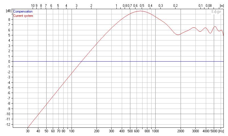

Schmalex: With such a "small" baffle, you will not be able to generate much bass, even if you sit in the nearfield. There are two things working against bass:
#1: open baffle is just like an infinitely sized box when it comes to the driver mechanical response, so you will get something that is on a first approximation like Fs and Qts.
#2: because the pathlength between the front and back of the driver is short, there is an "acoustic short circuit" meaning that low frequency sound waves from front and back meet and largely cancel (in the low bass). This is the "open baffle response" that the software can model and is only dependent on the baffle dimensions (to a first approximation).
In the picture you showed the baffle width is the smallest dimension, and I guesstimate that the width is on the order of 30cm or 12". The approximate open baffle response would be something like the attached plot, which I generated in the edge assuming a 30x45cm baffle.
The combination of #1 and #2 will give you a rough estimate of the woofer response. Don't expect to be able to use this 2-way below about 150-200Hz. You will need to add a small subwoofer.
-Charlie
