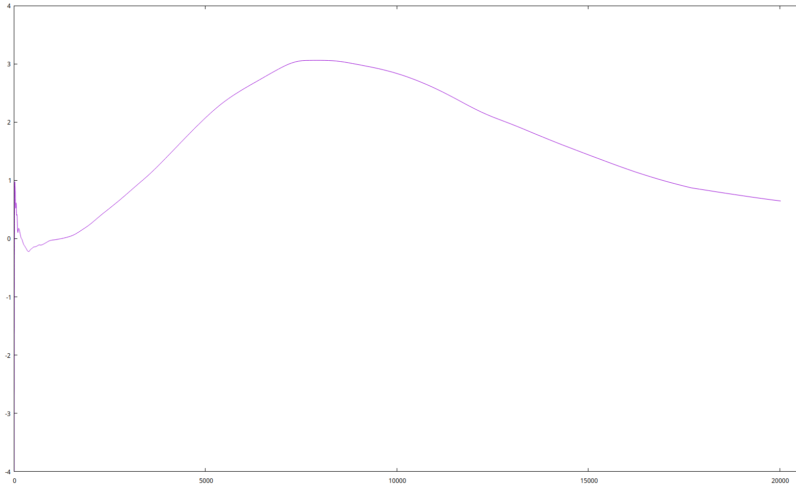

All: I have been writing PYTHON code to set up an audio test and have both my internal mic and a UMIK up and running. The UMIK comes with a calibration file, so I am wondering if anyone knows what the spec is to apply the calibration parameters to the incoming audio stream. It must be out there because REW apples it, but I don’t see anything on the MIniDSP site. Thanks, Mike
Here is a guess because I was looking at the files the other day. I think you need to do interpolations with the data-points in the file. I have checked a few and they have many points with small gaps that result in a smooth curve.
Then offset what you measure using the interpolated curve. X is frequency and values in Y look small enough to be dB offsets, wondering if they need to be added or subtracted.

To close this out, I went back to the miniDSP folks for their recommendations. They were of zero help. Fortunately John Mulcahy Provided the following information in his REW manual that is provided below.

Calibration File Format
The calibration file is a plain text file which by default has the extension .cal, though other extensions are also accepted. It should contain the actual gain (and optionally phase) response of the meter or microphone at the frequencies given, these will then be subtracted from subsequent measurements. The values in the calibration file can be separated by spaces, tabs or commas. Typically the values are relative to the level at some reference frequency, e.g. 1kHz, so the gain value there is 0.0.
- Each line of calibration data must have a frequency value and a gain value, a phase value is optional
- Frequency is in Hz, gain in dB, phase in degrees
- The cal points can be at arbitrary frequency spacing, but each line must have a higher frequency than the one before and there must be at least 2 freq, gain data pairs
- Only lines which begin with a number are loaded, others are ignored
- In comma-delimited files there must be at least one space after the comma
