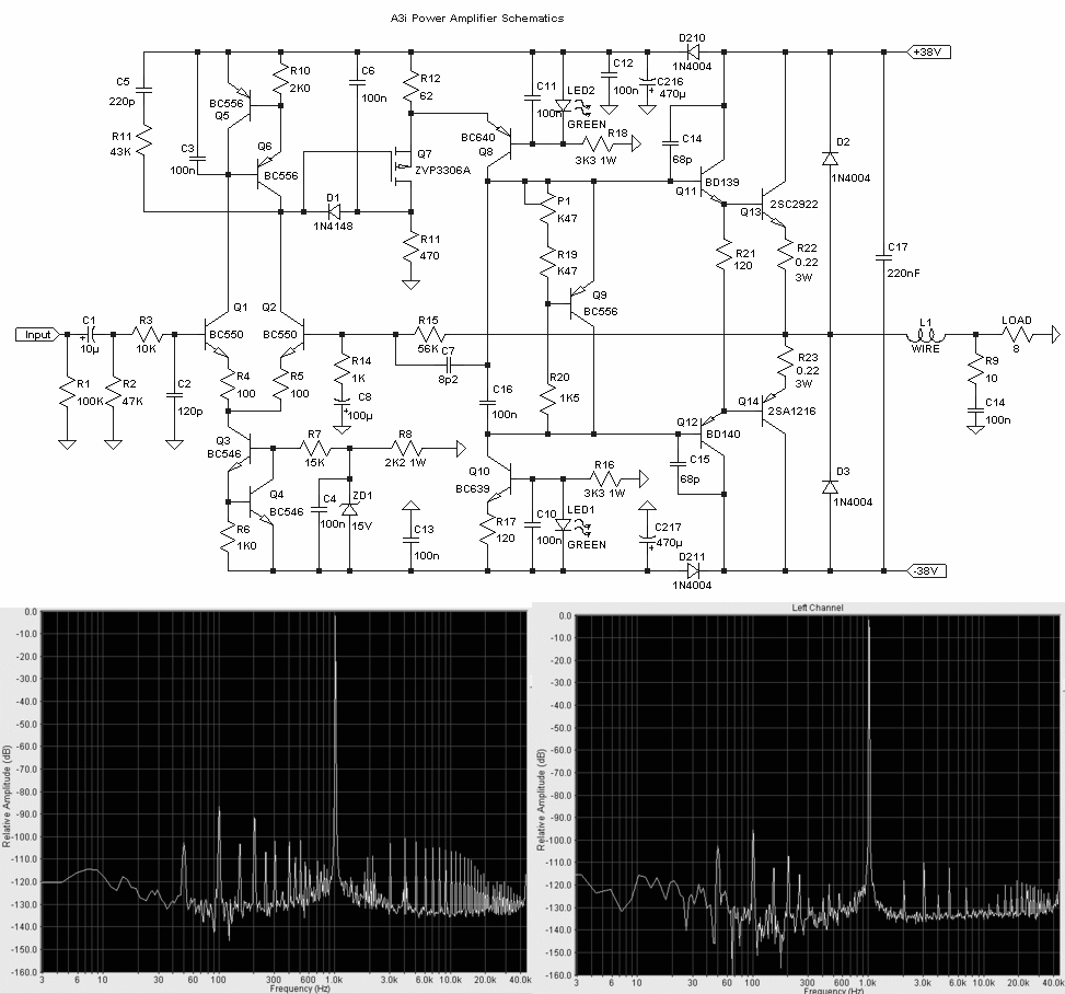

I've designed that amp more than 12 years ago. As it happened, it was designed to be a 40W per channel amplifier but at the last moment it was promoted by the management into 60W just by boosting the supply voltage. That and also poor quality PCB and some components contributed to a common fault - as a result of a local board overheating one of the LED's (usually LED2) or Q8 transistor next to it (BC640) goes open circuit. Thankfully, protection circuit in this case just disables the output. It is useful, if you came across this amplifier, replace both LED2 and Q8, mounting them at least 10-12 mm from the PCB.
I've bought an old and broken A3i on ebay couple of months ago - to see if I can modify it to improve the performance. After fixing the usual fault (it was Q8 this time) I found that few simple mods could considerably improve the amp performance.
To get a baseline, I've measured the amp in it's original condition (except the transistor replacement). A3i gave a very typical set of measurements:
60 W into 8Ohm
at 50 W into 8 Ohm THD was:
0.003-0.005% upto about 5 kHz
0.01% at 10 kHz
0.022% at 20 kHz
However, as the first picture (1kHz 20V RMS 8Ohm) shows, there was a considerable amount of interference from the rectifier.
Today I did a few mods on the old A3i - replaced rectifier diodes with Shottky and replaced D210 and D211 (diodes between VAS supply and O/S supply) by 10 Ohm 1W resistors. As a result, most of the interference have disappeared and more importantly, the THD measurements improved significantly:
below 2 kHz the distortion was at the limits of my ability to measure them. My sound card ADC has got residual distortion about 0.0003% for -2 dB input (equivalent to 20 V RMS on the graphs), my generator is about 0.00015% at midrange. The amp measured consistently near 0.0005% for 2kHz and below, 0.002% for 7 kHz, 0.007% for 10 kHz and 0.02% for 20 kHz.
Providing that the gain of the power amplifier in A3i is quite high - 57 (about 35 dB) the performance is good. Most of the distortion at HF is due to a crossover point - result of a simple two-stage output follower. Using a triple follower could reduce the distortion further. However the VAS has excellent linearity for such a simple circuit.
Alex
P.S. I attach the schematics of A3i power amp section and two graphs - on the left is for the unmodified amp (THD = 0.002%) and on the right is after modifications (THD = 0.0005%).

This circuit is a very interesting one. Very unique VAS 🙂
x-pro, I presume this amp was designed to a budget. If you could make more exotic device substitutes and tweaks, what would you have done? My guess is you would have used a triple stage as you have already mentioned, and better driver transistors.
Thank you, the VAS is indeed quite interesting - it combines a very high open loop gain and a good linearity for such a simple circuit. I've used a somewhat modified version of it (with fully balanced cascoded JFET inputs) in Creek Audio A52 series of power amplifiers.
These are obvious ways of potential improvement. A3i was made to a very tight budget. In general, this VAS could be easily coupled to another good quality output stage with good results.
Alex

Hi Pier,
yes, these look like a suitable replacement, thought according to the datasheet there is a noticable difference in a current gain between n-p-n and p-n-p devices. I may order some from Farnell to try and measure.
Cheers
Alex
ppa said:
Hi All,
Alex, what do you think about the change of bd139 and bd140 with the MJE243/53 ? their pin sockets are the same but power and curret are both bigger in the seconds, moreover MJE243/53 are made by ONsemi and this is a guarantee.
Pier Paolo
Hi Pier!
here is an update. I've received some MJE243/253 and tried these in A3i circuit. They work very well - certainly better than modern versions of BD139/BD140. I also have measured the gain of these devices and from 50 of each all PNP have gain between 140 and 150, and NPN are mostly at 130, with a range from 100 to 150. I plan to make a redesign of A3i circuit for DIY and will probably use ON Semi drivers and output devices.
Alex
