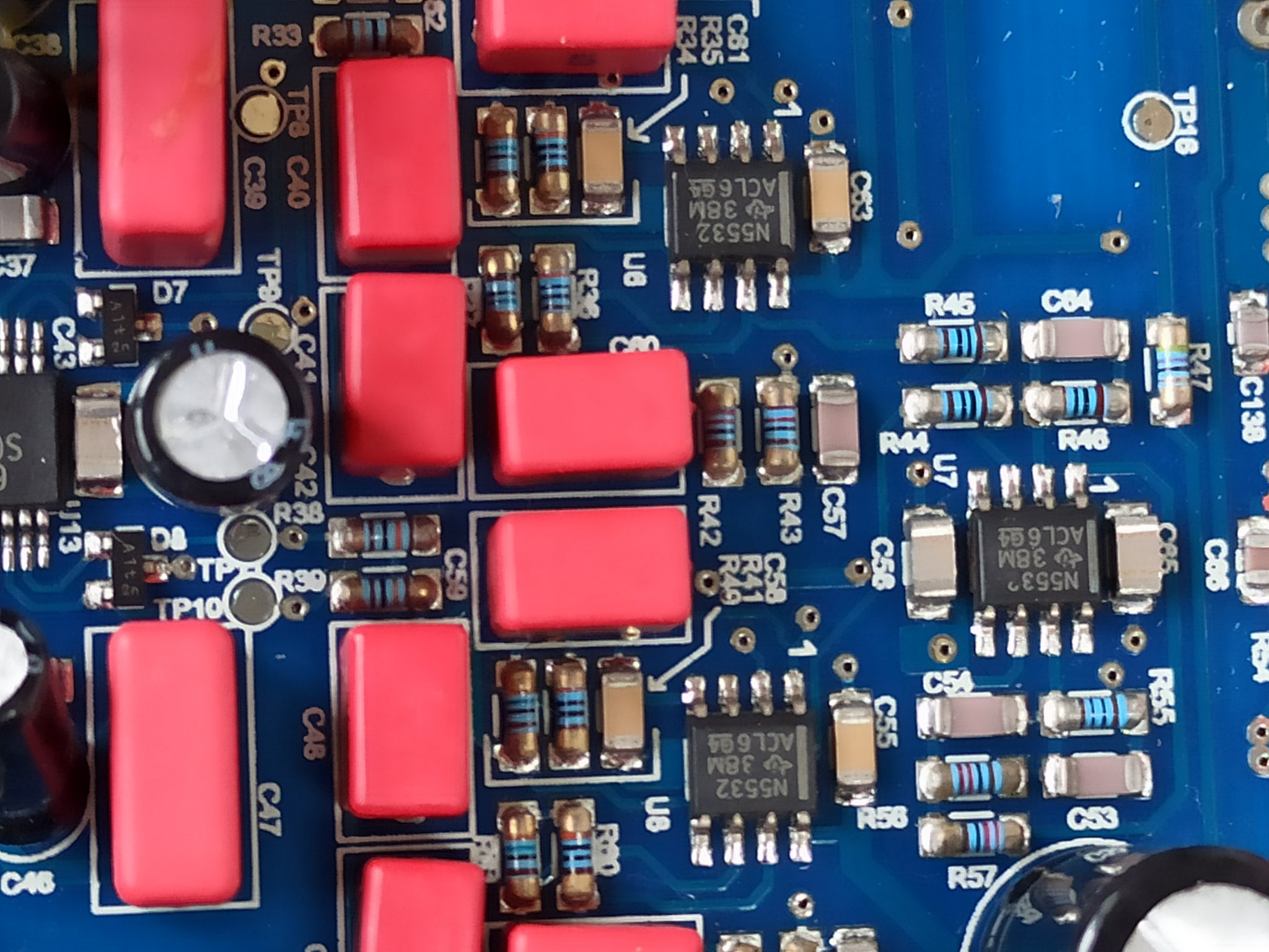

As noted, the Azur 651c has three NE5532s that appear to be performing some function in the output of each channel with a 470uF capacitor nearby. The opamps are surface mount and it would require some kind of adapter to enable new opamps to be trialled. This looks like a solution: https://www.ebay.com/itm/312812470169?hash=item48d5137f99:g:f3YAAOSw8ENdHJIp

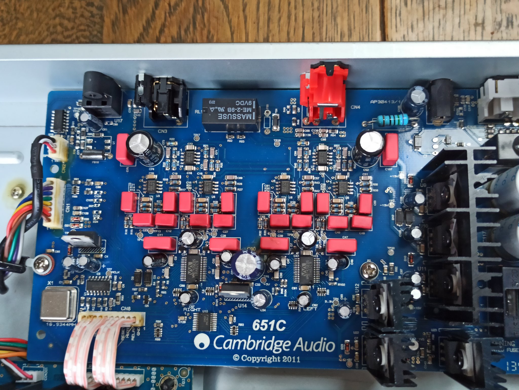

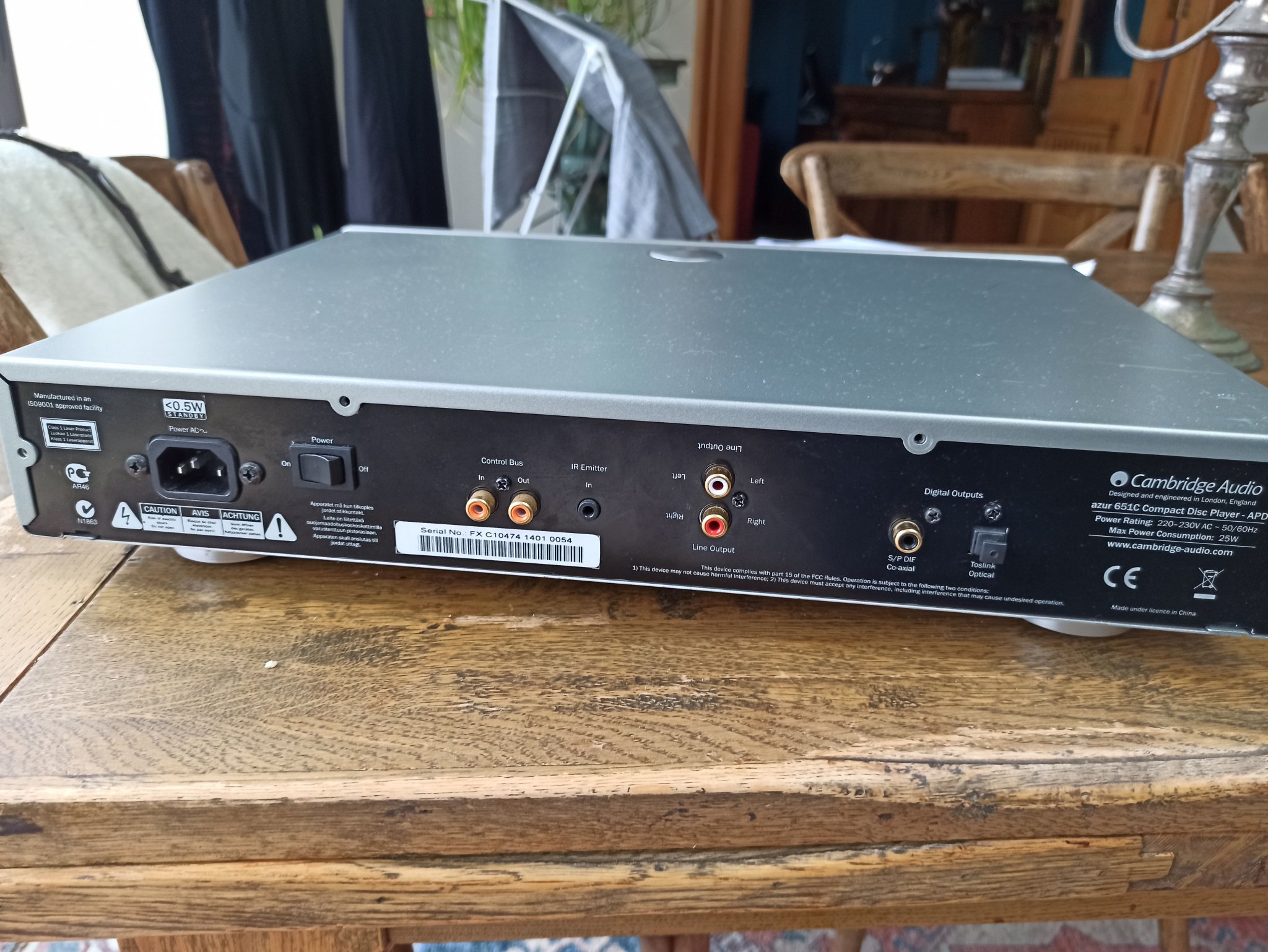

AFAIK 651c is a discontinued model, using cirrus logic / wolfson WM8742 DAC chip. can you post pics of the unit's rear panel and the pcb area with NE5532's and output stage?

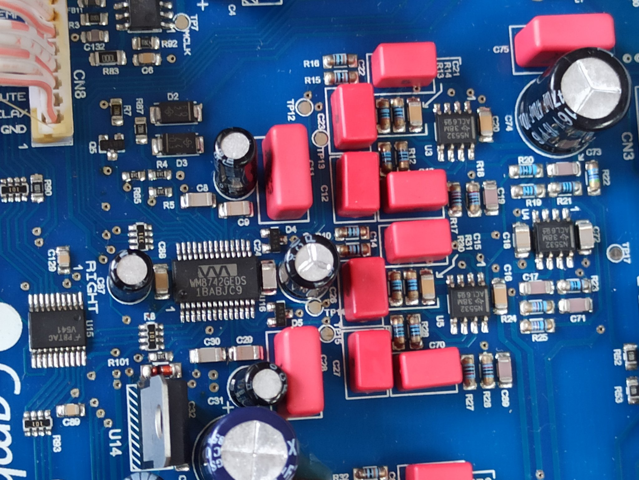

Correct on all counts. Pix herewith.
if the 470uf caps are non-polarized / bi-polar then consider replacing with Nichicon Muse BP. I would stick with SMT for the op amps.
Thanks for that. I'm still curious as to the mode of operation of the opamps given there appear to be three per channel. Not sure if it would be necessary to replace them all.
try replacing the non-polar 470uF caps first and listen over an extended period of time before making any additional changes. if you still want to change the op-amps after that, and assuming the analog stage of your unit is based on the WM8742 DAC datasheet reference schematic, the two op-amps closest to the DAC chips would be the ones to change out as they perform an LPF function. third one is there for summing of the differential outputs and can probably be left alone.
SMT electronics technicians often have a saying about desoldering smt parts (you can either save the chip or the board, but not both). obvious choice is the save the PCB in this case. there are some (expensive) specialty cutters by Diamond, Erem, Lindstrom, etc. with ultra-narrow heads that can fit between and cut the legs of the SOICs right at the chip body (one at a time), then de-solder each remaining leg stubble and clean out each pcb pad, finally remove the chip body (note that some PCB's glue down SOIC's so you will have to study how to loosen the glue without damaging the pcb). take pics before de-soldering anything and observe orientation with the replacement part (double check this when the first pin is attached, and before soldering down all the pins)
