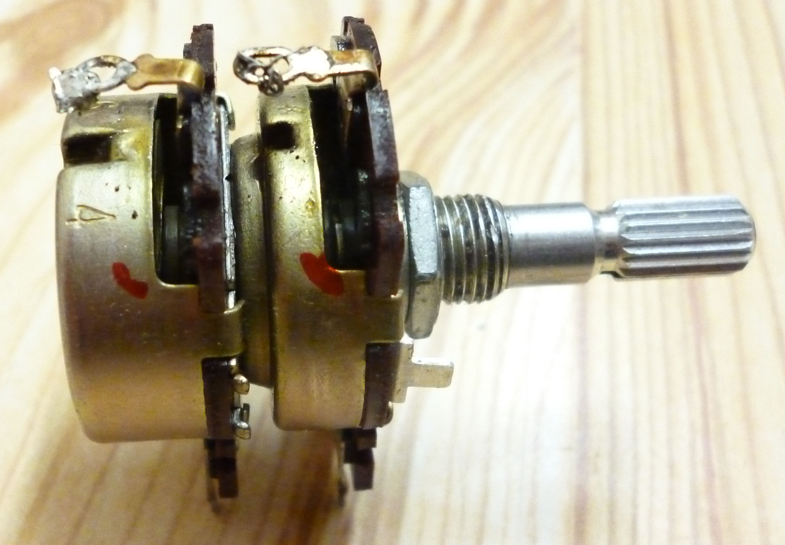

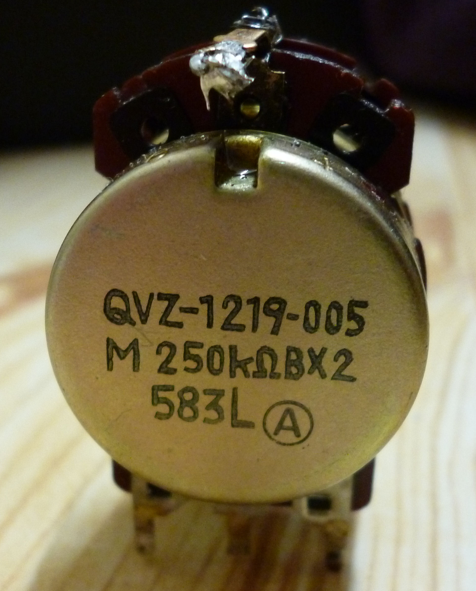

Hi I was just wondering if someone can help with a problem I am having with this amp, it has over time developed a crackling volume control.
I know this is a common fault with amplifiers of this age but I would like too replace the pot if possible, rather that using contact cleaner, off course I’m not very knowledgeable about these things which is why I came here for help. I am just not sure what part to get is there an exact replacement the label on the pot says qvz-1219-005,m250kohmbx2,583L A. If it is not possible too get this part or similar and I have to use contact cleaner which do you recommend? Thank you..

Depending on the internal arrangement it may be possible to fit an Alps Blue.
Can't remember if the original was a special, in which case it is unlikely you'd get another.

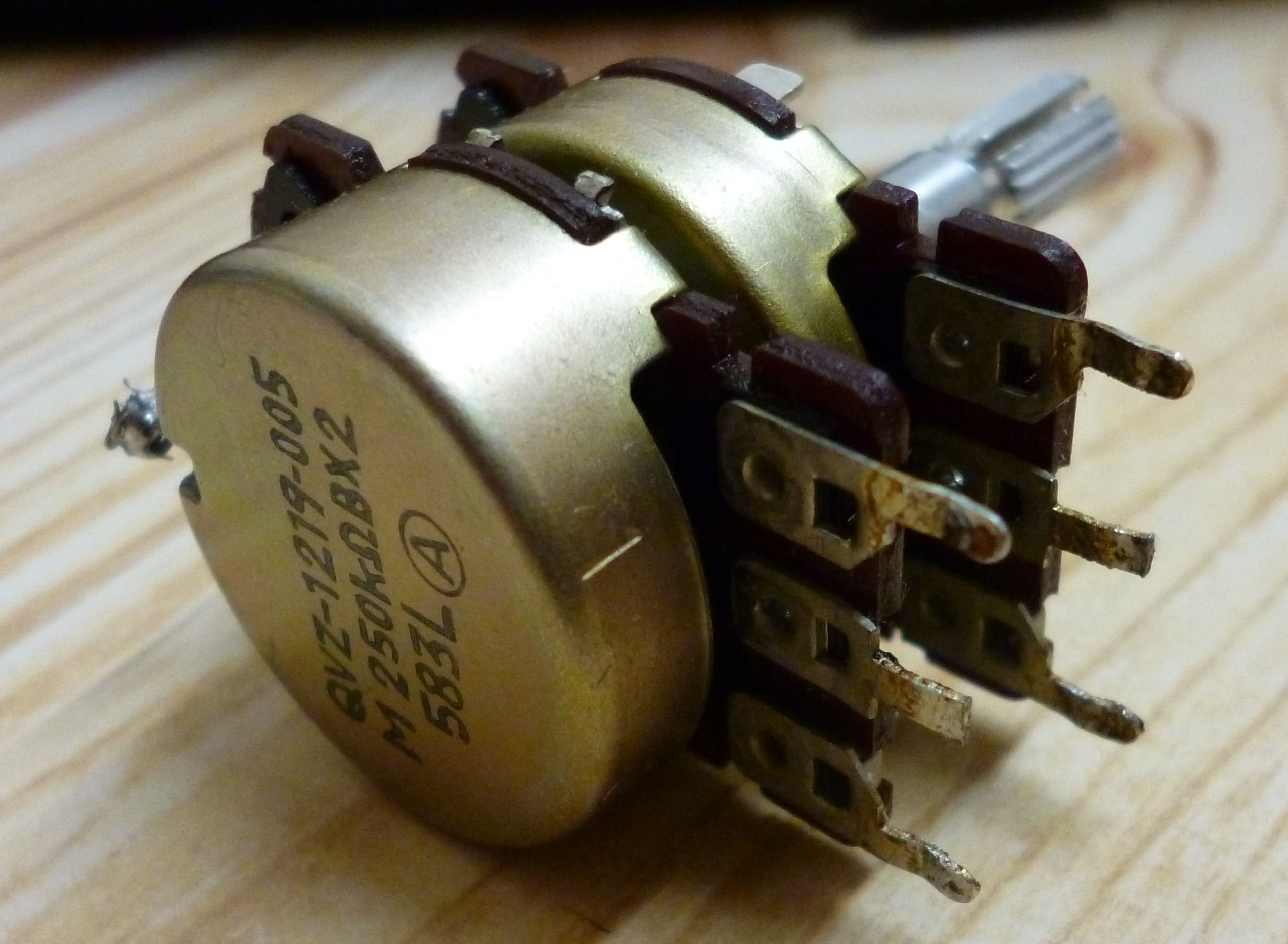

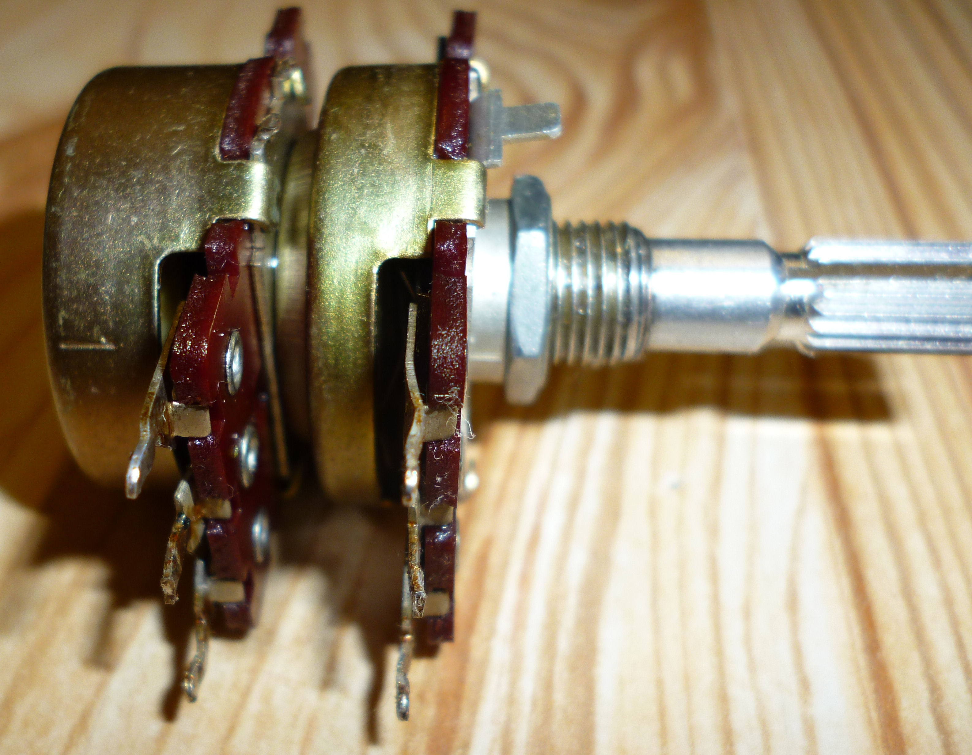

Looking at it again it's a dual pot with six lugs at the bottom and two at the top (one on each barrel) probably for the loudness switch. The bx2 at the end of the number might mean dual, does the B mean linear?
It'll be a log pot, and you're correct with the two extra lugs being for 'loudness'.
Most Alps blues also have the extra pin connections for loudness so you should be Ok there.

Sorry guys i know this is an old thread and it has been a while, but it seems that this volume pot has finally given up the ghost and is causing tons of distortion looking around i can seem to find similar looking pots, but i am still confused as to whether this is logarithmic or linear the b in the name has opposite meaning when it is America to Europe. So what would it mean in Asia. Where i suppose there meaning is the right one. This is the UK version model by the way.
I would like to get fairly close to it having loudness and the same split shaft and size.
Right - all bets are off regarding potentiometer log. law as soon as you deal (as is inevitable for tapped pots) with any Asian manufacturers. As before, it's a log. taper type B and you can buy from a few manufacturers but the most accessible high quality products in 1-off qty will be ALPS and they are available in genuine, fake, 😉 standard or tapped forms if you search thoroughly.

There are also problems with the format of Alps RK27 "Blue velvet" pots. 4 pin tapped pots have all pins in line and you'll need to adapt a lead to this 4th pin and bend it flat to allow the pot to fit the PCB. Like the code suggests, they're 27mm sq. See pic.
Pots like your JVC type are large, 24 mm dia. but they disappeared decades ago, only some specialty parts remaining. 16 mm dia. pots are still made but new products now use even smaller pots.
This Ebay item looks tempting even if it is doubtful, Copy ref. no. to your browser: 130820551892
Beware of shaft lengths and types, they are not adjustable or available in any choice of length for spline types at least.

Have you tried opening the old pot up by bending the tags on each gang ? Nothing to lose now its out. As long as the two halves separate easily you should be able to clean it using a cotton bud on the resistive track and wipers. Use ISO and wash all the old gunk out. Retension the wipers if needed and also bend them a little to one side so they sweep unused track. I've done hundreds of similar single gang pots over the years on TV's and the like. Squirting with cleaner is only a temporary fix at best, open it up and repair it and they are as good as new.
Thanks Ian i looked at that sheet and he does not seem to have the right shaft, neither does that other link the other Alps i have found 221127808523 seems closest to what i need but it has no loudness. How well do these Chinese knock offs work compared to the real thing would it perform better than the original JVC part did when it was new? The shaft on mine 25mm x 6mm. Thanks for helping.
