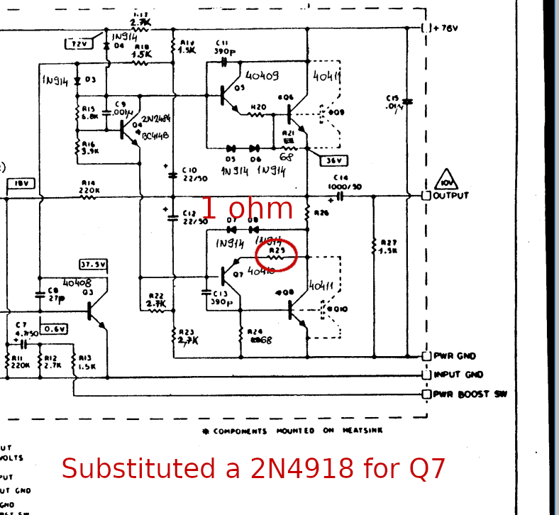

Can I adjust the bias and substitute this driver transistor?
I have a power amp board (old acoustic control corp brand amp) with an old PNP can transistor that's labelled RCA 40410 in the Q7 position. Power wise I believe I have one that will cross (2N4918), but the bias must be off because it's dropping the voltage at the mid point between C10 and C11 (supposed to be 36V) to 14V.
Can I re-bias this stage in order to get the transistor I have on hand to work? It looks like it may have a problem on Q4 if I mess with the bias on Q7. I don't have a great understanding of those two stages unfortunately. Thanks in advance! I'd love to get this old amp working.

There is a difference in the bias between the 40410 and the 2N4918
also big difference in the Ft and 50 volts difference in max. working voltage .
Its not the ideal replacement.
Rail is 76 volts and the 2N4918 is 40 volts maximum whereas the 40410 is 90 volts maximum.

I tried again with a bit of an experiment and I'm getting the correct voltage (36V at the in between output transistors point marked in the schematic) IF I do not have the base of my substituted 2n4918 connected to the circuit. I also measure 36 volts at the wire that feeds the base of the transistor in question (Q7). So I guess it's the transistor being full on at idle causing the voltage drop.
Duncan2: I agree with you on your data, and yes the rail is 76 volts, but there is 36V across the 40V rated transistor in the way the A/B stages are laid out. Not much margin for error there, but I just wanted to try what I had to see if it was worth investing in proper parts for this thing (I absolutely think it will be but I want to make sure it's salvageable). A 40v transistor should survive 36v, or am I overlooking something?
You will need a 76 volt or higher part in there. It may have 36 volts on it in quiescent, but it will swing almost the entire supply voltage. 80 volt or better parts are needed. Something like a BD139/140 pair. ECG128/129 is probably as close as you can get to the originals, but they are very likely to be fakes. If they are fakes, you’ll blow it up. I wouldn’t worry if the fT is lower than the 100 MHz originals, since the 390 pF collector-base capacitors slow them down anyway. 100 MHz is not needed, 10 or 20 will do.
If you use more modern epitaxial outputs, you do want emitter resistors. R26 sort of functions as one, but adding one in the emitter leg of the upper transistor can’t hurt.
If the lower driver transistor is “leaky” due to insufficient voltage handling, you won’t get a DC offset like you’re observing. You’ll get too much quiescent current or just blow the output stage. Something else is causing the “center point” to be at 14 volts instead of 36. Look toward the front end, where DC feedback is applied, to diagnose. The problem may be “off screen” of the partial schematic you show.
And just because a transistor is “rated” at only 40 volts doesn’t necessarily mean that’s all it will take. Especially if they are part of a “family” with increasing voltage ratings. They are sample tested and binned. If too may in the sample don’t pass the spec, they just drop whole lot down to the next bin. You can always select for higher voltage if you need to - just like they did with the 40411. It is nominally a “60 volt” 2N3055. You would want to test Vceo and Iceo *at temperature* when doing so.
You may very well have gotten lucky and had a 4918 that would take 80 volts, or even 100. I’ve had TIP 42’s with no voltage grade letter take the full 100 volts of the “C” part. You MUST test them if you are going to do this.
The 2N4918 is a 40 volt part the 2N4920 is 80 volt. This part should work as it is below the breakdown. It will need to have a heatsink to work.

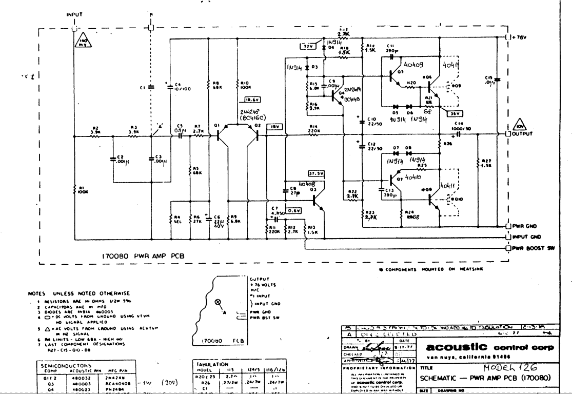

Duke Aguiar, just like the signed schematic.

Here's more of the schematic btw.

Measure the voltage across R26, and see if that’s changing when you connect the driver transistor. And you can try shorting Q4 collector to emitter to intentionally remove output stage bias, and see if the voltage on R26 goes to zero.

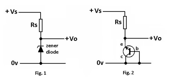

I like the idea of this test. So what I know of zeners is that they'll clamp a voltage (almost like a regulator). If the transistor is acting like a zener, what should I expect to measure across the 100k and the transistor with voltage applied across the two in series? I assume I don't put a voltage on the base of the transistor?
wg_ski
Take a ½ wave ac voltage source (100v peak or ?) with a current limiter (20k or ?) and place a scope E to C (B open) and see the waveform clip & sometimes you may see a burst of oscillation.

So would I tie the base to GND like this?
I don't know exactly what wgski meant in post 10.
I do a Iceo test, that is current with base open. I use 47 kohm & 12 or 24 v. I put ma scale of a dvm between transistor & gnd. NPN plus & 47k go on collector, PNP plus & 47 k go on emitter. Current is microamps, the transistor is good. Current =sourcevoltage/47k, the transistor is leaky.
If you have 55 or 100 v supply you could also do this Iceo test, maybe with 100 k instead of 47. But be careful, 100 v from one hand to the other can stop your heart.
