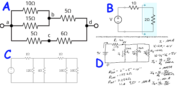

This is where hard-core practice in resistor-network problems is useful. There use to be lesson books full of such problems.
A and C are tough and probably unlikely in amplifiers. (Some bias networks look like A.)
For your purpose, you can probably limit your study to "Parallel Resistors", since your meter probes can get past any series resistor. (And of course, "digital" is no better here.)
B is a very likely circuit. And it hinges on another concept. What is "V"? Perhaps a battery which you disconnect (it would fool your meter). Maybe a wall-power supply and you surely must unplug from the wall. But is the "dead" power source an equivalent resistor? What value?
And some parallel mysteries can't be solved in situ. Two parallel resistors read 100 together. No visible marks. Is it two 200 Ohm parts, a 220 and a 183, a 200 and a 1Meg?

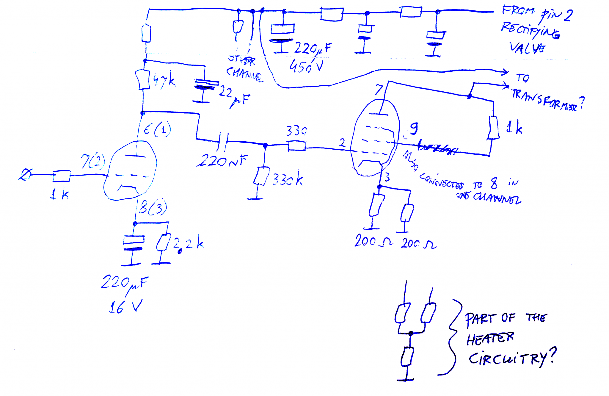

In a tube power amp, the feedback resistors will not measure right, since the output transformer secondary provides a path
around them. Just look at the schematic and see. Of course, wait until the power supply is fully discharged first.

@Yoshimitsu without some pictures, (or better yet an attempt at a schematic) it is very hard to say whether the resistors in question can be measured without removal.

Yoshimitsu sent me some things by PM, the schematic of post #8 has been derived from that. Not all resistor values are filled in.
Ok, thanks. Now I understand.Yoshimitsu sent me some things by PM, the schematic of post #8 has been derived from that. Not all resistor values are filled in.
