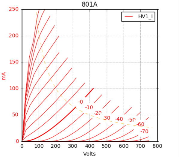

Choosing of operating point depends of method of use.
If you want the tube as power device, must to select such op. point, where the desired power of given loadline within the maximum limits (mainly dissipation), but provide as large as possible power with acceptable distortion.
If you use it as preamplifier, the power demand is negligible, the grid swing is relatively small (only few Volt). The goal is small distortion and manageable output impedance. These are requiring relatively large anode current.
If you see the 801a curves in datasheet, the the optional operating points at about -10V grid curve.
This is measured by L0rdGwyn:
There is enough large optional current range, the anode voltage is manageable, the bias can be produced easily.
If you want to use filament biasing, too large bias voltage not optimal, larger filament bias resistor (due to the 1.25A filament current) dissipation would be enormous.
If you use cathode biasing, the 25...40mA current requiring 250...400R cathode resistor ... and enough large bypass capacitor.
So, for preamplifier at about 300V anode voltage, 30mA anode current, -10V bias can be made easily.

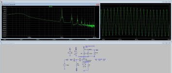

Am I reading the datasheet correctly when it says distortion goes down , with more anode voltage? E.g. distortion at 600v is ~half of what it is at 425v?Choosing of operating point depends of method of use.

Distortion is a mix of factors:
Bias voltage,
Plate voltage,
Plate current,
Plate load impedance,
And lastly, the peak to peak signal voltage to the grid, versus the grid bias voltage.
Also, the gain depends on the plate load impedance, and the operating plate impedance, rp.
At some point of peak to peak signal voltage at the grid . . . the combination of gain, plate voltage, and plate peak to peak swing, there may be a point where [plate] clipping occurs.
And, at some point of peak to peak signal voltage at the grid, given the bias voltage, the grid may draw grid current, or the grid voltage (bias plus peak negative signal voltage), may drive the tube into cut off.
All factors interact.
All things may appear to be simple, until we discover how complex they really are.
I have been studying tubes since 1956, and working with tubes since 1958, and I still make lots of mistakes.
Hang in there, Have Fun!

Do you mean, that R loaded 801a connected to FET splitter?In my case, the load will be a Mosfet phase inverter...so does that make my load line flat/horizontal?
In this case, the FET gate is very large impedance vs. anode resistor, so the loadline almost the R.

No.Am I reading the datasheet correctly when it says distortion goes down , with more anode voltage? E.g. distortion at 600v is ~half of what it is at 425v?
At increasing anode current the plate impedance decreasing, the mutual conductance increasing, so with changeless load the distortion will be lesser (simply more optimal loading).
Well, this is the thing. I like the sound of R loaded. The one CCS i used in the past sounded like "artificially expended". And I also like the sound of choke loaded. I guess for the output swing I need , it will either be CCS or choke...Do you mean, that R loaded 801a connected to FET splitter?
