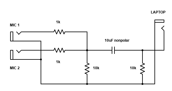

My mum is looking for a mic for her podcast and since I have 2 mono microphones (Uher m534) and she is doing the podcast with a partner I thought
it might be neat to use them together via stereo jack so there is a slight stereo effect. Her laptop only has one mic input so it would be convenient if it worked. Is this possible or will it result in a pop noise , possibly some smoke and followed by silence ?

Sure - join the ground form each mic into one and hook this up to the input ground and then use the + from each mic to go to + left and + right input respectively.
These are Dynamic mics so no power involved.

It is possible, however you will no longer have balanced connection so be sure you have a mic preamp that is stereo and not mono balanced (if it is a balanced mono preamp it will flip polarity of the right channel and then sum both channels together) or that your mics output at line level, and so you should be able to use a line level minijack which are much more commonly set up as a stereo pair. And keep in mind if each intervenant speaks into their mic it will be a heavy stereo effect as each mic is hard panned. From my podcasting experience no stereo at all or a really minuscule amount is best.

It depends on the computer. Many do not have a stereo mic input. The "right channel" contact, the ring is used for DC bias instead, and the tip contact is a mono mic input (L+R). I would use a 35mm to RCA cable and test if both channels connect, to find out how your computer is wired. Also possible is 4 wire 35mm jack but that is usually used with headphone jacks, ie mic, ground, right, left.
If the laptop mic input is mono, which is likely, there's no stereo effect with two mics.
Since your mics are cardioid, you could use them both into a simple mixer, which then connects to the laptop,
so each person has their own mic.
Ditto what was said above. Laptops usually don't have stereo mic inputs, just mono. You could wire the two mics together into that mono input, but you won't have any individual control. And the mic input on a laptop normally has 2.5V DC on it, to power the mic. Your dynamic mics won't like that.

This should work for your two identical dynamic mics. A small plastic or metal box would be ok.

Some laptops auto detect an external mic based on its resistance.
That may be why the mic jack is DC coupled.

Hi, thanks for the schematic, all parts are available in my electronics workshop aka kitchen🙂
