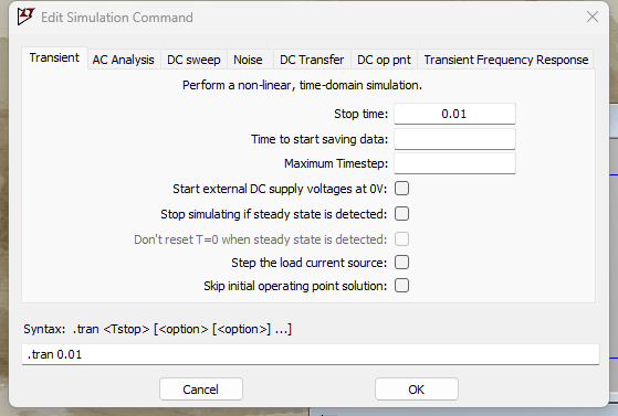

You need to set the simulation up as a time-domain one. Which is a '.tran' or transient one. If you're getting a frequency response perhaps you have it set to '.ac' ?I tried but i get the response in frequency not in time
10mS should be sufficient time to see a crossover's impulse response.

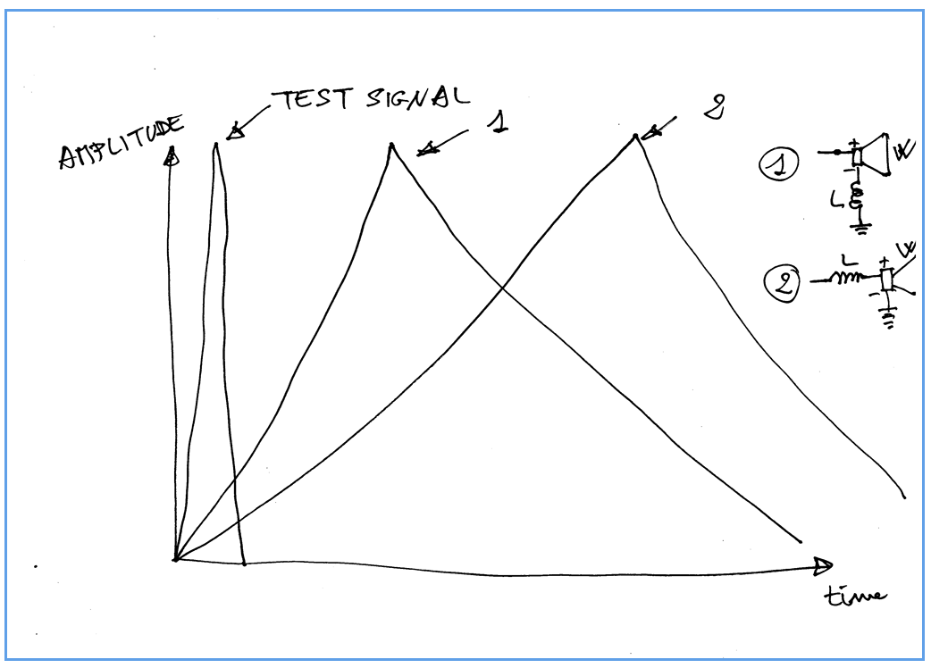

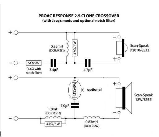

Hi ! back again after Mc Donald ... this is what i want to check in the end
if case 1 and 2 overlap completely then I really throw in the towel because I have no possibility of understanding the physical phenomena
Seriously will the coil introduce some kind of delay in the response or not ?

the signal source is a impulse generator
case 1 is woofer followed by a coil to ground
case 2 is a coil placed before the woofer
The basic question is what kind of impact has an inductor on a impulse ?
or considering a square wave again does an inductor warp a square wave ?
my guess is that it does and usually it is found where it does more harm i.e. in series to a woofer
I read that an inductance by its nature opposes the variation of current that passes through it
This is a very bad thing for a woofer to the point that some are looking for woofers that can work without a filter like full-range ones.
However, there is at least one brand that places the inductance after the woofer (the direction is from + to -)
Everyone says it's ******** That nothing changes before or after the woofer I can't accept it I'm talking about the positive half-wave which in the end is what really matters

There should be no difference in the impulse responses of the woofer followed by a coil or the woofer preceded by a coil. The acoustical frequency responses of the woofer for these two cases are identical.
Of course, in this situation, the coil must "warp" the square wave, as it adds what is essentially a low-pass filter response into the system. It doesn't matter where the coil is located (preceding or following the woofer).

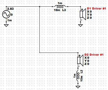

Below are the two circuit conditions modelled in VituixCAD.
In the plot below, the frequency response (black line) is the summation of drivers D1 and D2, which are pure 8-ohm resistive loads and each of them has a simulated flat response between 5 Hz and 40 kHz. The D1 and D2 responses are identical, and the summed response is the expected 6.0 dB greater than that of either driver alone.

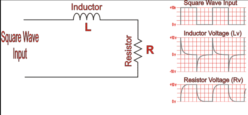

See this difference for instance (unfortunately capacitor response is missing but for sure it will be much better than an inductor)
the resistor gives back a very good SW so it is not critical
Again there must be difference in the rise time if the woofer is fed through an inductor or a straight wire
We can say that an inductor will slow down the signal ?
An inductor placed instead between the - of the woofer and ground could even be good to shorten the settling time of the driver (damping)

It will likely be helpful if you look up Kirchhoff’s Current Law. The two different circuit layouts all result in the same current flowing through each section of the circuit. If the same current is flowing, then the voltages across the two loudspeakers will also be identical, as V = I x Z, irrespective of whether or not the inductor precedes the loudspeaker.
Witwald is absolutely right, but maybe it helps when looking from a different angle.
The voltage source sees a speaker and inductance impedance, so a current I will flow.
Let the speaker and the inductance change positions.
The overall impedance will still be the same, so the same current I will flow as before.
A voicecoil in a speaker will react to a current according to F=BIL where F is the force on voice coil, B is the strength of the magnetic field, I is the current from the voltage source and L is the length of the voice coil winding.
Do you see a voltage in F=BIL, no there is not.
So, since the current is the same regardless of inductance before or after the speaker, the speaker will react exactly the same in both cases.

Let me try to understand There is a Vac generator (the amp) and the load (the woofer)
When the signal is positive (half wave above 0) it pushes the woofer cone out
when it is negative (half wave below 0) it pulls the cone inside ?
when the signal is positive the flow is from + to -
when it is negative the flow is to - to + ?
i would like then to ask ProAc why they used to wire their crossover differently Just to be original ? i mean for no particular technical reason ?
If anyone would do the same ok But ProAc made me thinking
i do not understand well If i place a 1.5V battery across the + and - of a woofer the cone moves back or forth in relation to polarity
But again i would need to see and hear I will try to make a test asap is just a matter of swap terminals on a biwirable speaker I should have one
I will connect the red of the tweeter with the black of the woofer and send the red of the amp to the black of the woofer
Hearing is believing
